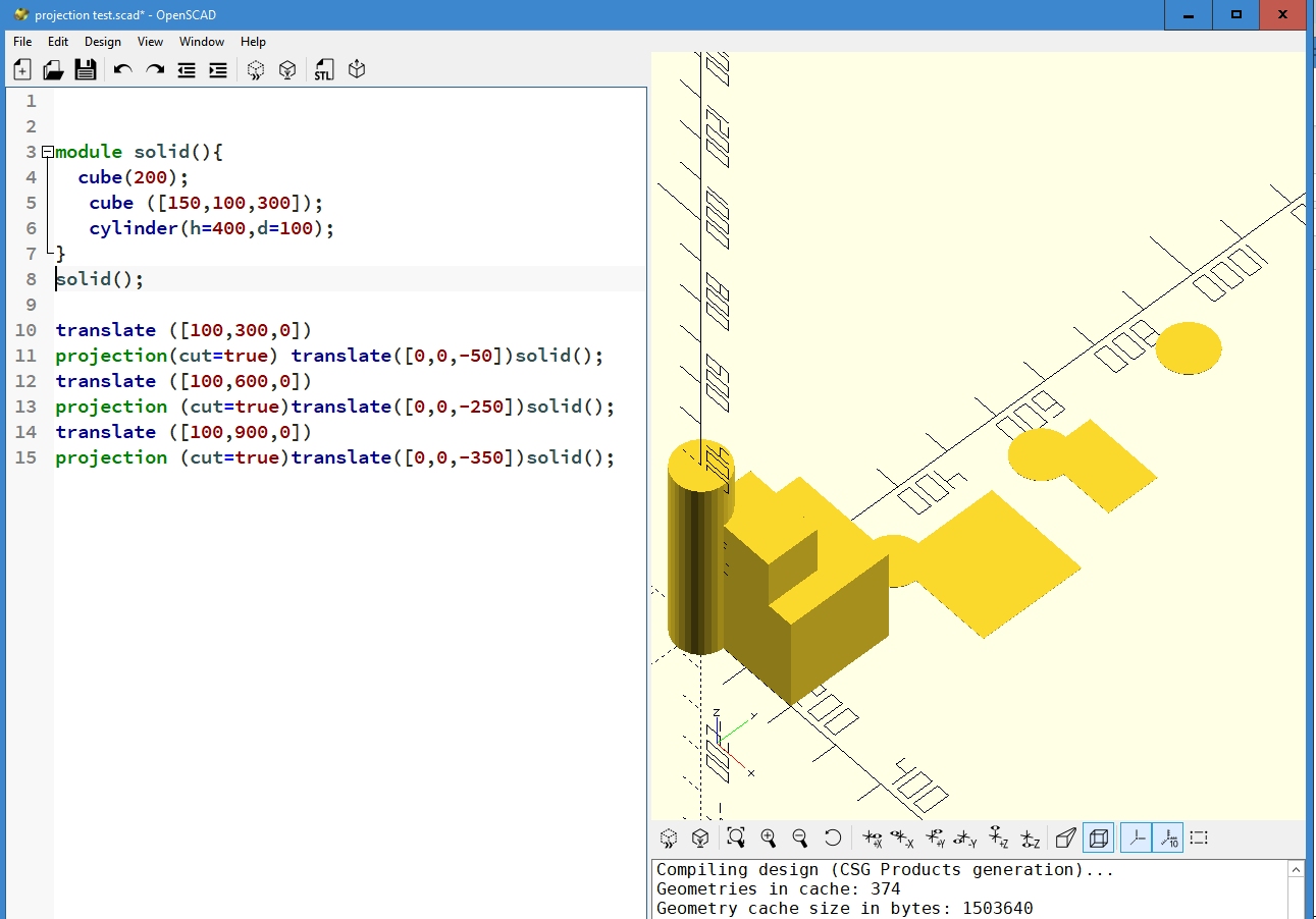

example to demonstrate my problem.
The slightly modified  code
module solid(){
  cube(200);
   cube ([150,100,300]);
   cylinder(h=400,d=100);
//solid();
   translate ([100,300,0])
       projection(cut=true) translate([0,0,-50])solid();
  translate ([100,600,0])
      projection (cut=true)translate([0,0,-250])solid();
  translate ([100,900,0])
     projection (cut=true)translate([0,0,-350])solid();

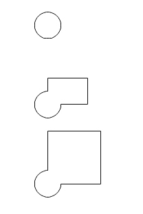

produces the following  dxf image

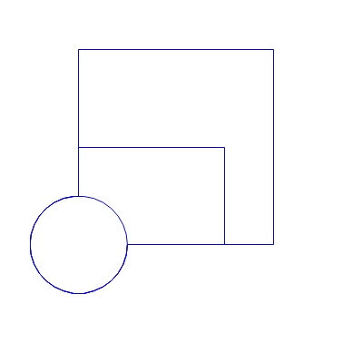

Whereas what I need is the shapes 'stacked' on top of each other, like this.
In openscad the 2d shapes are 'filled in', so you do not get the
separate outlines, and this stacked result is not possible within
openscad itself, afaik. I have to manually move the components in the
translated dxf file to align them, using another cad program.
Is it possible in openscad, perhaps using some command line
options/whatever, to export the dxf file, with each projection located
in the correct position, superimposed on top of each other, without
having to translate and rearrange in an external program? It becomes
tedious for more than a few projections.

Nope.  But you could more or less straightforwardly wrap a shell script
around a command line, passing -D settings in to tell the OpenSCAD
program which shape to generate and storing the results in separate DXF
files.
Just as in 3D, the shapes are unioned and their original identity is lost.

Right, you do that, but then you wrap it in a shell script that uses the
CLI and -D to set the mode and control the output name.

 Initially I translated in x/y so that the dxf's were separated (since
openscad treats them as planes, not lines, and if you 'stack them' in
openscad, you lose the individual boundaries). I then thought that
separate files would be better, with no x/y translation. My 2.5d cnc
software will mill the boundaries, or pocket, to fixed depths for
selected 2d dxf lines, I have to manually select the lines, set the
depth, etc. It is probably easier/quicker to combine the g-code files
from individual dxf files, compared to offsetting the dxf's to the
origin within the cnc software.
 module solid(){
   cube(200);
 //solid();
 like this.
 the translated dxf file to align them, using another cad program.
 located in the correct position, superimposed on top of each
 other, without having to translate and rearrange in an external
 program? It becomes tedious for more than a few projections.
