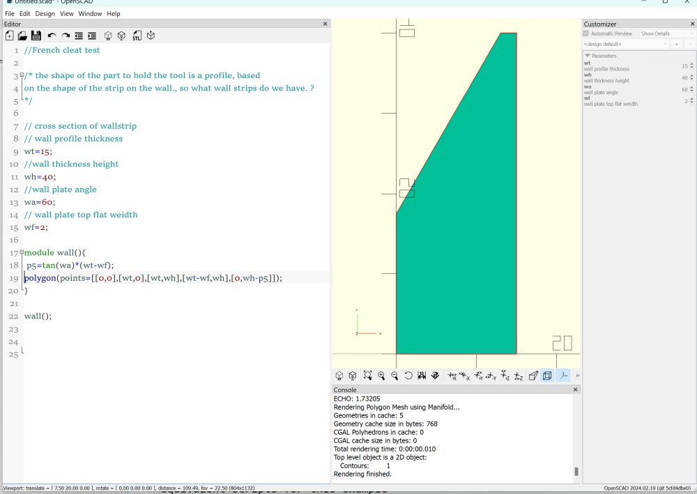

Hi John,
I'm not sure why you seem to be making this so complicated.
The French cleat is all about profiles, so start with 2d. Generally the
wall strips are made first, so here is a parametric wall plate profile.
Simple for the user to change to whatever size you want, using the
customizer. Note that I have included a 'flat' at the top. If you are
routing the profile of the fittings, then that flat will be
approximately the diameter of the router bit, the kerf of the tool used
to cut the mating fittings - else the fittings will not slide down
snugly onto the cleat. Of course, you do not need a flat, but there are
advantages to at least rounding off the top edge. If left pointed, then
you will need to adjust the mating profile in the real world. You can
use offset to get the profile of the fitting, with a negative delta
value for the radius of router to get the shape around the pointy top. I
am not restricting this in any way to the type of materials, method of
construction of the parts, etc. Do not make decisions before you need
to, no need for BOS2L .
This guy - https://www.youtube.com/watch?v=usFRvasGW70 makes his living
from supplying wooden French cleats to Woodworkers!
By initially dealing with profiles, the thickness of the fittings, what
they do, the method of creating the actual parts can be separately
considered afterwards, in other modules.
The next step would be to generate the mating part, allowing for
tolerances, and the ability to 'hook over'. Then add on whatever the
fitting needs, (brackets, holes, etc). You will not be able to generate
a working fitting, by simply differencing the profile.
I've also attached the  code snippet to generate the illustrated profile.
Best wishes,
Ray
