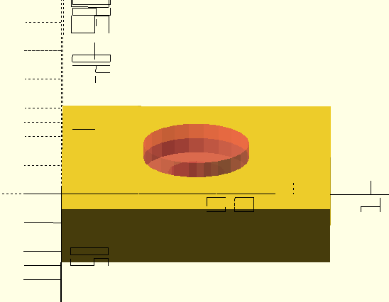

Hello OpenSCAD,
  // camera tripod anchor
// Bob Roos
// January 11, 2023
include <BOSL2/std.scad> // or screws or threading
include <BOSL2/screws.scad> // or screws or threading
H = 9.5;
W = 34.75;
L = 36;
L1 = 25.5;
A = 45;
Wedge = (L-L1)/2;
wedge([W,Wedge,H]);
fwd(L1)wedge([W,Wedge,H],spin=180,anchor=[1,-1,-1]);
diff()
cuboid([W,L1,H],anchor=[-1,1,-1])
     # rotate([180,0,0]) screw_hole("1/4-20",length=H,head="hex");

Ummm...  The screw HOLE must be cylindrical to allow the screw head to spin
while the screw is being inserted?

Hi Leonard,
It actually was a hex  in the beginning and somehow got changed and never came back to hex.
I need it to be hex because it is capturing the head to prevent turning.

What I do, then, is create a screw and subtract that from the base object:
diff()
rotate([180,0,0])
scale( [1.01, 1.01, 1 ] )
#screw("1/4-20",length=H,head="hex");

The screw_hole() module creates a counterbored hole so that you can inset
the screw.  Using screw() instead of screw_hole() would be one workaround,
though you might need to manually oversize the hole.  I'm not sure if
there's a better solution.  Adding an option to screw_hole() to do what you
want might be a possibility, but the hex head is the only head type for
which is would change anything, so I'm not sure that makes sense.
Note: you might be interested in
https://github.com/revarbat/BOSL2/wiki/tripod_mounts.scad

Hi Adrian,
Yes, that is exactly what I wanted but I can't seem to get the hold to appear in the F6 render. I realized that I did need the screw to turn so I have switched to flat head.
// Bob Roos
// January 11, 2023
include <BOSL2/tripod_mounts.scad>
H = 10.5;
diff()
manfrotto_rc2_plate();
    # tag("remove")rotate([180,0,0]) screw_hole("1/4-20",length=H,head="flat");

The semicolon after the mount module means the screw is not a child so the
diff does not apply to it.  Remove the semicolon.  Add braces if that makes
things more clear.

The semicolon after the mount module means the screw is not a child so the diff does not apply to it. Remove the semicolon. Add braces if that makes things more clear. On Fri, Jan 13, 2023, 10:12 Bob Roos <roosbob@wybatap.com> wrote: > Hi Adrian, > > > Yes, that is exactly what I wanted but I can't seem to get the hold to > appear in the F6 render. I realized that I did need the screw to turn so I > have switched to flat head. > > > > // camera tripod anchor > > // Bob Roos > > // January 11, 2023 > > > > include <BOSL2/std.scad> // or screws or threading > > include <BOSL2/tripod_mounts.scad> > > include <BOSL2/screws.scad> // or screws or threading > > > > H = 10.5; > > diff() > > manfrotto_rc2_plate(); > > # tag("remove")rotate([180,0,0]) > screw_hole("1/4-20",length=H,head="flat"); > > > > > Thursday, January 12, 2023, 4:01:00 PM, you wrote: > > The screw_hole() module creates a counterbored hole so that you can inset > the screw. Using screw() instead of screw_hole() would be one workaround, > though you might need to manually oversize the hole. I'm not sure if > there's a better solution. Adding an option to screw_hole() to do what you > want might be a possibility, but the hex head is the only head type for > which is would change anything, so I'm not sure that makes sense. > > Note: you might be interested in > > https://github.com/revarbat/BOSL2/wiki/tripod_mounts.scad > > > > On Thu, Jan 12, 2023 at 3:09 PM Leonard Martin Struttmann < > lenstruttmann@gmail.com> wrote: > >> What I do, then, is create a screw and subtract that from the base object: >> >> diff() >> >> { >> >> cuboid([W,L1,H],anchor=[-1,1,-1]) >> >> rotate([180,0,0]) >> >> scale( [1.01, 1.01, 1 ] ) >> >> #screw("1/4-20",length=H,head="hex"); >> >> } >> >> >> >> >> On Thu, Jan 12, 2023 at 2:02 PM Bob Roos <roosbob@wybatap.com> wrote: >> >>> Hi Leonard, >>> >>> >>> It actually was a hex in the beginning and somehow got changed and >>> never came back to hex. >>> >>> >>> >>> I need it to be hex because it is capturing the head to prevent turning. >>> >>> >>> Thursday, January 12, 2023, 11:01:09 AM, you wrote: >>> >>> Ummm... The screw HOLE must be cylindrical to allow the screw head to >>> spin while the screw is being inserted? >>> >>> On Thu, Jan 12, 2023 at 9:50 AM Bob Roos <roosbob@wybatap.com> wrote: >>> >>>> Hello OpenSCAD, >>>> >>>> >>>> // camera tripod anchor >>>> >>>> // Bob Roos >>>> >>>> // January 11, 2023 >>>> >>>> >>>> include <BOSL2/std.scad> // or screws or threading >>>> >>>> include <BOSL2/screws.scad> // or screws or threading >>>> >>>> >>>> H = 9.5; >>>> >>>> W = 34.75; >>>> >>>> L = 36; >>>> >>>> L1 = 25.5; >>>> >>>> A = 45; >>>> >>>> Wedge = (L-L1)/2; >>>> >>>> >>>> wedge([W,Wedge,H]); >>>> >>>> fwd(L1)wedge([W,Wedge,H],spin=180,anchor=[1,-1,-1]); >>>> >>>> >>>> diff() >>>> >>>> cuboid([W,L1,H],anchor=[-1,1,-1]) >>>> >>>> # rotate([180,0,0]) screw_hole("1/4-20",length=H,head="hex"); >>>> >>>> >>>> >>>> -- >>>> Best regards, >>>> Bob mailto:roosbob@wybatap.com >>>> <roosbob@wybatap.com> >>>> _______________________________________________ >>>> OpenSCAD mailing list >>>> To unsubscribe send an email to discuss-leave@lists.openscad.org >>>> >>> >>> -- >>> have Fun, >>> Bob mailto:roosbob@wybatap.com >>> <roosbob@wybatap.com> >>> _______________________________________________ >>> OpenSCAD mailing list >>> To unsubscribe send an email to discuss-leave@lists.openscad.org >>> >> _______________________________________________ >> OpenSCAD mailing list >> To unsubscribe send an email to discuss-leave@lists.openscad.org >> > > -- > have Fun, > Bob mailto:roosbob@wybatap.com > <roosbob@wybatap.com> > _______________________________________________ > OpenSCAD mailing list > To unsubscribe send an email to discuss-leave@lists.openscad.org >
