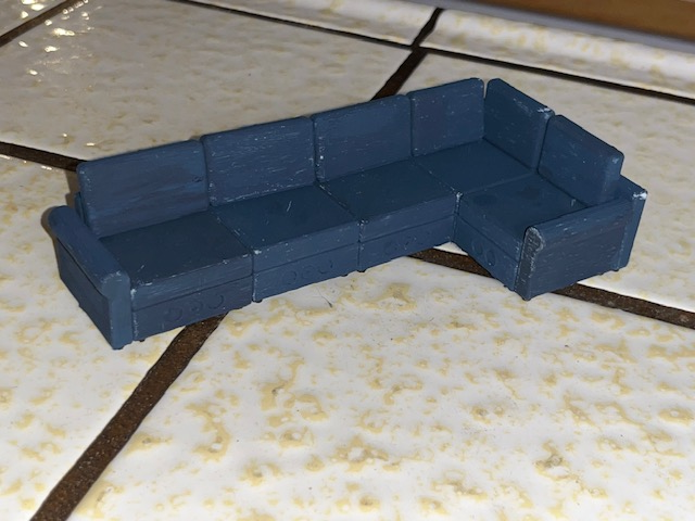

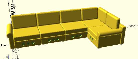

We bought a Lovesac sofa https://www.lovesac.com/sactionals, and of
course I needed to model it for my house model, and of course since the
real thing is modular and rearrangeable I had to make the model be
rearrangeable too, both inside OpenSCAD and when printed.
The small circles at the bases are for gluing in magnets so that the
physical model is rearrangeable.
(Yes, I need to touch up the paint.)
The physical model is rearrangeable because the parts have magnets.  The
OpenSCAD view is rearrangeable because all of the parts are attachable
using BOSL2 attachments.
Here's the source for that layout:
include <Lovesac.scad>
stdRollSide() {
    attach("F", "LB") seat() {
        attach("B", "F") stdAngledSide()
            attach("P", "P") stdPillow();
        attach("RF", "LF") seat() {
                        attach("P", "PL") deepPillow();
                    attach("RB", "F") stdSide()
                        attach("P", "PR") deepPillow();
                    attach("F", "B") seat() {
                        attach("RF", "F") stdSide()
                        attach("F", "F") stdRollSide();
