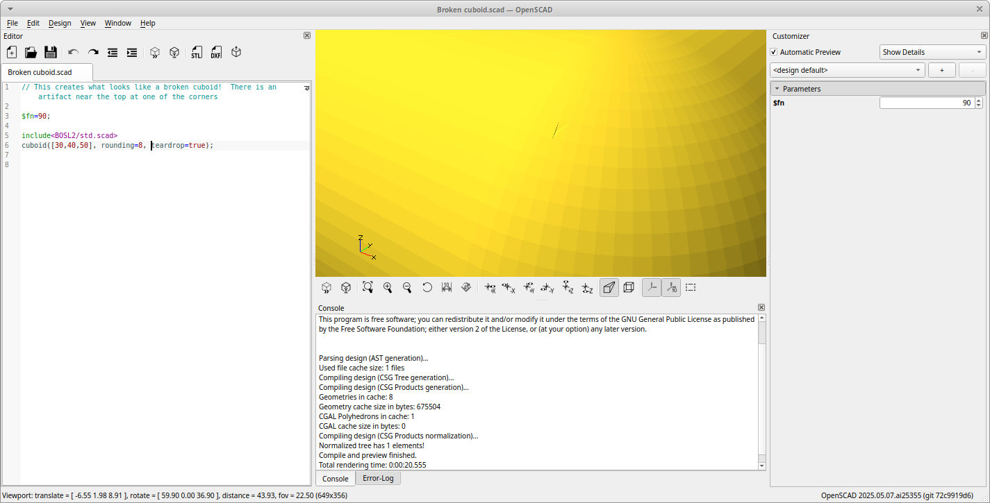

I just saw an interesting thing in the BOSL2 cuboid; the code I used was
$fn=90; include<BOSL2/std.scad> cuboid([30,40,50], rounding=8,
teardrop=true);
and a screenshot of the result is attached. There is an artifact on one
of the corners, relatively near the top.
The code uses the most recent BOSL2 code from GitHub.  This doesn't
appear in 2021.01 but in both 2025.04.11 and 2025.05.07.ai25355.
Changing from Manifold to CGAL in the latter seems to remove the artifact.
/hs

There's been no followup to this question.  Is it a bug in manifold?

I don't see the artifact, but the console does show:
Compiling design (CSG Products generation)...WARNING: [manifold] Minkowski
failed with error, falling back to Nef operation: CGAL ERROR: assertion
violation!Expr: e_below != SHalfedge_handle()File:
/Users/distiller/libraries/install/include/CGAL/Nef_3/SNC_FM_decorator.hLine:
418
Geometries in cache: 8
Geometry cache size in bytes: 675504
CGAL Polyhedrons in cache: 1
CGAL cache size in bytes: 0
Normalized tree has 1 elements!
Compile and preview finished.
Total rendering time: 0:00:24.598

Bosl2 creates the cuboid as huge Set of triangles for a polyhedron Nested
in dozens of groups btw.
