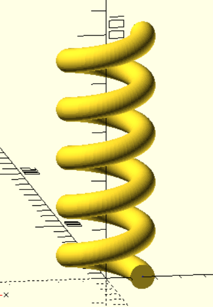

Everybody knows that you can't generate a helix with linear_extrude.
Linear extrude works with horizontal cross sections, and a proper helix
needs a circle (or whatever shape) that's tilted to perpendicular to the
angle of the helix.  You end up with something like so:

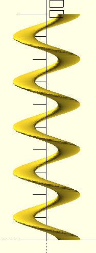

Some time back, I realized that you could generate a helix with linear
extrude.  The problem is that the horizontal cross-section isn't
simple.  It's sort of banana-shaped:
But what is that shape?

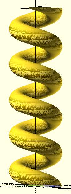

I got interested in this question again, and played with the idea that
it's a circle that's been stretched around the circumference of the helix.
I tried translating it into polar coordinates and scaling theta by
1/sin(helix angle), and although I'm not sure that it's absolutely
right, the result is pretty good:
Here's a cross-section perpendicular to the helix angle:
Perfect circle?  Maybe, maybe not.  I'm not sure that I cut the
cross-section at exactly the right point, or took the screen shot from
the right angle.

function everything would be an argument, not a global.)
// Vertical distance from the centerline of one turn to the centerline of the next turn
pitch = 20;
// Radius of the helix, from XY=0 to the centerline of the extruded circle
helix_r = 15;
// Radius of the extruded circle
r = 5;
// Height of the helix
h = 100;
// Show cross-section (view from -Y orthogonal)
intersect = false;
// Which algorithm to use (a is best, b is interesting but not as good, 2 is simple circle)
algorithm = 0;  // [ 0: a, 1: b, 2: circle ]
module stop();
// This is a little interesting to animate:
// pitch = 20 + 10abs($t2-1);
function torect2(p) = [
p[0] * cos(p[1]),
p[0] * sin(p[1])
function topolar2(p) = [
norm(p),
atan2(p.y, p.x)
// Helix angle
helix_a = atan2(pitch, helix_r2PI);
// degrees per unit, along the circumference
theta_scale = 360/(2PIhelix_r);
// Banana, algorithm A
bananaA = function() [
for (a=[0:359])
torect2([helix_r, 0] + [r*cos(a), r * sin(a) * theta_scale / sin(helix_a)])
// Banana, algorithm B
bananaB = function() [
for (a=[0:359])
let(circ = torect2([r, a]))        // circle
let(tcirc = circ + [helix_r, 0])    // translated
let(pcirc = topolar2(tcirc))        // in polar coords
let(smeared_circ = [pcirc[0], pcirc[1]/sin(helix_a)])
torect2(smeared_circ)
// Simple circle, for comparison
circle = function() [
for (a=[0:359])
torect2([r, a]) + [helix_r, 0]
functions = [ bananaA, bananaB, circle ];
module helix() {
linear_extrude(height=h, twist=360*h/pitch, convexity=2)
polygon(functionsalgorithm);
if (intersect) {
#helix();
translate([helix_r, 0, pitch]) rotate([-helix_a,0,0]) cube([r2, 0.01, r2], center=true);
} else {
helix();
// A few reference shapes
// A circle.  If helix_a is 90, this should match the bottom of the helix.
color("blue") translate([helix_r,0,-0.1]) linear_extrude(height=0.1) circle(r=r);
// The circumference of the helix.
color("green") translate([0,0,-0.2]) linear_extrude(height=0.1) difference() { circle(r=helix_r+0.1); circle(r=helix_r-0.1); }
