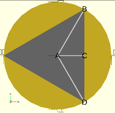

I've made a panel and printed it to hold an aliexpress 6 volt solar
cell. This after a mailbox remote alarm dissolved a couple of AA
Durocells in 2 months. Messy cleanup.
Its a hair short of the cell length but that is the max of my printer
bed diagonally. This holder is 71.5mm wide. And it should tilt the cell
so its roughly broadside to the sun at local noon, when glued to the
back of a plastic picket fence rail. I want it inside the yard, semi out
of site as I'll bury the cable to power the gizmo on the inside of the
mailbox door.
A cylinder with an $fn=3; is the nominal tilt, giving a triangle. then
hollow it for 1mm walls and maybe 10% infill with another cylinder
inside it but 2mm shorter and 2mm smaller d.
what is my cylinders d= to get 72mm wide outer walls?

I asked chatgpt
c = (2**72*) / sqrt(3);
cylinder(d=c,h=20, $fn=3);

Tue, May 23, 2023 9:37 AM
I added the *  * around the 72 for bold to show where you'd put in your
variable.
(It works - I tested it..)

Final time.. Then I give up.
c = (2*72) / sqrt(3);
Replace the 72 with whatever you want for the length.

Final time.. Then I give up. c = (2*72) / sqrt(3); cylinder(d=c,h=20, $fn=3); Replace the 72 with whatever you want for the length. I'm not going to highlight it in bold because that adds extra stars. On Tue, 23 May 2023 at 11:00, gene heskett <gheskett@shentel.net> wrote: > On 5/23/23 04:44, Rob Ward wrote: > > In other words Gene, don't feel to bad, if you have mastered even the > basics of openSCAD you have achieved more than your junior high school > would have even be able to imagine. I congratulate you !!!!! > > Cheers, RobW > > > Actually, the main reason I quit school was that I was well ahead of > what they were teaching in the late 1940's. I quit school and went to > work fixing the then newfangled things we call tv's today. I tested at > 147 on the Iowa version of the IQ test in '47. I wired the house my > father built us right after WW-II. Tried to join in the middle of korea > by having my number moved up, but got 4F'd by my score of 98 on the > AFQT, next best score of around 135 boys that took it that day was 36, > passed a 1st phone test in '62 w/o cracking a book, and in '72, passed > the CET test at 123 out of 125 w/o cracking a book. Most EE's will fail > that test. Switched to broadcasting after getting the 1st phone, and > spent my last 18 years working as the Chief (& usually only) Engineer at > WDTV-5. Now 88 & long retired, getting rusty. > > I've not had that great a luck with the fairer sex, I've now outlived 3 > women, and the 3 children the first one gave me. And the last one died > of COPD 2+ years back. So I'm alone, my own chief cook and bottle > washer. The place is paid off for 25 years now. > > And this stuff keeps me out of the bars. ;o)> << smiley with beard. > > Now, if somebody would translate that chatgpt thing into something > OpenSCAD can understand, I'd be obliged. > > Take care & stay well everybody. > > Cheers, Gene Heskett. > -- > "There are four boxes to be used in defense of liberty: > soap, ballot, jury, and ammo. Please use in that order." > -Ed Howdershelt (Author, 1940) > If we desire respect for the law, we must first make the law respectable. > - Louis D. Brandeis > Genes Web page <http://geneslinuxbox.net:6309/> > _______________________________________________ > OpenSCAD mailing list > To unsubscribe send an email to discuss-leave@lists.openscad.org >
Tue, May 23, 2023 4:43 PM
Works, thank you. But Cura has too #%&$ many knobs and switches. I just
spent 6 hours cuz it wouldn't do any infill, when another file loaded
and got infill like it was instructed. Even tried 2 more Cura updates,
finally discovering that somewhere in the last couple months the "make
overhangs printable" had gotten turned off. My clue was the first one
I built, using the above code, collapsed in on itself as it cooled.
So what s/b a good one is making now. With some infill.
Take care & stay well.

If I understand correctly, you are asking for the "diameter" of a
triangle with sides 72 units.  Right?
First, to be clear, the diameter here is the diameter of the circle that
encloses the triangle.
Consider this diagram:
Here's a one-paragraph introduction to trigonometry:
The basic trigonometric functions are defined for a right triangle
(a triangle with one angle 90°).  (In this diagram, we're going to
work with the triangle ABC.)
They are functions of one of the two other angles. (Either BAC or
ABC in the diagram above, but we're going to concentrate on BAC.)
The hypotenuse is the long side, the one opposite the 90° angle.
(AB in the diagram.)
The adjacent side is the side that connects to the angle that you're
working with, that isn't the hypotenuse.  (For angle BAC, this is AC.)
The opposite side is the side that *doesn't* connect to the angle
that you're working with.  (For angle BAC, this is BC.)
The sine of an angle is the length of the opposite side divided by
the length of the hypotenuse.  (The sine of BAC is BC/AB.)
The cosine is the adjacent side divided by the hypotenuse. (The
cosine of BAC is AC/AB.)
The tangent is opposite divided by adjacent. (The tangent of BAC is
BC/AC.)
The "arc" functions (arcsine, arccosine, arctangent) take the ratio
as an argument, and return the angle.
Now we can do your math.
(Values below to three significant figures.)
You want the side BD to be 72 units.
BC is half of that, 36 units.
The angle BAD is one third of a circle, 120°.
The angle BAC is one sixth of a circle, 60°.
sin(BAC) = BC/AB
sin(BAC)AB = BC  (multiply both sides by AB)
AB = BC/sin(BAC)  (divide both sides by sin(BAC))
AB = 36 / sin(60)  (substitute in the actual values of BC and BAC)
AB = 36 / 0.866  (value of sin(60) from the sin() function)
AB = 41.6 = radius of the circle
2
41.6 = 83.2 = diameter of the circle
