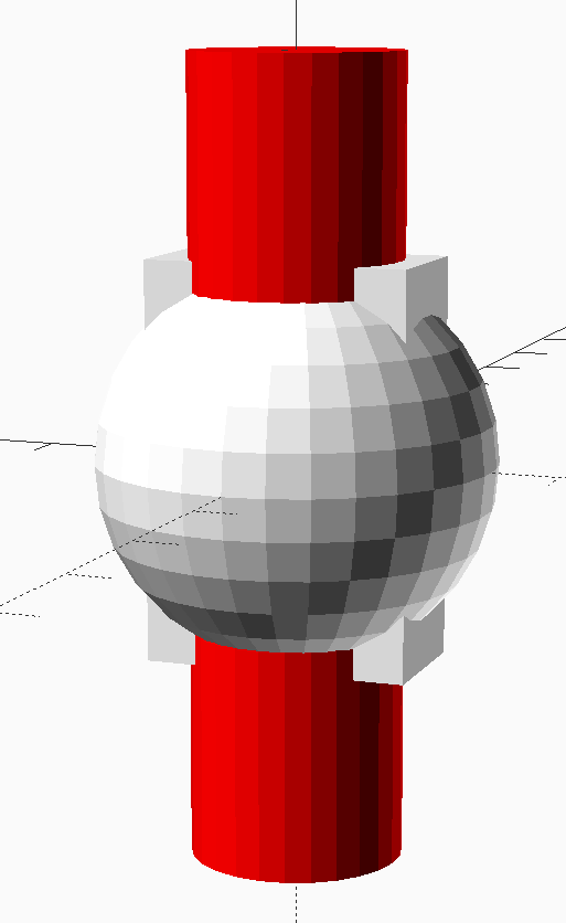

It's taken me a while to boil this down to simple example code, but here
it is.
module Part1 () {
color ("red")
union () {
cube ([10, 20, 30], center=true);
cylinder (r=8, h=60, center=true);
module Part2 () {
color ("white")
difference () {
sphere (r=15);
rotate ([0, 0, 0]) cube ([10, 20, 30], center=true); // Rotate
me and see what happens to colours!
Part1 ();
Part2 ();
Part1 is a union of a cube(oid) and a cylinder. It's red.
Part2 is a sphere with a cuboid removed. It's white.
When the two cubiods are (close to) incident, the colour of Part2
"bleeds" into Part 1. This means that my complex objects that do a lot
of adding and subtracting of common underlying elements can't be coloured.
Known issue? Open bug? Me being stupid?

Hmmm, this might be this issue.
https://github.com/openscad/openscad/issues/1000
Sadly, adding render() in various places gives me a 5 minute preview
time on my model even with just 5% of it being drawn and at low
"resolution".
