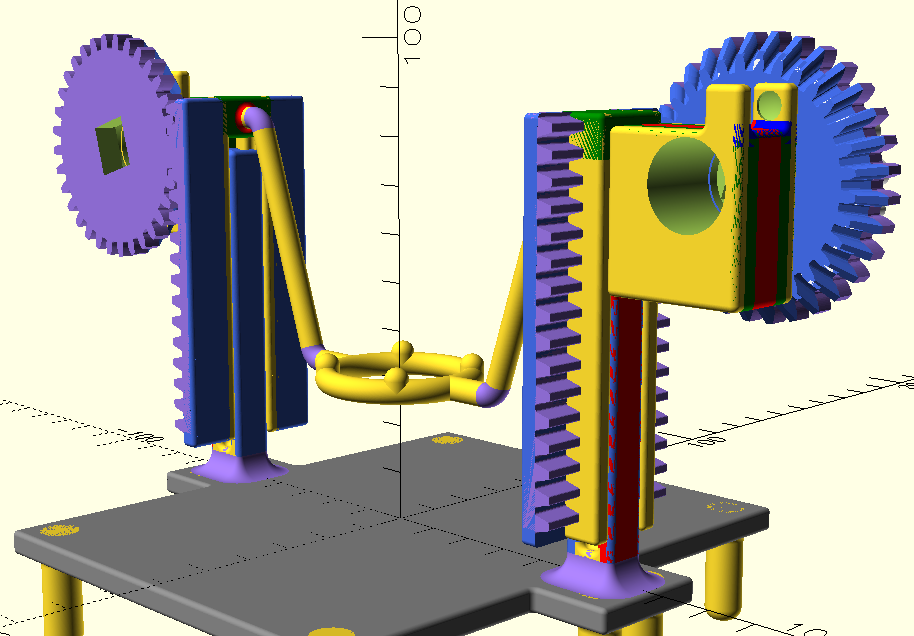

The basic summary of what I am doing involves 1 rack gear, 1 spur gear,
and 2 bevel gears. The spur gear interacts with the rack gear, and the spur
gears interact with each other. The spur & one of the bevel will be
attached to each other (so it will basically be half spur, half bevel), and
I want them to have the same radius/diameter, but I need the bevel gear to
not interfere with the interaction between the spur & rack gears.

I don't understand your design, Nathan. Can you post a picture of some sort that would clarify how the gears are arranged? If you showed a picture with the non-working bevel gear in the model that would work, for example. It doesn't sound like the bevel gear and spur gear interact from your description. On Mon, Oct 27, 2025 at 1:24 PM Nathan Sokalski via Discuss < discuss@lists.openscad.org> wrote: > The basic summary of what I am doing involves 1 rack gear, 1 spur gear, > and 2 bevel gears. The spur gear interacts with the rack gear, and the spur > gears interact with each other. The spur & one of the bevel will be > attached to each other (so it will basically be half spur, half bevel), and > I want them to have the same radius/diameter, but I need the bevel gear to > not interfere with the interaction between the spur & rack gears. > > Nathan Sokalski > njsokalski@hotmail.com > ------------------------------ > *From:* Adrian Mariano via Discuss <discuss@lists.openscad.org> > *Sent:* Monday, October 27, 2025 10:24 AM > *To:* OpenSCAD general discussion Mailing-list <discuss@lists.openscad.org > > > *Cc:* Adrian Mariano <avm4@cornell.edu> > *Subject:* [OpenSCAD] Re: Creating a Bevel Gear with Straight Teeth > > BOSL2 can create mating bevel gears as well. > > On Mon, Oct 27, 2025 at 09:44 Leonard Martin Struttmann via Discuss < > discuss@lists.openscad.org> wrote: > > I also recommend looking at https://github.com/dpellegr/PolyGear > > Len > > On Mon, Oct 27, 2025 at 7:04 AM Roger Whiteley via Discuss < > discuss@lists.openscad.org> wrote: > > Nathan, > > Why not use a pair of bevel gears? > > There's another gear library which will do this, here, > http://www.thingiverse.com/thing:3575, Greg's library is also > referenced in another OpenSCAD library source, but I can't remember > where right now. > > This library has some good examples to created meshing pairs, I've been > using gears made this way for six years. > > It is also fairly easy to modify and get gears that will mesh together > and work if you print them, but you might have to get creative to print > a pinion [the small one] with an outside face that is not scarred by > support, you might also have to go back to OpenSCAD v2019.05 to get > usable exports as STL's, I've been having issues with later versions, > sadly that means you have to put up with glacial CSG rendering not > Manifold, which is lightning quick. > > A pair of gears should have the same cone distance and outside circular > pitch, even if the number of teeth is different. > > Drop me a line if you need a bit more help. > > Roger. > _______________________________________________ > OpenSCAD mailing list > To unsubscribe send an email to discuss-leave@lists.openscad.org > > _______________________________________________ > OpenSCAD mailing list > To unsubscribe send an email to discuss-leave@lists.openscad.org > > _______________________________________________ > OpenSCAD mailing list > To unsubscribe send an email to discuss-leave@lists.openscad.org >

Here is a screenshot of what I have (some parts removed to make the important parts visible):
[cid:c72296d1-559e-4112-ba99-87c2817e87f1]
The purple part is the spur gear, and the blue part is the [should be] bevel gear. The blue is not really a bevel gear, it is just the linear_extrude of a spur_gear2d, so the involute stuff is not accurate. A second bevel (or what will be a bevel) gear will go below the existing bevel gear to create a vertical axle. My ultimate goal is to synchronize the spur gears by, after creating the vertical axles, adding a horizontal axle below the table. I have considered using an alternative approach of cutting out a cylinder from the center of the spur gear and placing a bevel gear inside, but it still involves the same number & type of gears in a similar arrangement, but at least placing it inside would prevent the bevel gear from interfering with the spur/rack interaction.

Here is a screenshot of what I have (some parts removed to make the important parts visible): [cid:c72296d1-559e-4112-ba99-87c2817e87f1] The purple part is the spur gear, and the blue part is the [should be] bevel gear. The blue is not really a bevel gear, it is just the linear_extrude of a spur_gear2d, so the involute stuff is not accurate. A second bevel (or what will be a bevel) gear will go below the existing bevel gear to create a vertical axle. My ultimate goal is to synchronize the spur gears by, after creating the vertical axles, adding a horizontal axle below the table. I have considered using an alternative approach of cutting out a cylinder from the center of the spur gear and placing a bevel gear inside, but it still involves the same number & type of gears in a similar arrangement, but at least placing it inside would prevent the bevel gear from interfering with the spur/rack interaction. Nathan Sokalski njsokalski@hotmail.com<mailto:njsokalski@hotmail.com> ________________________________ From: Adrian Mariano via Discuss <discuss@lists.openscad.org> Sent: Monday, October 27, 2025 8:59 PM To: OpenSCAD general discussion Mailing-list <discuss@lists.openscad.org> Cc: Adrian Mariano <avm4@cornell.edu> Subject: [OpenSCAD] Re: Creating a Bevel Gear with Straight Teeth I don't understand your design, Nathan. Can you post a picture of some sort that would clarify how the gears are arranged? If you showed a picture with the non-working bevel gear in the model that would work, for example. It doesn't sound like the bevel gear and spur gear interact from your description. On Mon, Oct 27, 2025 at 1:24 PM Nathan Sokalski via Discuss <discuss@lists.openscad.org<mailto:discuss@lists.openscad.org>> wrote: The basic summary of what I am doing involves 1 rack gear, 1 spur gear, and 2 bevel gears. The spur gear interacts with the rack gear, and the spur gears interact with each other. The spur & one of the bevel will be attached to each other (so it will basically be half spur, half bevel), and I want them to have the same radius/diameter, but I need the bevel gear to not interfere with the interaction between the spur & rack gears. Nathan Sokalski njsokalski@hotmail.com<mailto:njsokalski@hotmail.com> ________________________________ From: Adrian Mariano via Discuss <discuss@lists.openscad.org<mailto:discuss@lists.openscad.org>> Sent: Monday, October 27, 2025 10:24 AM To: OpenSCAD general discussion Mailing-list <discuss@lists.openscad.org<mailto:discuss@lists.openscad.org>> Cc: Adrian Mariano <avm4@cornell.edu<mailto:avm4@cornell.edu>> Subject: [OpenSCAD] Re: Creating a Bevel Gear with Straight Teeth BOSL2 can create mating bevel gears as well. On Mon, Oct 27, 2025 at 09:44 Leonard Martin Struttmann via Discuss <discuss@lists.openscad.org<mailto:discuss@lists.openscad.org>> wrote: I also recommend looking at https://github.com/dpellegr/PolyGear Len On Mon, Oct 27, 2025 at 7:04 AM Roger Whiteley via Discuss <discuss@lists.openscad.org<mailto:discuss@lists.openscad.org>> wrote: Nathan, Why not use a pair of bevel gears? There's another gear library which will do this, here, http://www.thingiverse.com/thing:3575, Greg's library is also referenced in another OpenSCAD library source, but I can't remember where right now. This library has some good examples to created meshing pairs, I've been using gears made this way for six years. It is also fairly easy to modify and get gears that will mesh together and work if you print them, but you might have to get creative to print a pinion [the small one] with an outside face that is not scarred by support, you might also have to go back to OpenSCAD v2019.05 to get usable exports as STL's, I've been having issues with later versions, sadly that means you have to put up with glacial CSG rendering not Manifold, which is lightning quick. A pair of gears should have the same cone distance and outside circular pitch, even if the number of teeth is different. Drop me a line if you need a bit more help. Roger. _______________________________________________ OpenSCAD mailing list To unsubscribe send an email to discuss-leave@lists.openscad.org<mailto:discuss-leave@lists.openscad.org> _______________________________________________ OpenSCAD mailing list To unsubscribe send an email to discuss-leave@lists.openscad.org<mailto:discuss-leave@lists.openscad.org> _______________________________________________ OpenSCAD mailing list To unsubscribe send an email to discuss-leave@lists.openscad.org<mailto:discuss-leave@lists.openscad.org>
Tue, Oct 28, 2025 5:27 PM

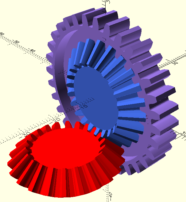

As I said before you can’t mate a bevel gear to a spur gear. And you can’t
mate it to a rack either. Have you read the quick intro to gears at the top
of gears.scad?  If not you might find it helpful.
I think the idea of a spur gear that shares the shaft with the bevel gear
is a reasonable approach. I am not sure if there is a reason this doesn’t
work for you.  At least in theory you could use helical spur gears. At 45
deg helical angle they can mate at 90 deg and give you a vertical axis
while also mating with a rack with 45 deg angled teeth.  This extreme
design probably has issues of some kind.
I also wonder if a worm and worm gear might help with your design. You
might want to find something other than BOSL2 for worm gears because right
now there are issues I don’t know how to fix. I can’t find anything
anywhere about the proper way to construct a worm gear.  The BOSL2
implementation has tiny interference in the mesh.
On Tue, Oct 28, 2025 at 11:51 Nathan Sokalski via Discuss <

I was never trying to mate a bevel gear to a spur gear, here is what I have considered as another idea: [cid:2f86c0d4-e358-4869-8b30-f938156fe93f] The purple gear (a spur gear with the center cut out) is what interacts with the rack, the blue bevel gear is attached to (uses the same axle as) the purple spur gear (but they do not interact with each other). The red bevel gear is what will be attached to the vertical axle. Some of the things I am unsure about for this approach is how to flatten the sides (the top/bottom) of the bevel gears and how to determine the appropriate parameters for bevel_gear to get an appropriate size/radius. Nathan Sokalski njsokalski@hotmail.com<mailto:njsokalski@hotmail.com> ________________________________ From: Adrian Mariano via Discuss <discuss@lists.openscad.org> Sent: Tuesday, October 28, 2025 1:27 PM To: OpenSCAD general discussion Mailing-list <discuss@lists.openscad.org> Cc: Adrian Mariano <avm4@cornell.edu> Subject: [OpenSCAD] Re: Creating a Bevel Gear with Straight Teeth As I said before you can’t mate a bevel gear to a spur gear. And you can’t mate it to a rack either. Have you read the quick intro to gears at the top of gears.scad? If not you might find it helpful. I think the idea of a spur gear that shares the shaft with the bevel gear is a reasonable approach. I am not sure if there is a reason this doesn’t work for you. At least in theory you could use helical spur gears. At 45 deg helical angle they can mate at 90 deg and give you a vertical axis while also mating with a rack with 45 deg angled teeth. This extreme design probably has issues of some kind. I also wonder if a worm and worm gear might help with your design. You might want to find something other than BOSL2 for worm gears because right now there are issues I don’t know how to fix. I can’t find anything anywhere about the proper way to construct a worm gear. The BOSL2 implementation has tiny interference in the mesh. On Tue, Oct 28, 2025 at 11:51 Nathan Sokalski via Discuss <discuss@lists.openscad.org<mailto:discuss@lists.openscad.org>> wrote: Here is a screenshot of what I have (some parts removed to make the important parts visible): [cid:ii_19a2bd23fe9ea654a7f1] The purple part is the spur gear, and the blue part is the [should be] bevel gear. The blue is not really a bevel gear, it is just the linear_extrude of a spur_gear2d, so the involute stuff is not accurate. A second bevel (or what will be a bevel) gear will go below the existing bevel gear to create a vertical axle. My ultimate goal is to synchronize the spur gears by, after creating the vertical axles, adding a horizontal axle below the table. I have considered using an alternative approach of cutting out a cylinder from the center of the spur gear and placing a bevel gear inside, but it still involves the same number & type of gears in a similar arrangement, but at least placing it inside would prevent the bevel gear from interfering with the spur/rack interaction. Nathan Sokalski njsokalski@hotmail.com<mailto:njsokalski@hotmail.com> ________________________________ From: Adrian Mariano via Discuss <discuss@lists.openscad.org<mailto:discuss@lists.openscad.org>> Sent: Monday, October 27, 2025 8:59 PM To: OpenSCAD general discussion Mailing-list <discuss@lists.openscad.org<mailto:discuss@lists.openscad.org>> Cc: Adrian Mariano <avm4@cornell.edu<mailto:avm4@cornell.edu>> Subject: [OpenSCAD] Re: Creating a Bevel Gear with Straight Teeth I don't understand your design, Nathan. Can you post a picture of some sort that would clarify how the gears are arranged? If you showed a picture with the non-working bevel gear in the model that would work, for example. It doesn't sound like the bevel gear and spur gear interact from your description. On Mon, Oct 27, 2025 at 1:24 PM Nathan Sokalski via Discuss <discuss@lists.openscad.org<mailto:discuss@lists.openscad.org>> wrote: The basic summary of what I am doing involves 1 rack gear, 1 spur gear, and 2 bevel gears. The spur gear interacts with the rack gear, and the spur gears interact with each other. The spur & one of the bevel will be attached to each other (so it will basically be half spur, half bevel), and I want them to have the same radius/diameter, but I need the bevel gear to not interfere with the interaction between the spur & rack gears. Nathan Sokalski njsokalski@hotmail.com<mailto:njsokalski@hotmail.com> ________________________________ From: Adrian Mariano via Discuss <discuss@lists.openscad.org<mailto:discuss@lists.openscad.org>> Sent: Monday, October 27, 2025 10:24 AM To: OpenSCAD general discussion Mailing-list <discuss@lists.openscad.org<mailto:discuss@lists.openscad.org>> Cc: Adrian Mariano <avm4@cornell.edu<mailto:avm4@cornell.edu>> Subject: [OpenSCAD] Re: Creating a Bevel Gear with Straight Teeth BOSL2 can create mating bevel gears as well. On Mon, Oct 27, 2025 at 09:44 Leonard Martin Struttmann via Discuss <discuss@lists.openscad.org<mailto:discuss@lists.openscad.org>> wrote: I also recommend looking at https://github.com/dpellegr/PolyGear Len On Mon, Oct 27, 2025 at 7:04 AM Roger Whiteley via Discuss <discuss@lists.openscad.org<mailto:discuss@lists.openscad.org>> wrote: Nathan, Why not use a pair of bevel gears? There's another gear library which will do this, here, http://www.thingiverse.com/thing:3575, Greg's library is also referenced in another OpenSCAD library source, but I can't remember where right now. This library has some good examples to created meshing pairs, I've been using gears made this way for six years. It is also fairly easy to modify and get gears that will mesh together and work if you print them, but you might have to get creative to print a pinion [the small one] with an outside face that is not scarred by support, you might also have to go back to OpenSCAD v2019.05 to get usable exports as STL's, I've been having issues with later versions, sadly that means you have to put up with glacial CSG rendering not Manifold, which is lightning quick. A pair of gears should have the same cone distance and outside circular pitch, even if the number of teeth is different. Drop me a line if you need a bit more help. Roger. _______________________________________________ OpenSCAD mailing list To unsubscribe send an email to discuss-leave@lists.openscad.org<mailto:discuss-leave@lists.openscad.org> _______________________________________________ OpenSCAD mailing list To unsubscribe send an email to discuss-leave@lists.openscad.org<mailto:discuss-leave@lists.openscad.org> _______________________________________________ OpenSCAD mailing list To unsubscribe send an email to discuss-leave@lists.openscad.org<mailto:discuss-leave@lists.openscad.org> _______________________________________________ OpenSCAD mailing list To unsubscribe send an email to discuss-leave@lists.openscad.org<mailto:discuss-leave@lists.openscad.org>
Tue, Oct 28, 2025 11:59 PM
Quoting from the gears introduction section that I suggested you read we
find:
The size of the teeth can be specified as the circular pitch, which is
the tooth width, or more precisely, the distance along the pitch circle
from the start of one tooth to the start of the text tooth. The circular
pitch can be computed as PI*d/teeth where d is the diameter of the pitch
circle and teeth is the number of teeth on the gear. This simply divides up
the pitch circle into the specified number of teeth. However, the customary
way to specify metric gears is using the module, the ratio of the diameter
of the gear to the number of teeth: m=d/teeth.
After you read this passage it should be fairly obvious how to get a
desired radius, at least approximately (because the pitch circle is not the
outer diameter).  Doing better than that will probably require trial and
error fiddling.
Regarding "flattening the top and bottom" do you mean intersecting the gear
with a cylinder?  Why does it need to be flattened?
I'm still not sure I understand what you're trying to do and what the
challenge is.  Why can't you just stack the gears.  Is it because that
takes up too much space?  Are you wanting to stack the gears in such a way
that the teeth line up?  Just pick the same number of teeth and the gears
and the same module and the gears will have the same diameter and the teeth
will have the same spacing.
I'm a little uncertain why you prefer a bevel gear with straight teeth,
which the gear literature appears to suggest is a configuration with no
advantages.
On Tue, Oct 28, 2025 at 6:46 PM Nathan Sokalski via Discuss <
Nathan Sokalski
On Tue, Oct 28, 2025 at 11:51 Nathan Sokalski via Discuss <discuss@lists.openscad.orgmailto:discuss@lists.openscad.org> wrote:
[cid:ii_19a2d367a2dcb971f161]
On Mon, Oct 27, 2025 at 1:24 PM Nathan Sokalski via Discuss <discuss@lists.openscad.orgmailto:discuss@lists.openscad.org> wrote:
