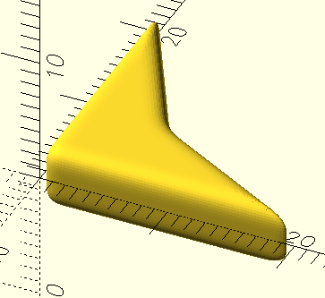

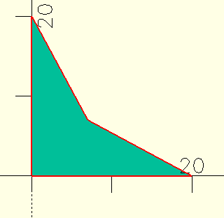

You want a more-or-less simple vertical extrusion, with round corners,
right?
So, given a shape like so:
you want something that looks like so:
Right?
rounded_prism() is your tool.  It has a few more options for generating
different extrusions, but it fundamentally connects a polygon at the
bottom with a polygon with the same number of faces at the top, with
optional rounding.
If you want some other kind of extrusion, sweeping along a path, it's
not your tool.
https://github.com/BelfrySCAD/BOSL2/wiki/rounding.scad#functionmodule-rounded_prism

You want a more-or-less simple vertical extrusion, with round corners, right? So, given a shape like so: you want something that looks like so: Right? rounded_prism() is your tool.  It has a few more options for generating different extrusions, but it fundamentally connects a polygon at the bottom with a polygon with the same number of faces at the top, with optional rounding. If you want some *other* kind of extrusion, sweeping along a path, it's not your tool. https://github.com/BelfrySCAD/BOSL2/wiki/rounding.scad#functionmodule-rounded_prism include <BOSL2/std.scad> points = [ [0,0], [20,0], [7,7], [0,20], ]; polygon(points); right(25) rounded_prism(points, height=5, joint_top=2, joint_bot=2, joint_sides=2);
Wed, Oct 14, 2026 8:24 AM
corners, right?
Yes that's about right.
Right?
Yes, I need a flat bottom, but I can definitely manage that. I will be
putting this on a low cylinder, which can eat the rounded bottom
Sounds good!
it's not your tool.
I was looking at something that looked like it extruded a star with a
rounded top. That was what I could not do with my path.
Thanks for the pointer!
points = [
    [0,0],
    [20,0],
    [7,7],
    [0,20],
polygon(points);
right(25)
joint_sides=2);

appears long.  The rounded_prism() module is good when you have a polygon
with a few edges, like 10, say.  When you have a more continuous path it's
better to use offset_sweep because rounded_prism will make hundreds of tiny
roundings between every single pair of line segments in your path.  It also
looks like your code has an error that's making it think joint_bot is a
function, but I don't see your code here.

Note that rounded_prism() is not well suited to rounding shapes that
have already been rounded, or that have many points. It works best
when the top and bottom are polygons with well-defined corners. When
the polygons have been rounded already, further rounding generates
tiny bezier patches patches that can more easily interfere, giving
rise to an invalid polyhedron. It's also slow because you get bezier
patches for every corner in the model.
You do have a lot of points.  You could try dramatically reducing the
number of points.
