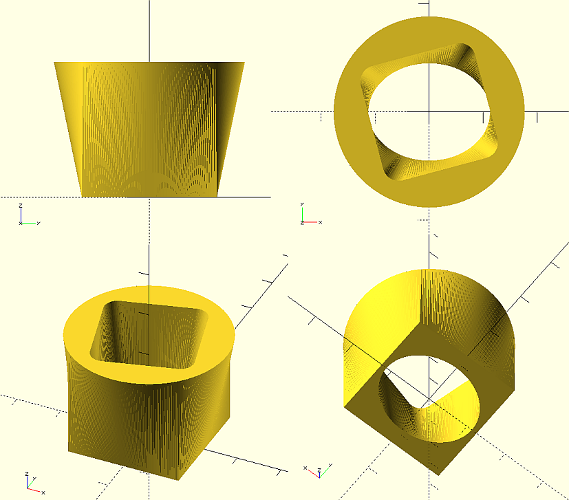

Although not quite the same as general sweep, I have been playing with a
related (unreleased/experimental) feature in my AngelScript application.
It might provide some inspiration for OpenSCAD:
The general idea I had was to allow "extruding" from one general profile
(bottom) to another (top), where both of the profiles may themselves be
results of 2d boolean operations and possibly include holes. I'm not
sure what a proper name for this feature is, but for lack of a better
idea I call it "transform_extrude" for now. Here is a complete working
example:
// AngelScript CSG.
const double pi = 4.0atan(1.0);
double to_rad(double deg) { return pi
deg/180.0; } // to radians from
degrees
shape@ main_shape()
double ro = 12.5;
double ri = 0.9*ro;
shape2d@ bot_hole = scale(sx:1,sy:0.8)*circle(r:ri);
shape2d@ top_hole = rotate_z(to_rad(deg:15))
offset2d(sh:square(risqrt(2),center:true),r:3);
shape2d@ bot = difference2d(square(2ro,center:true),bot_hole) ;
shape2d@ top = difference2d(circle(ro
sqrt(2)),top_hole);
return transform_extrude(bottom:bot,top:translate(0,0,2*ro)*top);
void main()
shape@ obj = main_shape();
obj.write_xcsg(GetOutputFullPath('.xcsg'),secant_tolerance:0.001);
As you see, the bottom profile is a square with an elliptic hole, and
the top profile is a circle with a z-rotated square hole with filleted
corners. The final body is "transform_extrude"d from the bottom to the
translated top profile. It is possible to rotate either of the profiles
so they are no longer parallel planes in 3d, but it isn't done here. See
attached image of the result displayed with OpenSCAD.
Perhaps you want to consider similar things in OpenSCAD. It is perhaps
conceivable to extend this line of thought towards general sweep.
