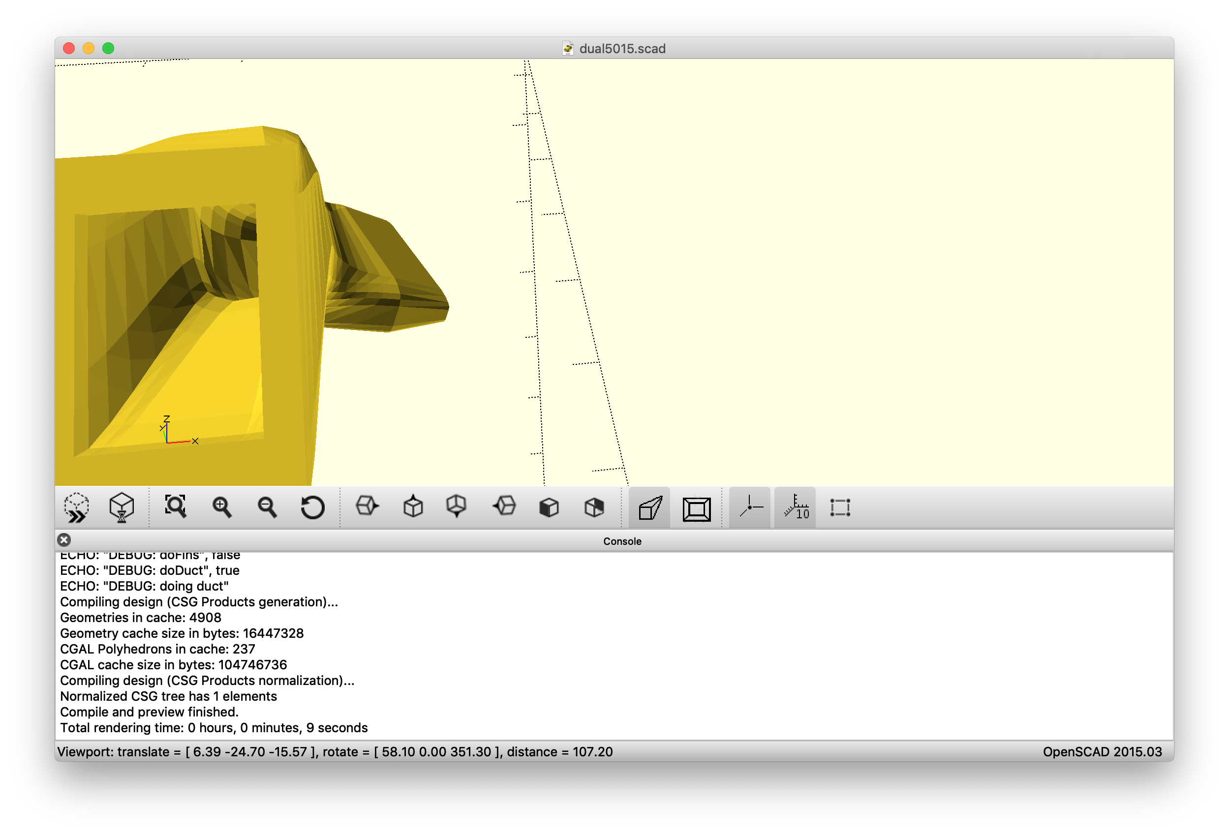

Due to issues I have had with CGAL generated shapes forming
non-manifold STL files, making them difficult to import into other
tools, I have been focusing on doing as much of my design as possible
in userspace, generating 3D polyhedrons. This has been a lot of work
due to limited support in the codebase, particularly as I am limited
to running in the 2015 version. It would definitely be nice to have
some 3d union, difference, and intersection functions for polyhedrons,
but up until now I have been making do.

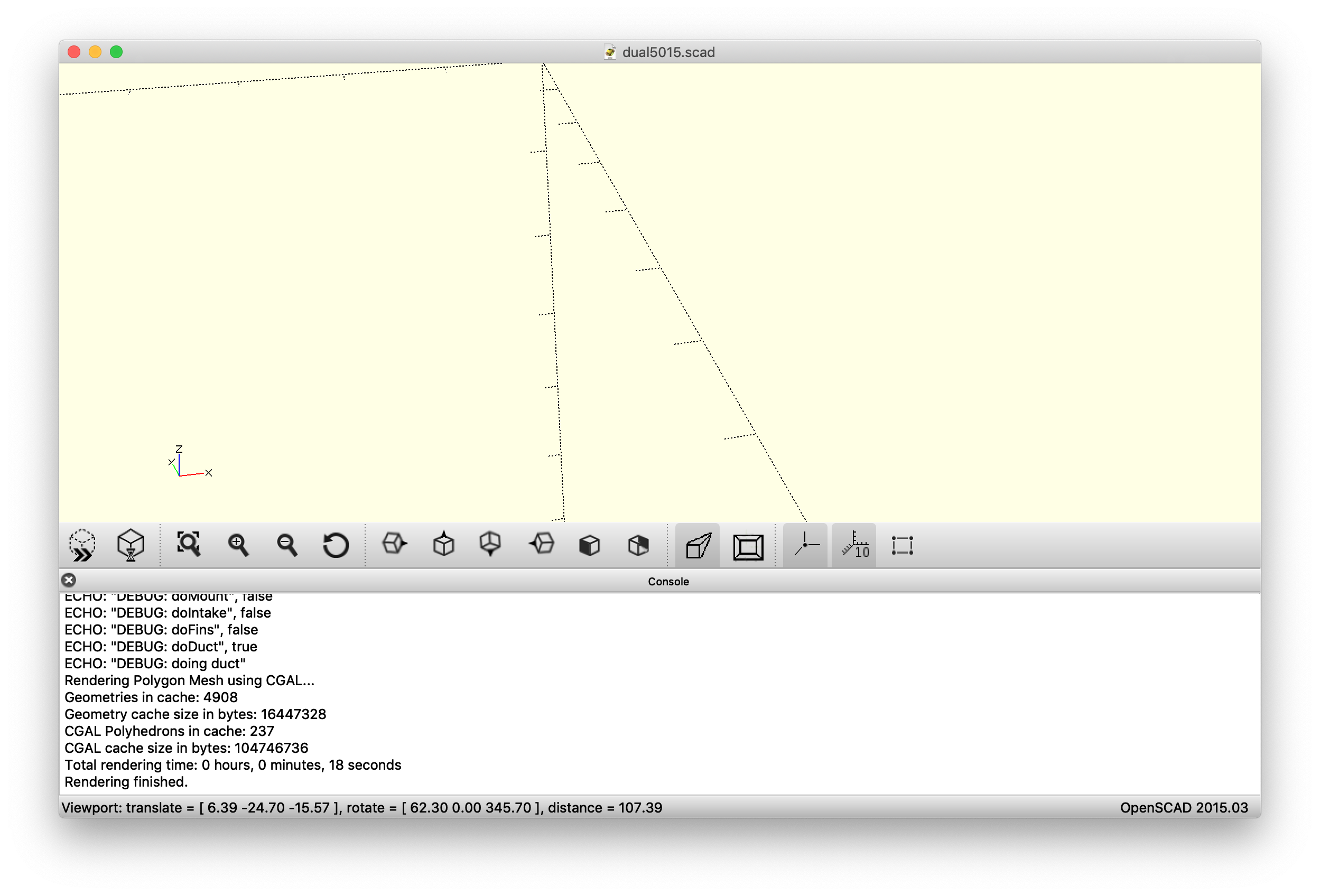

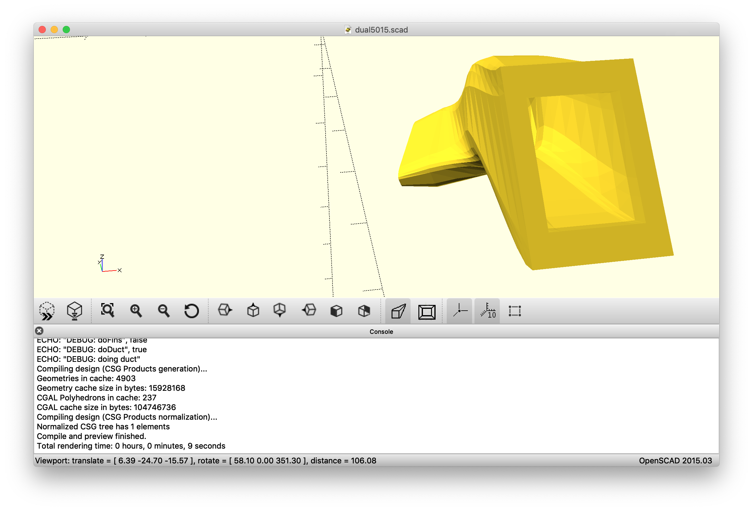

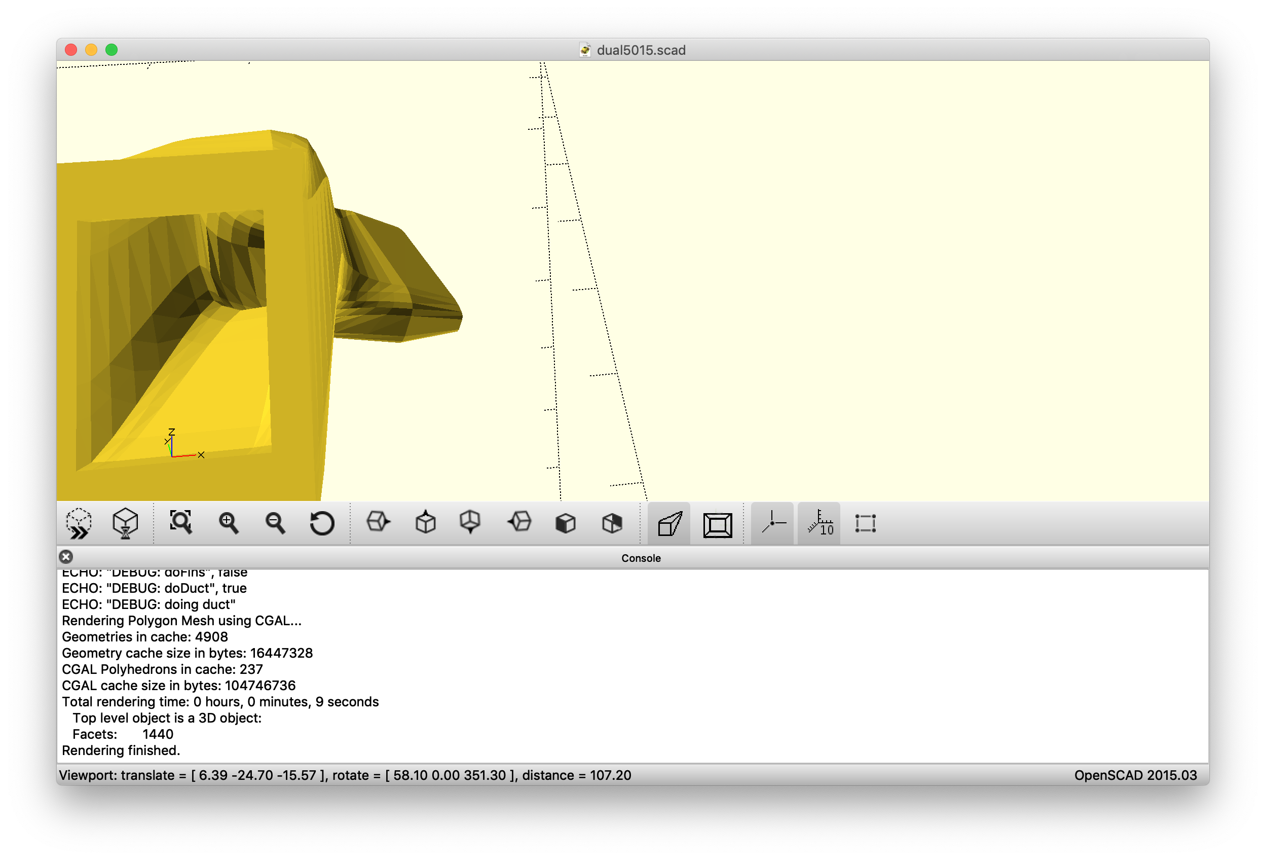

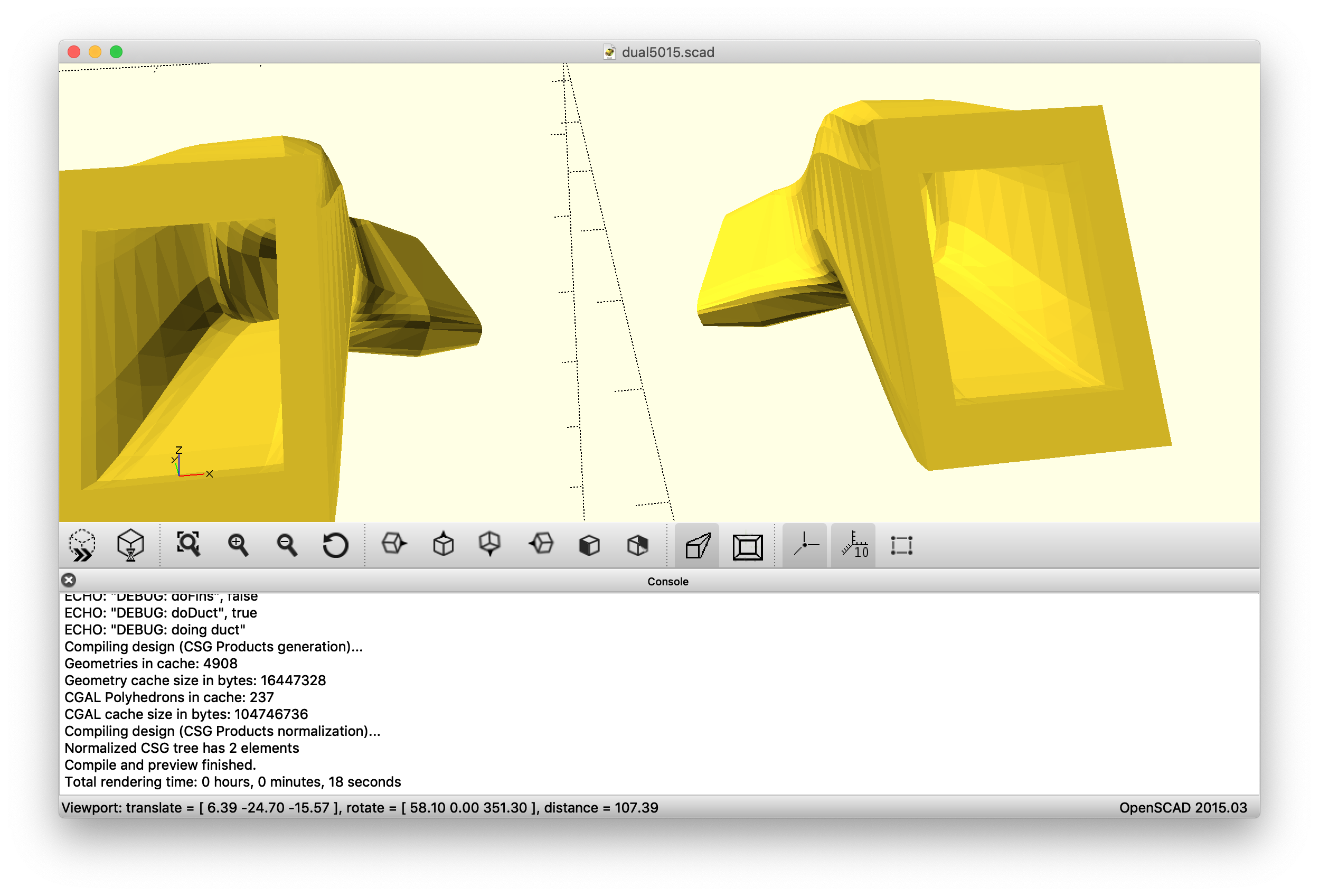

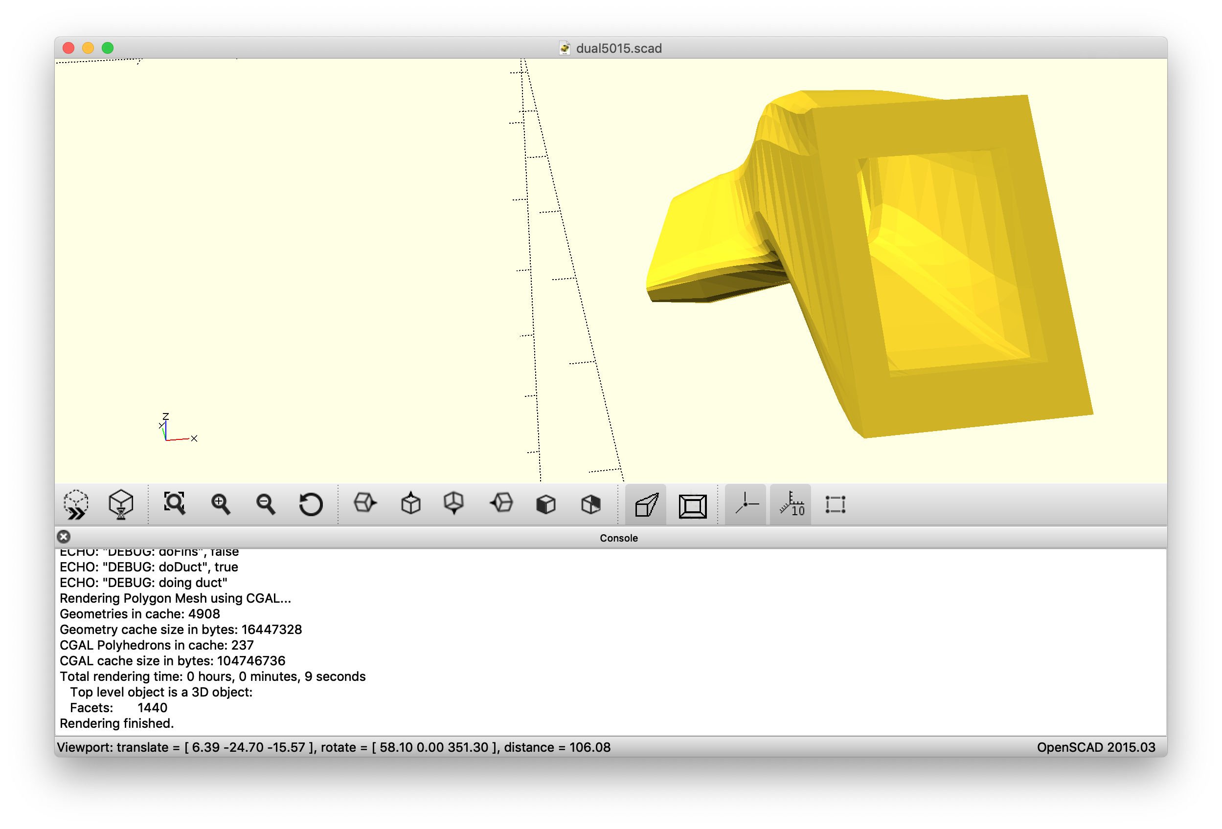

I am having a couple of problems with this approach. One of these is
that the internal code-base does not always seem to be able to handle
userspace polygons properly. For example, I have a complex shape which
is totally manifold, forms a single object, and renders perfectly, if
I put it in a scale([-1, 1, 1]) or mirror([1, 0, 0]) module, it is
properly mirrored, but if I display both the original shape and the
mirrored one, the show properly in the preview but either go
non-manifold or vanish entirely when rendered.

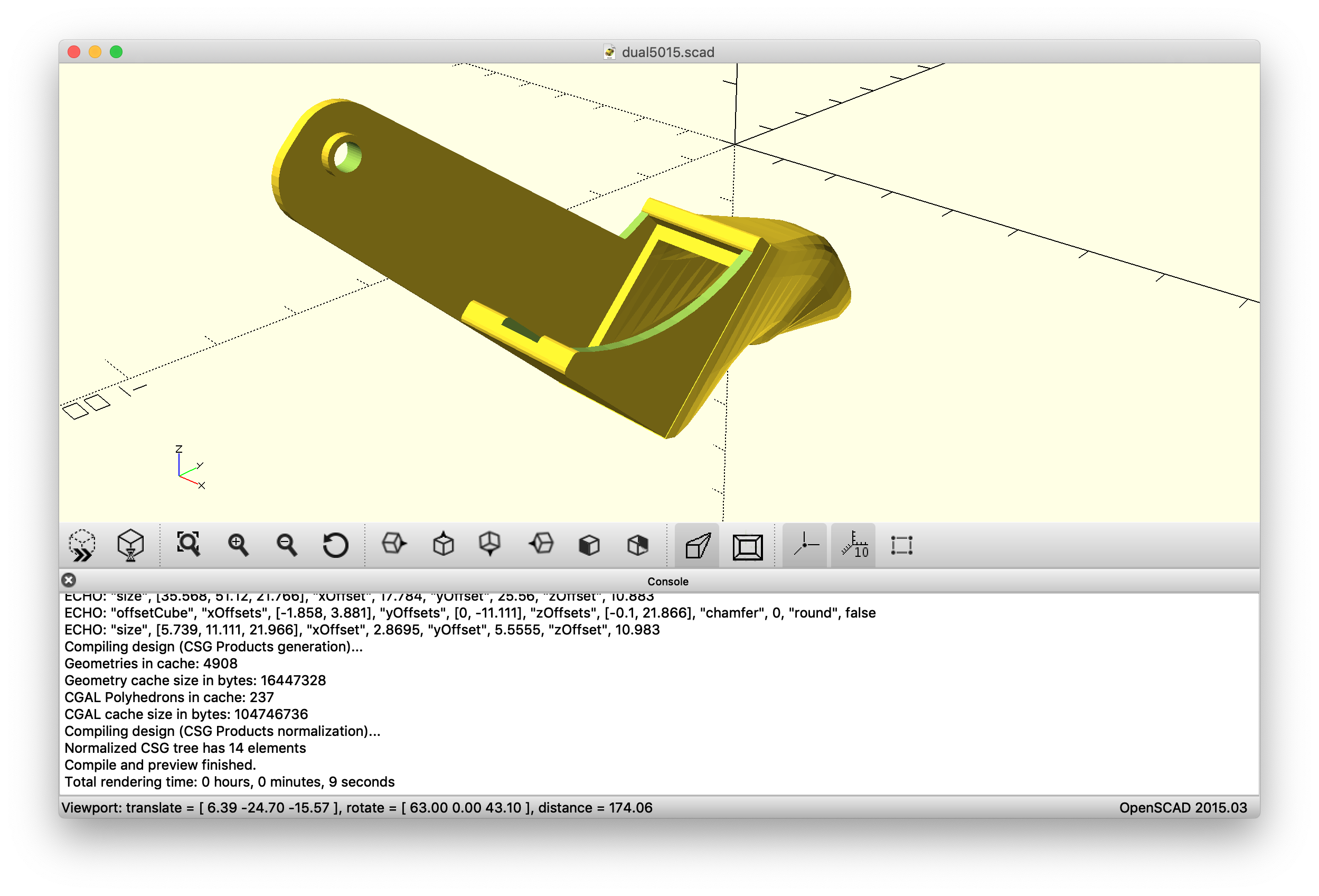

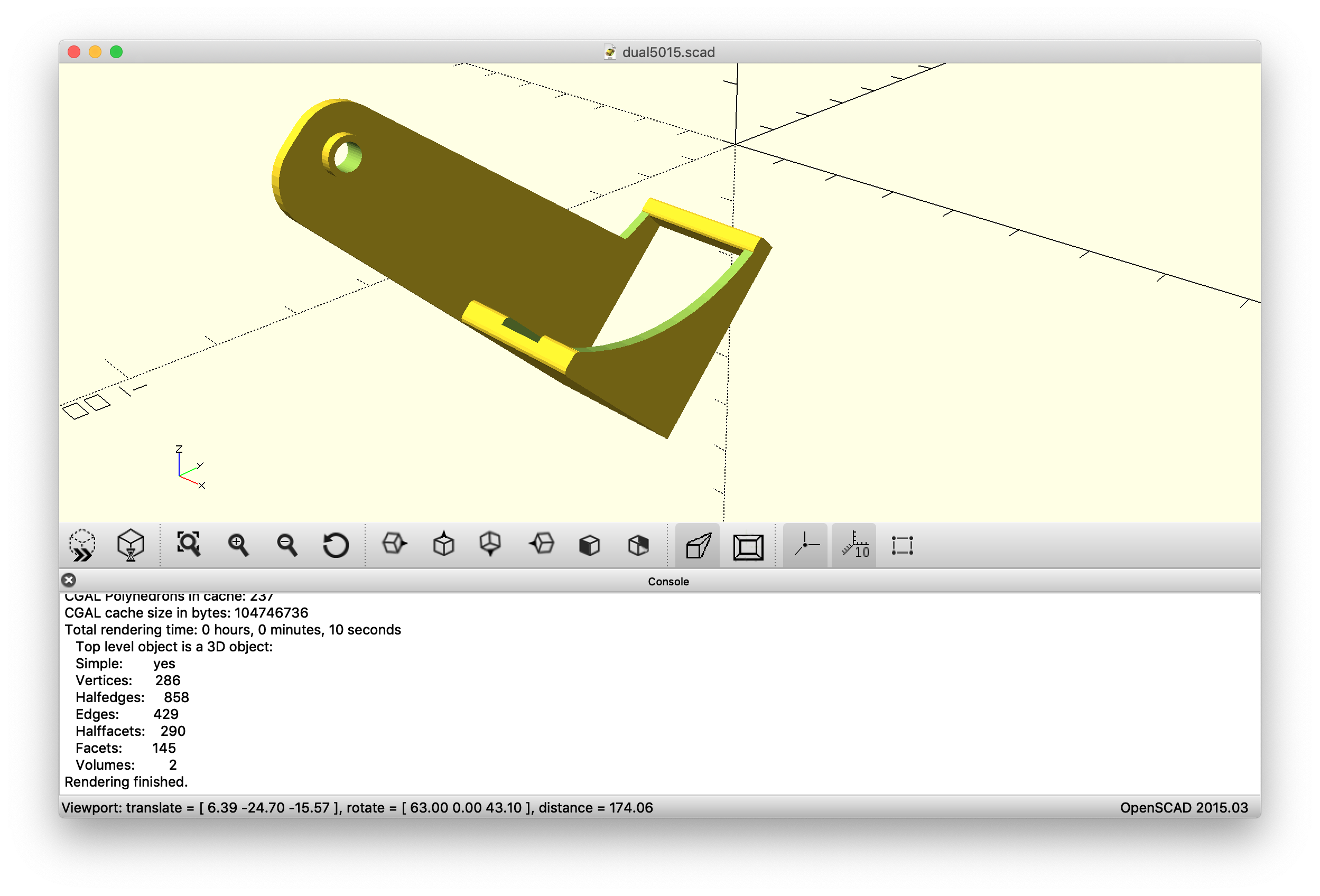

I also have issues when trying to union my shape with other shapes, it
always works fine in preview, but when I render, it may work, or it
may give an assertion failure and leave my shape out of the final
rendering. Actually, in the example I am including a screenshot of,
there was no error or warning at all when it rendered, it just removed
my shape...
Does anybody have any suggestions on what I can do to work around
this? There are shapes that would be REALLY annoying for my to do in
userspace, but if I can't find a workaround or solution for this, I am
going to have to do so...

2015 is so long ago l don't remember what issues it had. In general though
the way to avoid this type of issue is to make sure vertices are either
exactly numerically the same, or different by a significant margin. Close
vertices get merged and that breaks topology.
Another tip is to clear the cache before F6. Preview can cache corrupted
meshes.
When objects disappear without an error it is usually because the error was
generated earlier and an empty mesh was cached.

Oddly enough, even if the two shapes have no overlap at all, by even a
significant margin, I can't get them to render properly. I have tried
with a large visible gap between the two parts, and it still discard
the polyhedron, which is definitely valid.
though the way to avoid this type of issue is to make sure vertices are
either exactly numerically the same, or different by a significant margin.
Close vertices get merged and that breaks topology.
meshes.
was generated earlier and an empty mesh was cached.
my shape...
which
it
removed
my shape...
am
corrupted meshes.
error was generated earlier and an empty mesh was cached.
