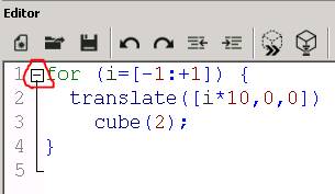

F5 & F6 are the shortcuts for Preview & Render.
If you do either operation, from the Menu or using the Button/Icon, it will save a backup.
Re folding, the fold-state is not saved, so it will not lose info.
AFAIK there are no keycodes for folding, only the icon:
You could have misclicked and then not noticed the little '+'-in-a-box.
That is a possibility, but that wouldn't, or shouldn't cause a render
failure of something else that
uses that folded code... I just went thru that file, there are no +
boxes now.
