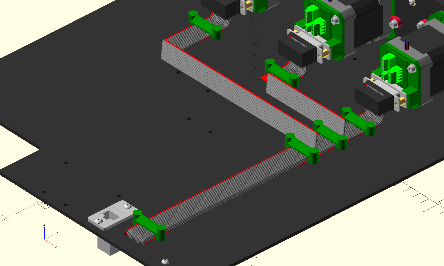

Yes I use arc_points for generating cable runs but I find it difficult to
get the rotate parameter correct myself, as I do all multi axis
rotates in OpenSCAD and often resort to trial and error. Sometimes in
desperation I work out the transformation matrix by hand as I know I want z
= -x, etc, and then pass the matrix of 1s and -1s to euler() to give me the
rotation parameters. I did that while designing this.
I am currently working on an easier way to specify a wire path, with just
one angle around the axis of the wire and an optional second one to specify
a bend that is not 90 degrees. Then I will have a list of those separated
by lengths of the straight sections.
to get the rotate parameter correct myself, as I do all multi axis
just one angle around the axis of the wire and an optional second one to
specify a bend that is not 90 degrees. Then I will have a list of those
separated by lengths of the straight sections.
