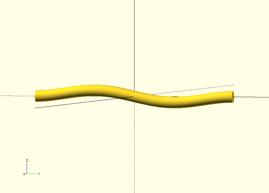

Here is cobbled together a curve just to show what I am looking for. It is derived from a teardrop shape that I picked up in this forum a while back.
m=5;
for (t=[0:5:180])
translate([50+50*cos(t), 30*sin(t)*pow(sin(t/2), m)])
sphere(1);
for (t=[0:5:180])
translate([-50-50*cos(t), -30*sin(t)*pow(sin(t/2), m)])
sphere(1);
The curve is intended to represent a rod (or the centre-line thereof) that is held straight at both ends and has a twist in the middle. But here the twist is an an eye-watering 90°, which in the real world would result in permanent damage, and it doesn’t seem possible to change it (I want about 10° or less). In mathematical terms, the curve I want has a finite length, the twist in the middle is variable and “y” flattens out to zero at the ends.
ends.

After sprinkling a few *’s over the code, it worked. But it gives twist
about the axis of the rod. I need twist perpendicular to the axis - check
my code. You might also call it a double bend, like what you find on
country roads.

Replacing the ^s with *s gives a fantastical moustache! Is that what is intended?
I have been using this so far, but using BOSL2 slows things down horribly:
H = 2.5; // Rod slice length
a = -17; // Wiggle factor, vertical
module rod()
sweep(circle(26, $fn=50),
[for (i=[-180:1:180])
up(H*i) // Length
* back(a*cos($t*360-ph) * sin(i) * pow((pow(180, 2)-pow(i, 2)), 1)/15000 )]);
rotate([90, 0, 0])
rod(ph=0);
Basically, it’s a sine function that is attenuated towards both ends, so that they come out straight. But 1 it’s a fudge, 2 the actual twist/bend angle is unknown, and 3 to me it still doesn’t look quite right. I can’t help thinking the proper formula/equation is out there somewhere.

I would think in terms of Bézier curves, something like...
include <BOSL2/beziers.scad>
bezpath = flatten([
bez_begin([-100,  0],  0,20),
bez_tang ([  0,  0],  20,30),
bez_end  ([ 100,  0], 180,20),
path_sweep(circle(d=20), bezpath_curve(bezpath));
... but I suspect that you'd have to get exactly the right parameters to
simulate a bending rod.
bezpath = flatten([
Ah, that looks interesting! I will need to play around with it a bit to see if I can get it to do what I want.
Jordan Brown wrote: > I would think in terms of Bézier curves, something like... > > include <BOSL2/std.scad> > include <BOSL2/beziers.scad> > > bezpath = flatten(\[ > bez_begin(\[-100, 0\], 0,20), > bez_tang (\[ 0, 0\], 20,30), > bez_end (\[ 100, 0\], 180,20), > \]); > > path_sweep(circle(d=20), bezpath_curve(bezpath)); > > ... but I suspect that you'd have to get exactly the right parameters to > simulate a bending rod. Ah, that looks interesting! I will need to play around with it a bit to see if I can get it to do what I want.
