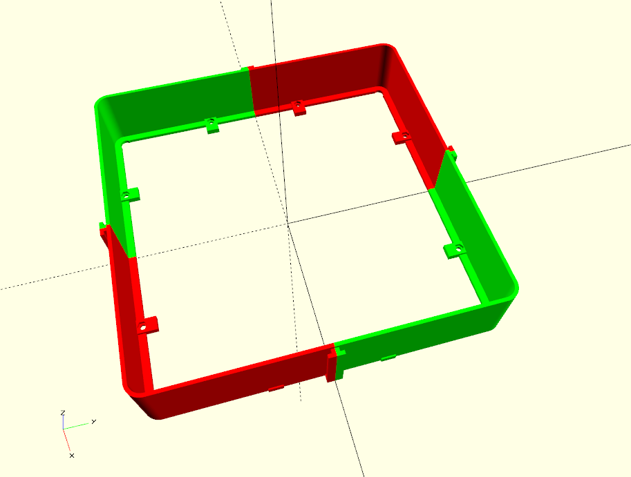

An odd thing I noticed is OpenScad seems to use about 80% of one core even
when it is minimised and doing nothing. This is true of both the old and
the new version.
Also I am not sure the problem is simply slow drawing. If I drag the mouse
continuously is seems to draw a short burst of frames rapidly and then
pause for nearly a second and then repeat. It seems like it spends most of
the time doing something else. The old version will draw contiguously if I
move the mouse continuously and that revs up the graphics card fan. The new
one doesn't spend enough time drawing to do that.

MK
Marius Kintel
Wed, Feb 11, 2015 4:25 PM
On Feb 11, 2015, at 09:13 AM, nop head nop.head@gmail.com wrote:
Even a relatively simple design with only four render()ed parts chugs at about one frame per second whereas it pans and rotates in real time with the old version.
That doesn’t looks like a Mendel90 part. Could you share that design?
-Marius

Yvette S. Hirth, CCP, CDP
Wed, Feb 11, 2015 4:29 PM

if the design for the image that is shown is not proprietary, could you
please post the .scad?  i'd like to see what it is that you are doing...

Wed, Feb 11, 2015 4:31 PM
Not easily because it has lots of dependencies but the render in short
bursts issue seems to be any part of Mendel90. For example bar-clamps.scad
does it.

Wed, Feb 11, 2015 4:45 PM
Turning off automatic reload seems to fix the pausing issue.
