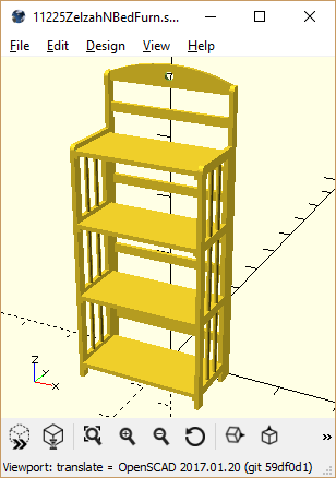

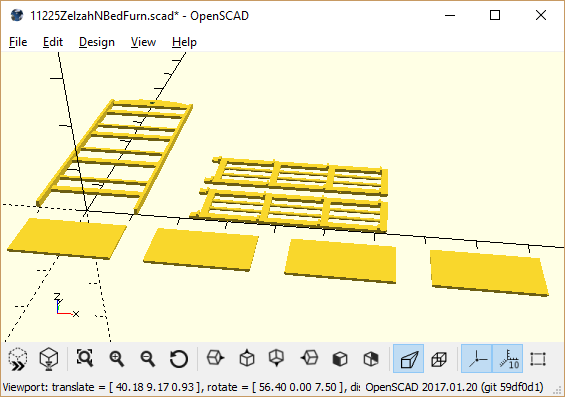

Rather than print the entire thing, while I am tweaking a smaller part of
it, I use intersection with a cube to only render exactly what I am working
on at the moment.
I save a lot of time, and filament while tweaking.
Then when I am satisfied with every part of the design, I bite the bullet
and do the entire design.
Also, if the design I am working on, is capable of being done in parts
(that can be glued together later, I use the same technique, to print each
part separately.
Jerry

I've been doing that more, but my reason is that it lets me built thin
parts and still have them be strong, by keeping them in XY.
