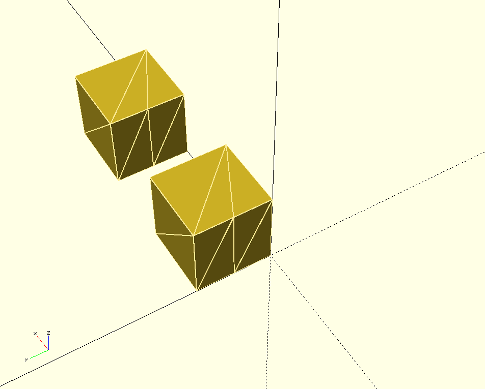

I have a problem rendering polyhedra built using a fairly lengthy OpenSCAD
script.  The following short script demonstrates the issue. Any help
appreciated, thanks!
// CUBE size=60
// Meshed with 2 triangles per face, except face x=0 which has 4 triangles
// If set to false, draws 1 cube, renders OK, imports into MeshLab OK.
// If set to true, draws 2 cubes, on render:
//    "WARNING: Object may not be a valid 2-manifold and may need repair!"
Show_Rendering_Error=true;
p=[[0,0,0],[60,0,0],[60,60,0],[0,60,0],
[0,0,60],[60,0,60],[60,60,60],[0,60,60],
[0,30,0],[0,30,60]];
f=[[3,7,9],[9,8,3],[8,9,4],[0,8,4], // face x=0
[1,0,4],[1,4,5],                // face y=0
[1,3,0],[2,3,1],                // face z=0
[1,5,2],[2,5,6],                // face x=60
[2,7,3],[6,7,2],                // face y=60
[5,4,7],[5,7,6]];                // face z=60
polyhedron(points=p,faces=f);
if (Show_Rendering_Error) translate([120,0,0]) polyhedron(points=p,faces=f);

You stitched your cube correctly. The face x=0 is made up of 4 triangles. Do you have problems with the exported STL? 2015-07-28 17:02 GMT+02:00 Trygon <db5765@outlook.com>: > I have a problem rendering polyhedra built using a fairly lengthy OpenSCAD > script. The following short script demonstrates the issue. Any help > appreciated, thanks! > > // CUBE size=60 > // Meshed with 2 triangles per face, except face x=0 which has 4 triangles > > // If set to false, draws 1 cube, renders OK, imports into MeshLab OK. > // If set to true, draws 2 cubes, on render: > // "WARNING: Object may not be a valid 2-manifold and may need repair!" > Show_Rendering_Error=true; > > p=[[0,0,0],[60,0,0],[60,60,0],[0,60,0], > [0,0,60],[60,0,60],[60,60,60],[0,60,60], > [0,30,0],[0,30,60]]; > > f=[[3,7,9],[9,8,3],[8,9,4],[0,8,4], // face x=0 > [1,0,4],[1,4,5], // face y=0 > [1,3,0],[2,3,1], // face z=0 > [1,5,2],[2,5,6], // face x=60 > [2,7,3],[6,7,2], // face y=60 > [5,4,7],[5,7,6]]; // face z=60 > > polyhedron(points=p,faces=f); > if (Show_Rendering_Error) translate([120,0,0]) > polyhedron(points=p,faces=f); > > > > > > -- > View this message in context: > http://forum.openscad.org/Rendering-error-using-polyhedron-tp13336.html > Sent from the OpenSCAD mailing list archive at Nabble.com. > > _______________________________________________ > OpenSCAD mailing list > Discuss@lists.openscad.org > http://lists.openscad.org/mailman/listinfo/discuss_lists.openscad.org > -- stempeldergeschichte@googlemail.com <karsten@rohrbach.de> P.S. Falls meine E-Mail kürzer ausfällt als Dir angenehm ist: Ich probiere gerade aus kurze Antworten statt gar keine Antworten zu schreiben. Wenn Du gerne mehr lesen möchtest, dann lass es mich bitte wissen. P.S. In case my e-mail is shorter than you enjoy: I am currently trying short replies instead of no replies at all. Please let me know, if you like to read more. Enjoy!
Tue, Jul 28, 2015 4:13 PM
I don't think it is a valid triangulation because the vertices at 30 meet
the side of the triangles on the top and bottom, not at a vertex.

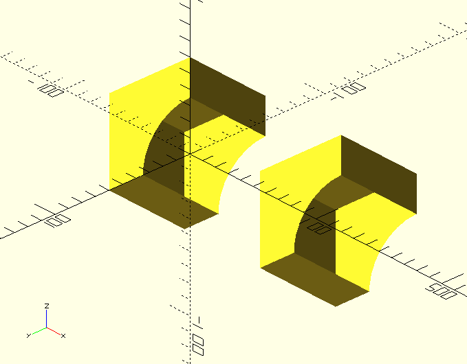

Peter Falke
Tue, Jul 28, 2015 4:35 PM
The problem starts if you do something with your cubes.
Like subtracting a cylinder.
// CUBE size=60
union(){
rotate([0,90,0])translate([0,0,-10])cylinder(200,35,35);

PF
Peter Falke
Tue, Jul 28, 2015 4:40 PM
The problems remains even if you let OpenSCAD do the tessellation of the x=0
face: [3,7,9,4,0,8], // face x=0
// CUBE size=60
repair!"
union(){
This is to illustrate nophead's point (The point-8 has the same issue, too)
http://forum.openscad.org/file/n13345/20150728_wrong_triang_1.png
$  Runsun Pan, PhD
$ -- libs: doctest , faces ( git ), offliner ( git );
tips: hash( 1 , 2 ), sweep , var
$ -- Linux Mint 17.1 Rebecca x64  + OpenSCAD 2015.03.15/2015.04.01.nightly
View this message in context: http://forum.openscad.org/Rendering-error-using-polyhedron-tp13336p13345.html
repair!"
union(){
2015-07-28 18:13 GMT+02:00 nop head nop.head@gmail.com:
meet the side of the triangles on the top and bottom, not at a vertex.
On 28 July 2015 at 17:03, Peter Falke <
