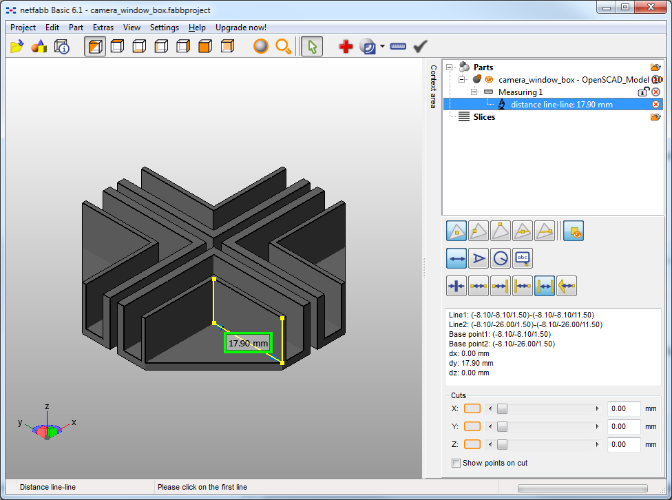

I do have something difficult I need to do: somehow find a way to place a
marker on the rendered object interactively and locate that point. Or even
compute a distance between two markers. If I can figure out a way to do
that in openscad I don't care whether it is functional or imperative or
declarative, I like it just fine - and if I can't do that then I'll have to
move to some other system which I would find unfortunate because so far
after a few months openSCAD has always got the job done for me.
Edmund

I never need to do that because if a dimension is important I specify it in
my source code and make it so in the code. Do you want to measure other
people's designs?

edmund ronald wrote:
I do have something difficult I need to do: somehow find a way to place a marker
on the rendered object interactively and locate that point. Or even compute a
distance between two markers. If I can figure out a way to do that in openscad
I don't care whether it is functional or imperative or declarative, I like it just fine -
and if I can't do that then I'll have to move to some other system which I would
find unfortunate because so far after a few months openSCAD has always got the job done for me.
When I need to check a distance/position, I add in geometry as necessary to measure, usually prefacing it w/ a # so that it renders transparent, sometimes assigning it to a different colour.

"I never do X" is not really an answer to a question.
My designs contain a bunch of curves, and then to be sure whether they fit
something I need to check.
I once interviewed a senior manager at IBM who told me, for quote to a
business magazine "We don't need mice and windows, we're not children".
A similar story was true of the Mac, where Steve Jobs vetoed arrow keys on
the Mac again because he didn't see a need for them.
More technically, openSCAD has a text based programming model, and a window
and mouse presentation layer. I fully agree that the programming model is
useful and powerful; I just need some added facilities in the presentation
layer. I have looked in the archives and people keep asking for this and

Well OpenSCAD is a language for defining geometry in code. So if a curve
has to miss something or meet something I express that in the code. I don't
do trial and error. When you preview the geometry is just drawn as pixels,
so there isn't really a way to get dimensions from them, hence why the
requests are not implemented. Once rendered with F6  measurements could be
made like NetFabb is able to measure STLs, but it is a lot of work to
implement that, so it won't happen until a developer with the skill to do
it thinks it is worth spending time on.
This is what I would use if I had to measure something. but in this case,
and all others, I can write an expression for the distance and
OpenSCAD echos 17.9.

This was a discussion about coding and it seems you're trying to divert it
to a totally different subject, since making measurements has nothing to do
with coding.  It seems to me that if this feature were implemented it would
be of very limited utility, because there's no way to unambiguously define
a point by clicking the mouse.  If you want to know that some curved
surface meets some criterion, how can you define via the mouse a point on
that curved surface that is actually well-defined?  This seems impossible,
unless you have some way to define the point such as intersection with some
other pair of surfaces.  I think I have to agree with nophead that if you
have some constraints you need to meet then you should use the programmatic
interface to build a model that meets them, not construct an ad-hoc model
and try to verify that you've met the constraints.  If this doesn't seem
adequate for your problem then I guess OpenSCAD isn't suited to your needs.
