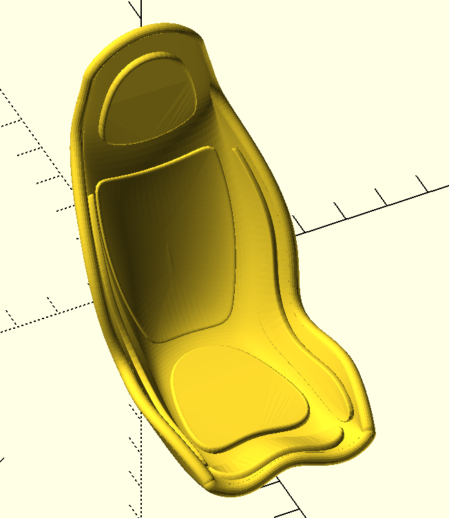

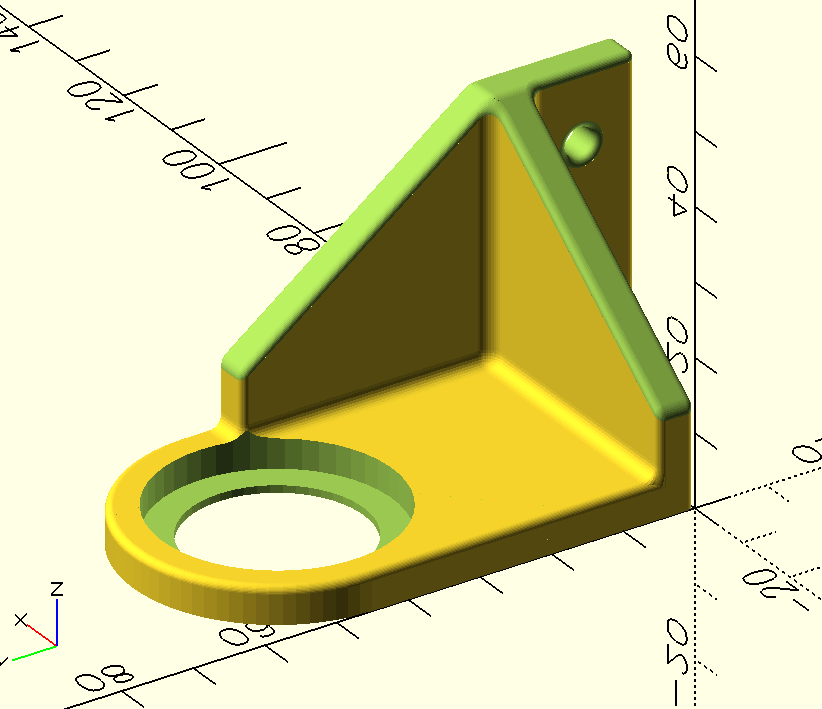

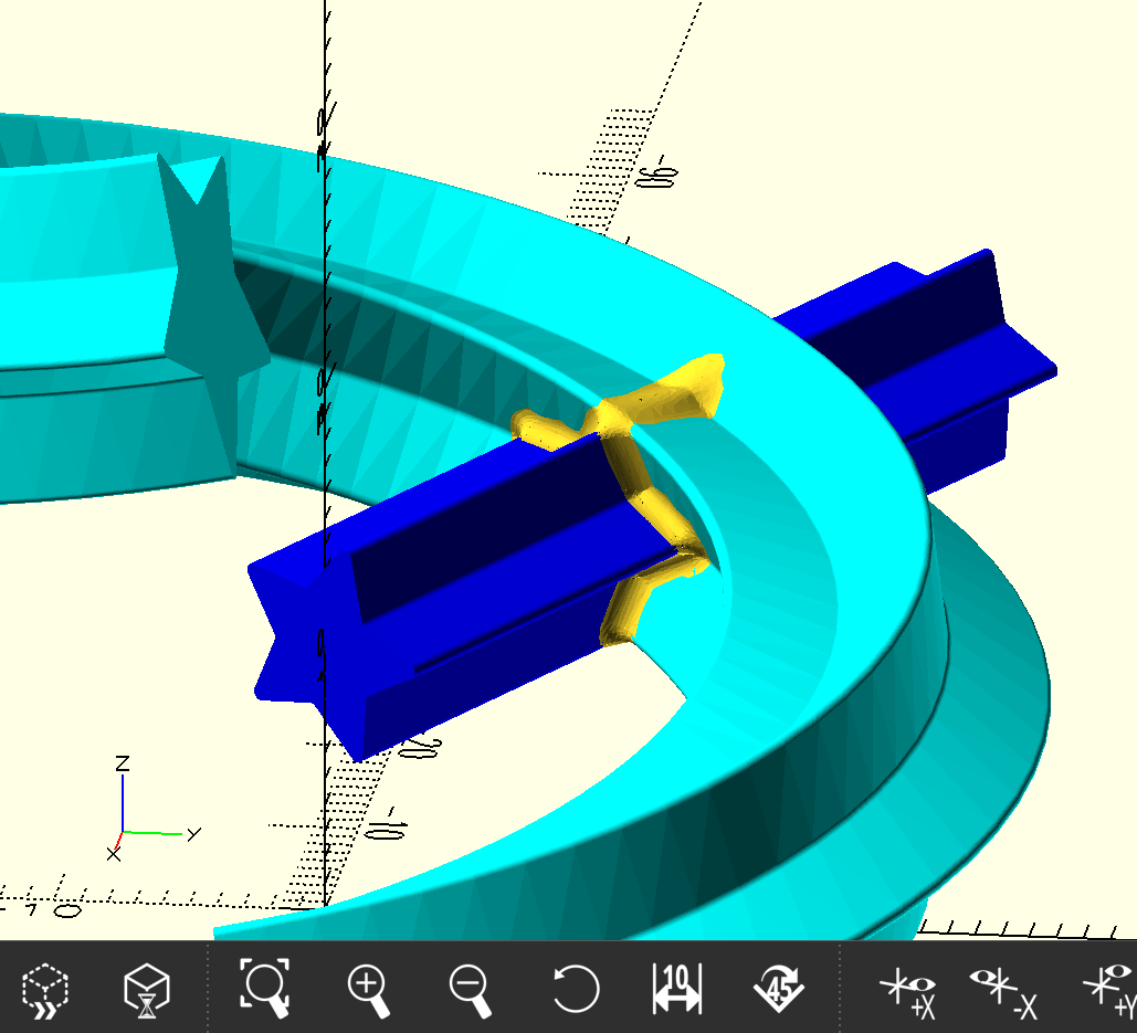

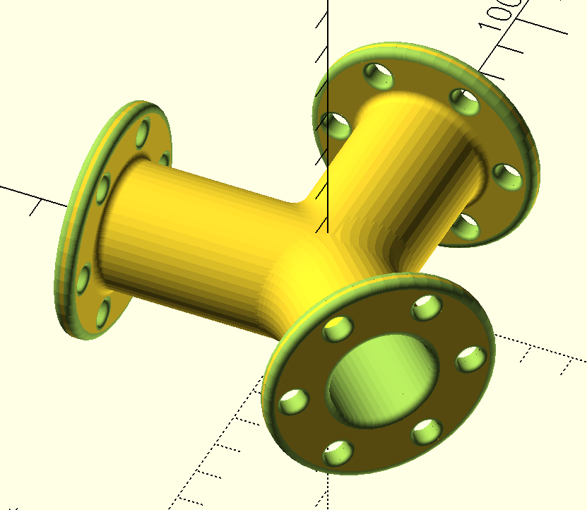

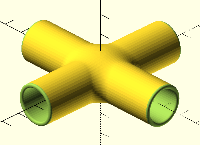

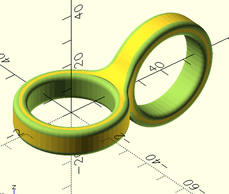

I have been working with python to find some solution on fillets and
rounding in openSCAD.
Although I could not find any specific solution, there could be a few
strategies which can be followed to create rounding and fillets.
sharing a few pictures here to show what is possible. What is required is
to find a way to work with points in 3d space, instead of openSCAD
primitives.
[image: Screenshot 2025-08-22 at 10.43.34 PM.png]
[image: Screenshot 2025-08-22 at 9.44.25 PM.png]
[image: Screenshot 2025-08-22 at 11.14.20 PM.png]
[image: Screenshot 2025-08-22 at 11.18.54 PM.png][image: Screenshot
2025-08-22 at 11.21.39 PM.png][image: Screenshot 2025-08-22 at
11.41.27 PM.png]

@Sanjeev: I have several questions.
  1. What are your strategies?
  2. Are your fillets real fillets (constant radius or something), or just
    something that looks good enough? For the third figure (2 tubes), it
    doesn't look like a constant radius result to me as the transition
    doesn't look as smooth.
