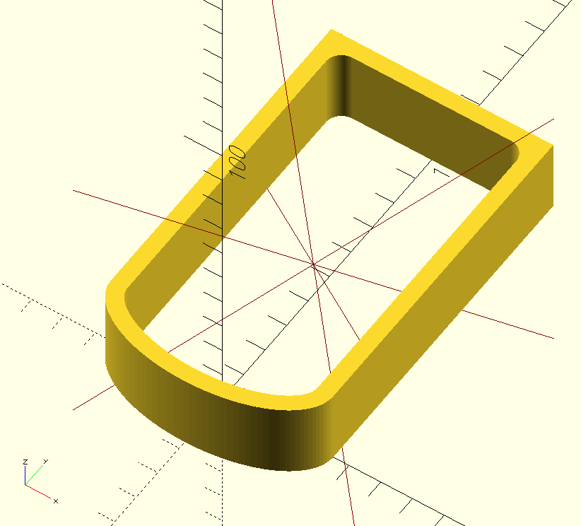

Is there an easy way to round the internal top edge of this shape?  I
looked at BOSL2 but gave up.  Code is below.
$fn = 120;
bw = 60;
bd = 100;
ds = 5;
dw = bw + 2*ds;
dd = bd + 20;
dh = 25;
sc = 0.5;
module DishShape2D()
    hull() {
        scale([1, sc])
            circle(d = dw);
        translate([-dw/2, 0])
            square([dw, dd - sc*dw/2]);
linear_extrude(dh, convexity = 20)
        DishShape2D();
        offset(ds) offset(-ds) offset(-ds)
            DishShape2D();

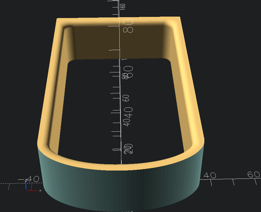

It was easy for me to do this with hull_join() which I have been discussing
in another thread.  Here I'm using a new helper module based on minkowski
which eliminates the need to calculate scaling parameters for precise join
size and shape.
[image: dish.png]

module RoundedDishCore() {
// a plate on top of DishCore() with a rounded join
hull_join(iterations=24, children=true) {
translate([-dw,-bd0.5,dh])
hj_minkowski_cube(2
rounding)
cube([dw2,bd2,1]);    // A plate significantly bigger
than DishCore()
hj_minkowski_cube(2*rounding) DishCore();
linear_extrude(dh, convexity = 20) DishShape2D();
translate([0,0,-eps]) RoundedDishCore();
 shape?  I looked at BOSL2 but gave up.  Code is below.
 $fn = 120;
 bw = 60;
 bd = 100;
 ds = 5;
 dw = bw + 2*ds;
 dd = bd + 20;
 dh = 25;
 sc = 0.5;
     hull() {
         scale([1, sc])
             circle(d = dw);
         DishShape2D();
             DishShape2D();
 <https://urldefense.proofpoint.com/v2/url?u=http-3A__www.avg.com_email-2Dsignature-3Futm-5Fmedium-3Demail-26utm-5Fsource-3Dlink-26utm-5Fcampaign-3Dsig-2Demail-26utm-5Fcontent-3Demailclient&d=DwMFaQ&c=euGZstcaTDllvimEN8b7jXrwqOf-v5A_CdpgnVfiiMM&r=AsrE-c7ZR7B2Kyr3qgfvvppkCEBVsNmwEMndcrRSuOI&m=GAJ5LInnmHEgVmQRgvm9H2NTOGectG4oO-7uWPjf1jKyrFn9beAAPB6-xLV6sRoV&s=HdfDDHEQxJ2JcW932SFLu81aJtRxXdBIKz3vvgIQCb0&e=>
 	Virus-free.www.avg.com
 <#m_-3217382146105684572_m_-3516739280469875608_DAB4FAD8-2DD7-40BB-A1B8-4E2AA1F9FDF2>
Thank you, Dan.  That works quite well. However, what I wanted was to round the interior, not the exterior.  I looked at the documentation for mask2d_roundover() and did not see a way to apply it differently to my "hollow" shape. Jon On 12/26/2025 5:39 PM, Dan Perry via Discuss wrote: > The short answer is to use path_sweep with mask2d_roundover().  But > there's more to it as you can see below. > Dan > > > include <BOSL2/std.scad> > > $fn = 120; > > bw = 60; > bd = 100; > > ds = 5; > dw = bw + 2*ds; > dd = bd + 20; > dh = 25; > > sc = 0.5; > > DishShape2D = union( >     scale([1, sc], circle(d = dw)), >     translate([-dw/2, 0], square([dw, dd - sc*dw/2])) > ); > > difference() { > linear_extrude(dh, convexity = 20) >     region(difference( >         DishShape2D, >         offset( >             offset( >                 offset(DishShape2D, delta=-ds, closed=true), >                 delta=-ds, closed=true), >             delta=ds, closed=true) >     )); >     up(dh) path_sweep( >         mask2d_roundover(r=1, spin=180), DishShape2D, closed=true); > > } > > On Fri, Dec 26, 2025 at 1:39 PM Jon Bondy via Discuss > <discuss@lists.openscad.org> wrote: > > Is there an easy way to round the internal top edge of this > shape?  I looked at BOSL2 but gave up.  Code is below. > > > > $fn = 120; > > bw = 60; > bd = 100; > > ds = 5; > dw = bw + 2*ds; > dd = bd + 20; > dh = 25; > > sc = 0.5; > > module DishShape2D() >     hull() { >         scale([1, sc]) >             circle(d = dw); >         translate([-dw/2, 0]) >             square([dw, dd - sc*dw/2]); >         } > > linear_extrude(dh, convexity = 20) >     difference() { >         DishShape2D(); >         offset(ds) offset(-ds) offset(-ds) >             DishShape2D(); >         } > > > <https://urldefense.proofpoint.com/v2/url?u=http-3A__www.avg.com_email-2Dsignature-3Futm-5Fmedium-3Demail-26utm-5Fsource-3Dlink-26utm-5Fcampaign-3Dsig-2Demail-26utm-5Fcontent-3Demailclient&d=DwMFaQ&c=euGZstcaTDllvimEN8b7jXrwqOf-v5A_CdpgnVfiiMM&r=AsrE-c7ZR7B2Kyr3qgfvvppkCEBVsNmwEMndcrRSuOI&m=GAJ5LInnmHEgVmQRgvm9H2NTOGectG4oO-7uWPjf1jKyrFn9beAAPB6-xLV6sRoV&s=HdfDDHEQxJ2JcW932SFLu81aJtRxXdBIKz3vvgIQCb0&e=> > Virus-free.www.avg.com > <https://urldefense.proofpoint.com/v2/url?u=http-3A__www.avg.com_email-2Dsignature-3Futm-5Fmedium-3Demail-26utm-5Fsource-3Dlink-26utm-5Fcampaign-3Dsig-2Demail-26utm-5Fcontent-3Demailclient&d=DwMFaQ&c=euGZstcaTDllvimEN8b7jXrwqOf-v5A_CdpgnVfiiMM&r=AsrE-c7ZR7B2Kyr3qgfvvppkCEBVsNmwEMndcrRSuOI&m=GAJ5LInnmHEgVmQRgvm9H2NTOGectG4oO-7uWPjf1jKyrFn9beAAPB6-xLV6sRoV&s=HdfDDHEQxJ2JcW932SFLu81aJtRxXdBIKz3vvgIQCb0&e=> > > > <#m_-3217382146105684572_m_-3516739280469875608_DAB4FAD8-2DD7-40BB-A1B8-4E2AA1F9FDF2> > _______________________________________________ > OpenSCAD mailing list > To unsubscribe send an email to discuss-leave@lists.openscad.org > > > _______________________________________________ > OpenSCAD mailing list > To unsubscribe send an email todiscuss-leave@lists.openscad.org -- This email has been checked for viruses by AVG antivirus software. www.avg.com
JJ
jon jonbondy.com

Never mind.  Got it.  Make another shape for the interior and do the path_sweep() with a spin of 270.

Never mind. Got it. Make another shape for the interior and do the path_sweep() with a spin of 270. On 12/27/2025 7:57 AM, Jon Bondy via Discuss wrote: Thank you, Dan. That works quite well. However, what I wanted was to round the interior, not the exterior. I looked at the documentation for mask2d_roundover() and did not see a way to apply it differently to my "hollow" shape. Jon On 12/26/2025 5:39 PM, Dan Perry via Discuss wrote: The short answer is to use path_sweep with mask2d_roundover(). But there's more to it as you can see below. Dan include <BOSL2/std.scad> $fn = 120; bw = 60; bd = 100; ds = 5; dw = bw + 2*ds; dd = bd + 20; dh = 25; sc = 0.5; DishShape2D = union( scale([1, sc], circle(d = dw)), translate([-dw/2, 0], square([dw, dd - sc*dw/2])) ); difference() { linear_extrude(dh, convexity = 20) region(difference( DishShape2D, offset( offset( offset(DishShape2D, delta=-ds, closed=true), delta=-ds, closed=true), delta=ds, closed=true) )); up(dh) path_sweep( mask2d_roundover(r=1, spin=180), DishShape2D, closed=true); } On Fri, Dec 26, 2025 at 1:39 PM Jon Bondy via Discuss <discuss@lists.openscad.org<mailto:discuss@lists.openscad.org>> wrote: Is there an easy way to round the internal top edge of this shape? I looked at BOSL2 but gave up. Code is below. [cid:part1.g7wB0TBw.ieqzOv8z@jonbondy.com] $fn = 120; bw = 60; bd = 100; ds = 5; dw = bw + 2*ds; dd = bd + 20; dh = 25; sc = 0.5; module DishShape2D() hull() { scale([1, sc]) circle(d = dw); translate([-dw/2, 0]) square([dw, dd - sc*dw/2]); } linear_extrude(dh, convexity = 20) difference() { DishShape2D(); offset(ds) offset(-ds) offset(-ds) DishShape2D(); } [https://s-install.avcdn.net/ipm/preview/icons/icon-envelope-tick-green-avg-v1.png]<https://urldefense.proofpoint.com/v2/url?u=http-3A__www.avg.com_email-2Dsignature-3Futm-5Fmedium-3Demail-26utm-5Fsource-3Dlink-26utm-5Fcampaign-3Dsig-2Demail-26utm-5Fcontent-3Demailclient&d=DwMFaQ&c=euGZstcaTDllvimEN8b7jXrwqOf-v5A_CdpgnVfiiMM&r=AsrE-c7ZR7B2Kyr3qgfvvppkCEBVsNmwEMndcrRSuOI&m=GAJ5LInnmHEgVmQRgvm9H2NTOGectG4oO-7uWPjf1jKyrFn9beAAPB6-xLV6sRoV&s=HdfDDHEQxJ2JcW932SFLu81aJtRxXdBIKz3vvgIQCb0&e=> Virus-free.www.avg.com<https://urldefense.proofpoint.com/v2/url?u=http-3A__www.avg.com_email-2Dsignature-3Futm-5Fmedium-3Demail-26utm-5Fsource-3Dlink-26utm-5Fcampaign-3Dsig-2Demail-26utm-5Fcontent-3Demailclient&d=DwMFaQ&c=euGZstcaTDllvimEN8b7jXrwqOf-v5A_CdpgnVfiiMM&r=AsrE-c7ZR7B2Kyr3qgfvvppkCEBVsNmwEMndcrRSuOI&m=GAJ5LInnmHEgVmQRgvm9H2NTOGectG4oO-7uWPjf1jKyrFn9beAAPB6-xLV6sRoV&s=HdfDDHEQxJ2JcW932SFLu81aJtRxXdBIKz3vvgIQCb0&e=> _______________________________________________ OpenSCAD mailing list To unsubscribe send an email to discuss-leave@lists.openscad.org<mailto:discuss-leave@lists.openscad.org> _______________________________________________ OpenSCAD mailing list To unsubscribe send an email to discuss-leave@lists.openscad.org<mailto:discuss-leave@lists.openscad.org> _______________________________________________ OpenSCAD mailing list To unsubscribe send an email to discuss-leave@lists.openscad.org<mailto:discuss-leave@lists.openscad.org>
Sat, Jan 3, 2026 1:02 AM
Here's how to do it using offset_sweep:
$fn = 120;
bw = 60;
bd = 100;
ds = 5;
dw = bw + 2*ds;
dd = bd + 20;
dh = 25;
sc = 0.5;
function DishShape2D() =
hull_region(concat(
yscale(sc, circle(d = dw)),
rect([dw, dd - sc*dw/2],anchor=FWD)
inside = offset(offset(DishShape2D(),-ds*2),r=ds);
linear_sweep(DishShape2D(),height=dh);
offset_sweep(inside, height=dh, top=os_circle(r=-3),extra=1);
