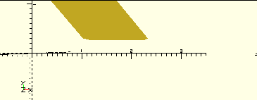

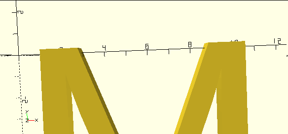

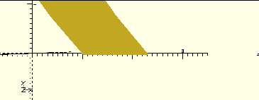

Effects
There are approximately six things affected:
