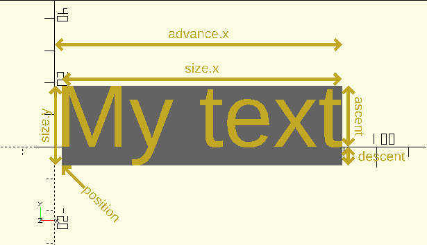

I'm excited to announce that the text metric functions that I've been
working on are finally in the development snapshot.  (OK, I'm easily
excited.)
What they do:  You give textmetrics() parameters equivalent to the
parameters to text() - a string, size, font, et cetera - and the
textmetrics() function tells you various things about how that string
would be rendered.  It tells you the bounding box of the actual object
created, how far above and below the baseline the text extends, where
the next string would be placed, et cetera.  The related fontmetrics()
function gives you some font-global measurements and, perhaps most
usefully, tells you the name of the actual font selected.
What they don't do:  They don't give you the list of points that make up
the text.  (Maybe in a future project, but maybe that would be better
done in a generic way that works for any geometric object.)
Also interesting is that this project introduces a new data type - for
the moment called an "object", but I don't know that that's really been
settled on, given that that name is also used for geometric objects.  An
object is, like an object in JavaScript or a dictionary in Python, a
collection of names and values.  Objects are  important to this project
because they allow the function to return several values in a structured
and self-documenting way.  You can retrieve values out of an object
using either "object.name" or "object[string]", you can get all of the
keys for the object, you can echo an object, you can convert an object
into a string, and you can test for whether a particular data item is an
object using is_object().  You cannot yet create your own objects.
These new features are still experimental.  To use them, you have to
turn them on at Edit / Preferences / Features.
Comments solicited.
Here's some draft documentation.
|textmetrics()| returns information about the size and positioning that
would be applied to text if laid out as specified by its arguments.
The arguments to |textmetrics()| are exactly the same as the arguments
to |text()|.
The return value from |textmetrics()| is an object with these properties:
  • position: an [x,y] pair giving the lower left corner of the smallest
    box that would completely surround the text.
  • size: an [x,y] pair giving the size of that box.
  • ascent: the vertical distance (normally positive) from the baseline
    of the text to the highest point in the text.
  • descent: the vertical distance (normally zero or negative) from the
    baseline of the text to the lowest point in the text.
  • offset: an [x,y] pair giving the distance from the origin to the
    starting point of the baseline of the text. This value is normally
    [0,0] but can be non-zero when using non-default alignments.
  • advance: an [x,y] pair giving the distance from the starting point
    for this text to the starting point for a subsequent piece of text.
    Informally, it says how far the pen should be moved before starting
    the next piece of text. This value is directly helpful only with
    default alignments - horizontal text aligned left/baseline and
    vertical text aligned center/top.
Note:  as with any array, you can use an object-like ".x" or ".y" to
refer to the two entries in [x,y] pairs.  Thus you can refer to either
obj.size[0] or obj.size.x to get the X dimension of the text.
Here's a sample output (reformatted for readability):
ECHO: {
    position = [2.2784, -5.7728];
    size = [87.0362, 24.8832];
    ascent = 19.1104;
    descent = -5.7728;
    offset = [0, 0];
    advance = [89.5186, 0];
and here's an illustration showing some of the values:
|fontmetrics()| returns information about the specified font and size.
The arguments to |fontmetrics()| are the size and font name.
The return value from |fontmetrics()| is an object with these properties:
  • nominal: an object with |ascent| and |descent| properties describing
    the "usual" ascent and descent of the font. For most fonts, this
    will be the ascent of upper-case letters and the descent of
    lower-case letters with descenders.
  • max: an object with |ascent| and |descent| properties describing the
    maximum ascent and descent of the font.
  • interline: gives, as a positive number, the designed inter-line
    spacing for the font.
  • font: an object with members |family| and |style| that gives the
    name and style of the selected font. These may not be the same as
    the name supplied, if the specified font is not available, or if a
    generic name like "sans" or "serif" is specified, or if only a style
    is specified.
