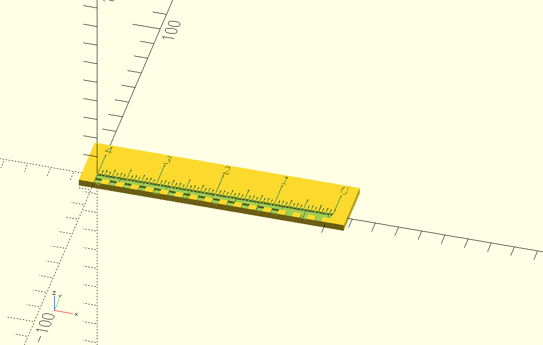

Please excuse a possibly/probably dumb question from a newbe.
I recently designed a 2D ruler for export to a CNC Router and & a Laser Engraver.  Worked well.
I then decided to emboss the pattern into a surface but get the following on render:
Rendering Polygon Mesh using Manifold...
WARNING: PolySet -> Manifold conversion failed: NotManifold
Trying to repair and reconstruct mesh..
Rendering cancelled on first warning.
How does one go about locating the cause of such?  The code follows:

Preview gives no errors and shows:

Fri, Dec 6, 2024 3:42 AM
I noticed a couple of Z-fighting-related preview artifacts related to
the larger tic marks at the front of the ruler.  (There was
straightforward Z-fighting at the very front, and a strange artifact
along their back end, where they meet the large recessed block.)  There
was also usual convexity issues associated with extruding a concave shape.
I fixed that by pulling them -Y by 1 and lengthening them by 2 to avoid
any coincident faces, and set convexity to 5, and that seems to have
fixed both the preview and the render.  My changes marked with //HERE...

I don't think issue 5135, at least as it pertains to BOSL2, is relevant.
The code example only uses BOSL2 for the INCH definition and the xcopies()
module, which just makes copies of the children.  It doesn't create any
polyhedra with duplicate points.

This might actually be a bug.
The symptom is that the result of linear_extrude() becomes non-manifold at some point, and any operation combined with that one fails.
If anyone is able to slim down this design to something non-BOSL and as small as possible, that would be immensely helpful.
-Marius

My forest idea of paring it down is to start at both ends and remove/diff
everything up to a point and check.  Once you find that it creates a proper
closed manifold, back up one step, and do the same from the other end.
This should leave you with a section of a part that is creating a
non-manifold.  Either that, or modify the original code to only make a
section (say 0-0.5, ... 3.75-4.0) and then you will only be dealing with
the generative portion of the code.
For now: 1. Turn off Preferences ->Advanced->OpenSCAD Language Features->Stop on first warning
  1. Follow https://github.com/openscad/openscad/issues/5135
-Marius

I’ve opened  a new issue for this so we can investigate it properly:
https://github.com/openscad/openscad/issues/5482
// Ruler-printable
Length = 4 ; //Overall length in Inches
Thick = 3 ;
len = Length*INCH ;
mk1 = 1.0*INCH ;
mk2 = mk1/2 ;
mk4 = mk1/4 ;
mk8 = mk1/8 ;
mk16 = mk1/16 ;
mk_width = 0.5 ;
t1 = mk1/2 ; // length of tic marks
t2 = t1/2 ;
t4 = t1/3 ;
t8 = t1/4 ;
t16 = t1/5 ;
spot = [mk1,mk2,mk4,mk8,mk16] ;
tic = [t1,t2,t4,t8,t16] ;
module mark(x) {
square([mk_width, x]) ;
sp = [0,0,0] ;
translate([-mk2/2,-6,-(Thick-1+0.01)]) cube([len+mk2,mk1,Thick]) ;
linear_extrude(height=1) union() {
fwd(3) square([len,3]) ;
for (idx=[0:1:Length]) {
xcopies(spot[idx], l=len, sp=sp) mark(tic[idx]) ;
xcopies(mk4,l=len-4, sp=[0,-6,0]) square(3) ;
translate([idx*mk1-1,14,0]) text(str(Length-idx), size=5 ) ;
