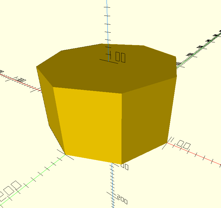

Creating "circles" with discrete number of sides is in my opinion not
the best idea. I would have extruded polygons for this purpose since you
then create the required geometry explicitly. I think geometry
specification and mesh discretization is best considered different things.
In AngelCAD you can easily create a polygon from a radius and n sides
and create a "cylinder" by extrusion:
linear_extrude(polygon(r:100,np:8),100);
this is equivalent to OpenSCAD
linear_extrude(100) {
	   circle(100,$fn=8);

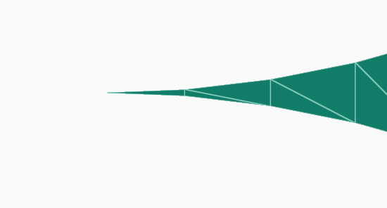

That doesn't explain everything. To simplify let us take the
following definition of fillet() which is equivalent to the original:
module fillet(r,h){
linear_extrude(h,convexity=4) round(r);
If we view the preview fillet(1.2,10) from the top with edges on and $fn=80
we get:
[image: wisker80.PNG]
So, the very tip of the fillet() base is formed by a reasonably fat
triangle and that should not be considered a non-manifold. However it is
rejected by F6 with an unusual error message when two disjoint fillets are
unioned with:
union(){
 //   linear_extrude(10,convexity=10)wall();
 //   translate ([-8,17,0])cube([8,10,10]);
    translate ([-1.5,17,0])fillet(1.2,10);
    translate ([-1.5,27,0])fillet(1.2,10);
BTW, the error message of F6 is not the usual non-manifold warning but
rather:
CGAL_Nef_Polyhedron., location unknown <0,>
UI-WARNING: No top level geometry to render location unknown <0,>
that I had never seen before. I got those results with RC3.

A further investigation shows that the original fillet() and round()
modules produce in fact non manifolds, not because the circles and
cylinders are touching but because the square (in round()) and the cube (in
fillet()) are a bit bigger than they should be. Ray West's model works fine
module fillet(r,h){
$fn=80 we get:
unioned with:

A further investigation shows that the original fillet() and round() modules produce in fact non manifolds, not because the circles and cylinders are touching but because the square (in round()) and the cube (in fillet()) are a bit bigger than they should be. Ray West's model works fine and render successfully with the redefinitions: module round(r){ difference(){ square(2*r /* + 0.001 */,true); translate([r,r]) circle(r); translate([-r,r]) circle(r); translate([r,-r]) circle(r); translate([-r,-r]) circle(r); } } module fillet(r,h){ difference() { translate([0,0,h/2]) cube([2*r /* + 0.001 */ , 2*r /* + 0.001 */ , h], center = true); translate([r, r, 0]) cylinder(h,r,r); translate([-r, r, 0]) cylinder(h,r,r); translate([-r, -r, 0]) cylinder(h,r,r); translate([r,- r, 0]) cylinder(h,r,r); } } With the redefinition of fillet() in my previous message I have solved part of the trouble but round() was kept as the original and the non-manifoldness was still present. Em ter., 2 de mar. de 2021 às 17:59, Ronaldo Persiano <rcmpersiano@gmail.com> escreveu: > > Em ter., 2 de mar. de 2021 às 14:29, Hans L <thehans@gmail.com> escreveu: > >> The circles in your "round" module are touching at single points, which >> is not manifold. >> > > That doesn't explain everything. To simplify let us take the > following definition of fillet() which is equivalent to the original: > > module fillet(r,h){ > linear_extrude(h,convexity=4) round(r); > } > > > If we view the preview fillet(1.2,10) from the top with edges on and > $fn=80 we get: > [image: wisker80.PNG] > So, the very tip of the fillet() base is formed by a reasonably fat > triangle and that should not be considered a non-manifold. However it is > rejected by F6 with an unusual error message when two disjoint fillets are > unioned with: > > union(){ > // linear_extrude(10,convexity=10)wall(); > // translate ([-8,17,0])cube([8,10,10]); > translate ([-1.5,17,0])fillet(1.2,10); > translate ([-1.5,27,0])fillet(1.2,10); > } > > > BTW, the error message of F6 is not the usual non-manifold warning but > rather: > > Rendering Polygon Mesh using CGAL... > > ERROR: The given mesh is not closed! Unable to convert to > CGAL_Nef_Polyhedron., location unknown <http://0,> > > ERROR: The given mesh is not closed! Unable to convert to > CGAL_Nef_Polyhedron., location unknown <http://0,> > > UI-WARNING: No top level geometry to render location unknown <http://0,> > > that I had never seen before. I got those results with RC3. >
