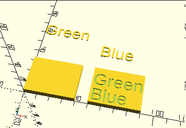

Volumetric color/material
Tue, Feb 8, 2022 6:52 AM
One of the areas where OpenSCAD is weak is in multicolor / multimaterial
support.  (In a lot of ways the two are the same problem, so I use
"color" and "material" almost interchangeably.)
OpenSCAD's native color support is for preview only; it does not affect
the exported files at all and so cannot directly drive multimaterial
printers.  It is certainly possible to roll your own support, generating
multiple STL files for the different materials, but that's not very
user-friendly.
I have long wondered how possible it would be to teach OpenSCAD to have
true multi-material support, so that you would write a straightforward
OpenSCAD program that would include markup for what material each
component is to be made of.  The boolean operators, and in particular
union, would need to learn more complex rules that would track the
material through the various operations that are applied to the model.
Union is the most interesting.  When I mentioned this a while back,
somebody suggested using the same model that a 2D paint program uses:
the last paint wins.  If you paint something red, and then you paint
over it with blue, it's blue.  OK, that's as reasonable a mental model
as any.  Using arithmetic notation, if you union two objects A and B,
the result is A-B colored like A, and B colored like B.
Intersection is a bit interesting; the resulting object is the volume in
common between the two inputs, so which one should win?  Again, "last
paint wins" seems like an OK answer; the result is a normal intersection
that ignores the first object's colors and retains the second object's
colors.
Difference is easy, since only one input actually supplies material.
I've been thinking of trying to implement this in OpenSCAD proper, and
that's where it belongs, but it's a lot of work.  It occurred to me the
other day that it might be practical to build something in OpenSCAD
"user space" that would have the same basic behavior, that could be used
to play with it.
So I did.  It seems to mostly work, though it's affected by some preview
artifacts that make the colors wrong in some cases.
As everybody knows, there's no way to inspect the OpenSCAD model as you
create it, so I couldn't operate directly on OpenSCAD constructs.
Instead, I build up my own CSG tree, with my own operators, and then
after the model is ready I evaluate it and execute the underlying
OpenSCAD operators.
Here's a program using it:
c1 = cube([10,10,10], "red");
c2 = translate([5,5,5], cube([10,10,10], "blue"));
eval(union([c1, c2]));
Remembering the "last paint wins" rule, this sequence generates a red
cube with a notch cut out of it, and a blue cube.
As shown, it's unexciting:

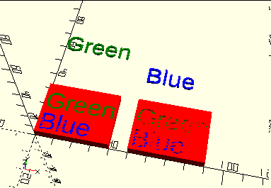

It gets more interesting if you set $color="red":
I haven't done it, but since it knows the color of the components and
has a function to report the list of colors used, it would be
straightforward to wrap a script around OpenSCAD invocations that would
retrieve the list of colors and then invoke OpenSCAD multiple times to
generate one STL for each color.

Here's an example.  Intersection and difference are left as an exercise
for the reader.
module Color(color) {
    if (is_undef($color) || $color == color) {
        color(color) children();
module Union() {
    // More than two children is left as an exercise for the reader.
    assert($children == 2);
            children(0);
            children(1, $color=undef);
        children(1);
module m() {
    Union() {
        Union() {
            Color("red") cube([40,30,5]);
            Color("blue") translate([1,2,4]) linear_extrude(height=1) text("Blue");
        Color("green") translate([1,15,4]) linear_extrude(height=1) text("Green");
translate([0,0,0]) m();
translate([50,0,0]) m($color="red");
translate([0,40,0]) m($color="green");
translate([50,40,0]) m($color="blue");
Previews as (notice the Z-fighting):
Renders as:
