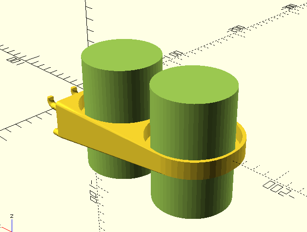

I am having an issue where a part will preview satisfactorily but renders
incorrectly. It has similarities to this issue:
https://github.com/openscad/openscad/issues/1591
I have tried on two different Dell PCs, one Optiplex 7010 and the other a
Latitude E6530. Both have Intel HD Graphics 4000 cards. I am using the most
up to date graphics drivers I can get to install.
I have tried using both these versions:
OpenSCAD version 2015.03-2
OpenSCAD version 2018.09.05 (git 40af343)
Reading the above issue I have tried with and without the "Force Goldfeather
setting having no success either way with either version
I have attached the files needed to replicate the issue:
Modify.scad http://forum.openscad.org/file/t1222/Modify.scad
Holder_re-rendered_using_OpenSCAD.stl
http://forum.openscad.org/file/t1222/Holder_re-rendered_using_OpenSCAD.stl
Holder_as_rendered.stl
http://forum.openscad.org/file/t1222/Holder_as_rendered.stl

Any ideas on what I could try?
I am having an issue where a part will preview satisfactorily but renders incorrectly. It has similarities to this issue: https://github.com/openscad/openscad/issues/1591 I have tried on two different Dell PCs, one Optiplex 7010 and the other a Latitude E6530. Both have Intel HD Graphics 4000 cards. I am using the most up to date graphics drivers I can get to install. I have tried using both these versions: OpenSCAD version 2015.03-2 OpenSCAD version 2018.09.05 (git 40af343) Reading the above issue I have tried with and without the "Force Goldfeather setting having no success either way with either version I have attached the files needed to replicate the issue: Modify.scad <http://forum.openscad.org/file/t1222/Modify.scad> Holder_re-rendered_using_OpenSCAD.stl <http://forum.openscad.org/file/t1222/Holder_re-rendered_using_OpenSCAD.stl> Holder_as_rendered.stl <http://forum.openscad.org/file/t1222/Holder_as_rendered.stl> Here is the library info for the OPtiplex 7010 using OpenSCAD version 2018.09.05 (git 40af343) : OpenSCAD Version: 2018.09.05 (git 40af343) System information: Windows(TM) 10.0 SP 0.0 NTW 1 MSDN 724833 4 CPUs 3.89 GB RAM Compiler: GCC "7.3.0" 64bit Boost version: 1_60 Eigen version: 3.2.5 CGAL version, kernels: 4.11, Cartesian, Extended_cartesian, Epeck OpenCSG version: OpenCSG 1.4.2 Qt version: 5.11.1 QScintilla version: 2.10.4 MingW build: MingW64 GLib version: 2.50.2 libzip version: 1.5.1 Application Path: C:/Program Files/OpenSCAD Documents Path: C:\Users\Andy\Documents Resource Path: C:/Program Files/OpenSCAD User Library Path: C:/Users/Andy/Documents/OpenSCAD/libraries User Config Path: C:\Users\Andy\AppData\Local/OpenSCAD Backup Path: C:/Users/Andy/Documents/OpenSCAD/backups OPENSCADPATH: OpenSCAD library path: C:/Users/Andy/Documents/OpenSCAD/libraries C:/Program Files/OpenSCAD\libraries OPENSCAD_FONT_PATH: OpenSCAD font path: GLEW version: 1.12.0 OpenGL Version: 4.0.0 - Build 10.18.10.4885 GL Renderer: Intel(R) HD Graphics 4000 GL Vendor: Intel RGBA(8888), depth(24), stencil(8) GL_ARB_framebuffer_object: yes GL_EXT_framebuffer_object: yes GL_EXT_packed_depth_stencil: yes Qt graphics widget: QGLWidgetGL Extensions: GL_3DFX_texture_compression_FXT1 GL_ARB_ES2_compatibility GL_ARB_ES3_compatibility GL_ARB_arrays_of_arrays GL_ARB_base_instance GL_ARB_blend_func_extended GL_ARB_buffer_storage GL_ARB_color_buffer_float GL_ARB_compatibility GL_ARB_compressed_texture_pixel_storage GL_ARB_conservative_depth GL_ARB_copy_buffer GL_ARB_debug_output GL_ARB_depth_buffer_float GL_ARB_depth_clamp GL_ARB_depth_texture GL_ARB_draw_buffers GL_ARB_draw_buffers_blend GL_ARB_draw_elements_base_vertex GL_ARB_draw_indirect GL_ARB_draw_instanced GL_ARB_explicit_attrib_location GL_ARB_fragment_coord_conventions GL_ARB_fragment_program GL_ARB_fragment_program_shadow GL_ARB_fragment_shader GL_ARB_framebuffer_no_attachments GL_ARB_framebuffer_object GL_ARB_framebuffer_sRGB GL_ARB_geometry_shader4 GL_ARB_get_program_binary GL_ARB_gpu_shader5 GL_ARB_gpu_shader_fp64 GL_ARB_half_float_pixel GL_ARB_half_float_vertex GL_ARB_instanced_arrays GL_ARB_internalformat_query GL_ARB_internalformat_query2 GL_ARB_map_buffer_alignment GL_ARB_map_buffer_range GL_ARB_multi_draw_indirect GL_ARB_multisample GL_ARB_multitexture GL_ARB_occlusion_query GL_ARB_occlusion_query2 GL_ARB_pixel_buffer_object GL_ARB_point_parameters GL_ARB_point_sprite GL_ARB_program_interface_query GL_ARB_provoking_vertex GL_ARB_robustness GL_ARB_sample_shading GL_ARB_sampler_objects GL_ARB_seamless_cube_map GL_ARB_separate_shader_objects GL_ARB_shader_atomic_counters GL_ARB_shader_bit_encoding GL_ARB_shader_objects GL_ARB_shader_precision GL_ARB_shader_subroutine GL_ARB_shading_language_100 GL_ARB_shading_language_420pack GL_ARB_shading_language_packing GL_ARB_shadow GL_ARB_stencil_texturing GL_ARB_sync GL_ARB_tessellation_shader GL_ARB_texture_border_clamp GL_ARB_texture_buffer_object_rgb32 GL_ARB_texture_buffer_range GL_ARB_texture_compression GL_ARB_texture_compression_bptc GL_ARB_texture_compression_rgtc GL_ARB_texture_cube_map GL_ARB_texture_cube_map_array GL_ARB_texture_env_add GL_ARB_texture_env_combine GL_ARB_texture_env_crossbar GL_ARB_texture_env_dot3 GL_ARB_texture_float GL_ARB_texture_gather GL_ARB_texture_multisample GL_ARB_texture_non_power_of_two GL_ARB_texture_query_lod GL_ARB_texture_rectangle GL_ARB_texture_rg GL_ARB_texture_rgb10_a2ui GL_ARB_texture_storage GL_ARB_texture_storage_multisample GL_ARB_texture_swizzle GL_ARB_timer_query GL_ARB_transform_feedback2 GL_ARB_transform_feedback3 GL_ARB_transform_feedback_instanced GL_ARB_transpose_matrix GL_ARB_uniform_buffer_object GL_ARB_vertex_array_bgra GL_ARB_vertex_array_object GL_ARB_vertex_attrib_64bit GL_ARB_vertex_attrib_binding GL_ARB_vertex_buffer_object GL_ARB_vertex_program GL_ARB_vertex_shader GL_ARB_vertex_type_2_10_10_10_rev GL_ARB_viewport_array GL_ARB_window_pos GL_ATI_separate_stencil GL_EXT_abgr GL_EXT_bgra GL_EXT_blend_color GL_EXT_blend_equation_separate GL_EXT_blend_func_separate GL_EXT_blend_minmax GL_EXT_blend_subtract GL_EXT_clip_volume_hint GL_EXT_compiled_vertex_array GL_EXT_draw_buffers2 GL_EXT_draw_range_elements GL_EXT_fog_coord GL_EXT_framebuffer_blit GL_EXT_framebuffer_multisample GL_EXT_framebuffer_object GL_EXT_geometry_shader4 GL_EXT_gpu_program_parameters GL_EXT_gpu_shader4 GL_EXT_multi_draw_arrays GL_EXT_packed_depth_stencil GL_EXT_packed_float GL_EXT_packed_pixels GL_EXT_rescale_normal GL_EXT_secondary_color GL_EXT_separate_specular_color GL_EXT_shader_integer_mix GL_EXT_shadow_funcs GL_EXT_stencil_two_side GL_EXT_stencil_wrap GL_EXT_texture3D GL_EXT_texture_array GL_EXT_texture_buffer GL_EXT_texture_compression_s3tc GL_EXT_texture_edge_clamp GL_EXT_texture_env_add GL_EXT_texture_env_combine GL_EXT_texture_filter_anisotropic GL_EXT_texture_integer GL_EXT_texture_lod_bias GL_EXT_texture_rectangle GL_EXT_texture_sRGB GL_EXT_texture_sRGB_decode GL_EXT_texture_shared_exponent GL_EXT_texture_snorm GL_EXT_texture_storage GL_EXT_texture_swizzle GL_EXT_transform_feedback GL_IBM_texture_mirrored_repeat GL_INTEL_map_texture GL_INTEL_performance_queries GL_INTEL_performance_query GL_KHR_blend_equation_advanced GL_KHR_debug GL_NV_blend_square GL_NV_conditional_render GL_NV_primitive_restart GL_NV_texgen_reflection GL_SGIS_generate_mipmap GL_SGIS_texture_edge_clamp GL_SGIS_texture_lod GL_SUN_multi_draw_arrays GL_WIN_swap_hint WGL_ARB_buffer_region WGL_ARB_create_context WGL_ARB_create_context_profile WGL_ARB_create_context_robustness WGL_ARB_extensions_string WGL_ARB_framebuffer_sRGB WGL_ARB_make_current_read WGL_ARB_multisample WGL_ARB_pbuffer WGL_ARB_pixel_format WGL_ARB_pixel_format_float WGL_EXT_create_context_es2_profile WGL_EXT_create_context_es_profile WGL_EXT_depth_float WGL_EXT_extensions_string WGL_EXT_pixel_format_packed_float WGL_EXT_swap_control WGL_EXT_swap_control_tear WGL_NV_DX_interop Any ideas on what I could try? -- Sent from: http://forum.openscad.org/
Tue, Oct 2, 2018 11:55 AM
Yes it does seem to be a bug. Preview is correct. The render includes the
negative objects and so does the exported STL, which is then not manifold
according to NetFabb.
I can't find anything wrong with the original STL but it seems to confuse
GGAL.
Even weirder things happen if I union the STL with large cube([400,100,
20], center = true) in MyImport();
Then the cube gets subtracted and the cylinders added. It's like difference
is working backwards. I wonder if the original  STL is inside out and
NetFabb doesn't tell me?

I do not know why it works, but if you rotate the imported STL file 180°
about the X axis, it renders correctly.  At least it works on my version
2015.03.2 ?????
http://forum.openscad.org/file/t1309/holder.jpg

Experimentalist wrote
It renders correctly?
Yes.  If you look at the picture I posted, you will see "Rendering finished"
at the bottom.  Also note the orientation of the X-Y-Z axis.  I rotated the
rendering so that it appears "right side up".
