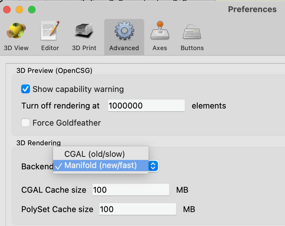

Hi all,
Since a few people got surprised by this:
Since 2024.09.28, the Manifold geometry backend is no longer experimental: It’s now possible to choose between the two geometry backends in Preferences->Advanced->3D Rendering->Backend (see attached screenshot).
The old way of enabling Manifold (using Features) is no longer available.
For cmd-line usage: openscad --backend=manifold
CGAL is (for the time being) still the default backend.
Thanks to ochafik for spearheading this, and to the Manifold team for being very supportive and engaging actively with the OpenSCAD community!
Kind Regards,
-Marius
