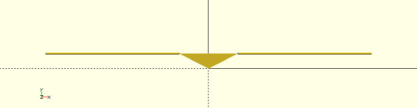

Bezier curves get longer, the more they are bent. This is contrary to what happens in the real world somewhere out there.
Is there a parameter that can be set to obtain a fixed length instead of fixed ends?
Or is there an echo(); that returns the true length of a Bezier curve, from which a correction could be calculated?

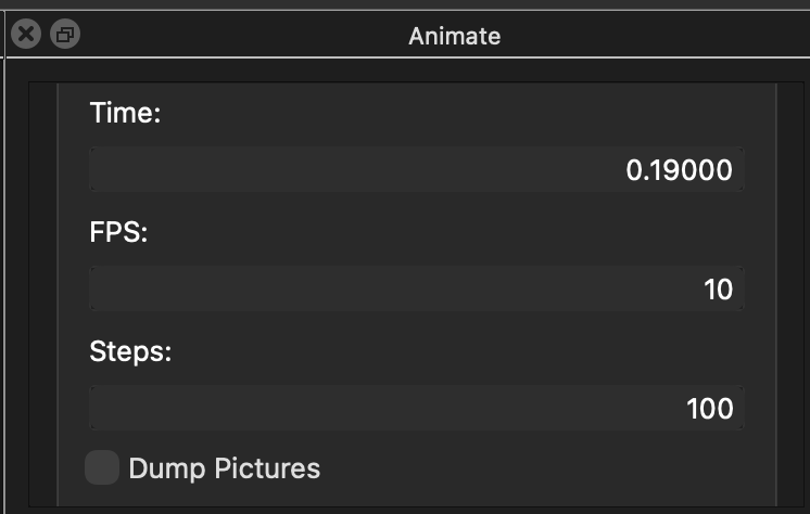

The animation shows what I am looking for: the free ends move back and forth because I incorporated a fudge in the code.

I don't really understand your problem because you don't say what information is changing about the bezier. You want length to stay fixed while what is varying? However, I do note that even just calculating the length of a bezier has no closed form solution, which means it's going to be impossible to control the length with a parameter in a simple fashion. On Tue, Apr 14, 2026 at 11:47 PM Caddiy via Discuss < discuss@lists.openscad.org> wrote: > Bezier curves get longer, the more they are bent. This is contrary to what > happens in the real world somewhere out there. > > Is there a parameter that can be set to obtain a fixed length instead of > fixed ends? > > Or is there an echo(); that returns the true length of a Bezier curve, > from which a correction could be calculated? > > The animation shows what I am looking for: the free ends move back and > forth because I incorporated a fudge in the code. > _______________________________________________ > OpenSCAD mailing list > To unsubscribe send an email to discuss-leave@lists.openscad.org

If you bend a strip of flexible material, that brings the ends closer together, but the strip stays the same length. With Bezier curves, it’s the other way round: the ends stay put and the length increases. I am looking for realistic behaviour. The animation shows the outer ends of the Beziers being pulled in as the curvature increases, which is what I want, but the distance they are pulled in is only a guess. How much should it be?

There is no way to “bend” a bezier like a physical string.  If you just
want to take a sequence of beziers and extract a sub curve that is the same
length that could be done. Your problem is not well defined because you
have not explained how you are varying the control points. Or how you want
to vary them.
You can compute the length of a bezier just not on closed form. To be able
to have a settable length parameter you would need a closed form expression
for length you could solve.
BOSL2 provides bezier_length() and you could write a recursive function
that would find the u span to approximate a desired length.  You could
measure the length and scale the curve shorter to the desired length. You
could put the end control points very far from the others and then move
them inward to shorten it.
The result may have constant length but still won’t reflect actual movement
of a string.  Getting that right would require solving an appropriate set
of differential equations.

I have written it in python where the length as per my calculation remains
constant till 2 decimal digits.
In this one end of the rope is fixed and the other end moves.
To do this in openscad, as per me the idea is to superimpose a line on a
bezier curve, based on the length of the line.
to run the below python code, you need to import the library openscad4.py
from my github page:
https://github.com/sprabhakar2006/openSCAD
but it is definitely a tricky problem to solve.
Attached in the scad file and the python code is below:
from openscad4 import *
cpnt=cytz(m_points1_o(cr2dt([[0,0],[10,5],[20,-10],[10,5]]),4))
cpnt1=mirror_line(cpnt,[0,0,1],[0,0,0])
bcur=bezier(cpnt,50)
bcur1=bezier(cpnt1,50)
bcur2=slice_sol([bcur,bcur1],11)
l1=m_points1_o([[0,0.01],[0,39.9]],40)
l2=[wrap_around(l1,p) for p in bcur2]
lx=[l_lenv_o(p) for p in l2]
fo(f'''
color("cyan") for(p=[l2[abs(round(10sin($t360)))]])p_line3d(p,.2);
color("magenta") translate([3,1,5])rotate([90,0,0])linear_extrude(0.05)
text(str("line_length : ",lx[abs(round(10sin($t360)))]),2);
l2={l2};
lx={lx};
use following parameters for animation:
[image: Screenshot 2026-04-15 at 7.26.37 PM.png]
