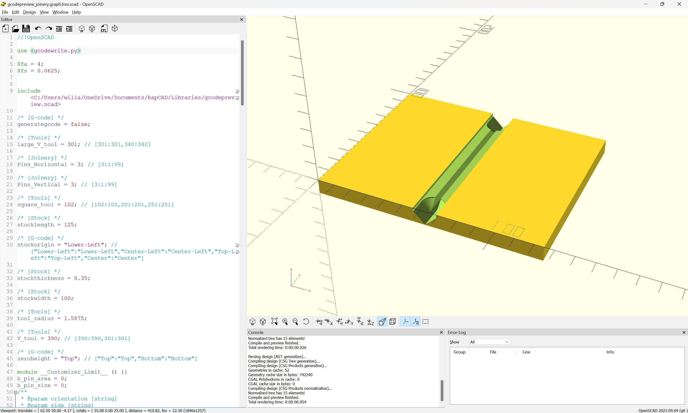

Well, it mostly seems to have been much easier than I'd thought it would be:
RapCAD has a command, "writeln" which takes a variable number of arguments and writes them out on a line --- this was easily done using a def'd function:
def writeln(*arguments):    line_to_write = ""    for number in arguments:        line_to_write += number    f.write(line_to_write)
save that to a file: gcodewrite.py
and use it with commands such as:
writeln("G0 X",str(w),"Y",str(d),"Z",str(h))
Which just leaves importing that, and opening/naming the file:
use < gcodewrite.py>
fn = "gcode.nc" f = open(fn, "w")
which seems simple enough, but I'd like to work up a way to wrap that in an if/then in an OpenSCAD file --- the obvious:
if (usepython == true) {use <gcodewrite.py>};
triggers the error:
ERROR: Parser error: syntax error in file gcodepreviewing.scad, line 3
Execution aborted
So, is there a way to conditionally execute such a command in an elegant fashion? I'm about to stuff it into a module, but I don't like that conceptually.

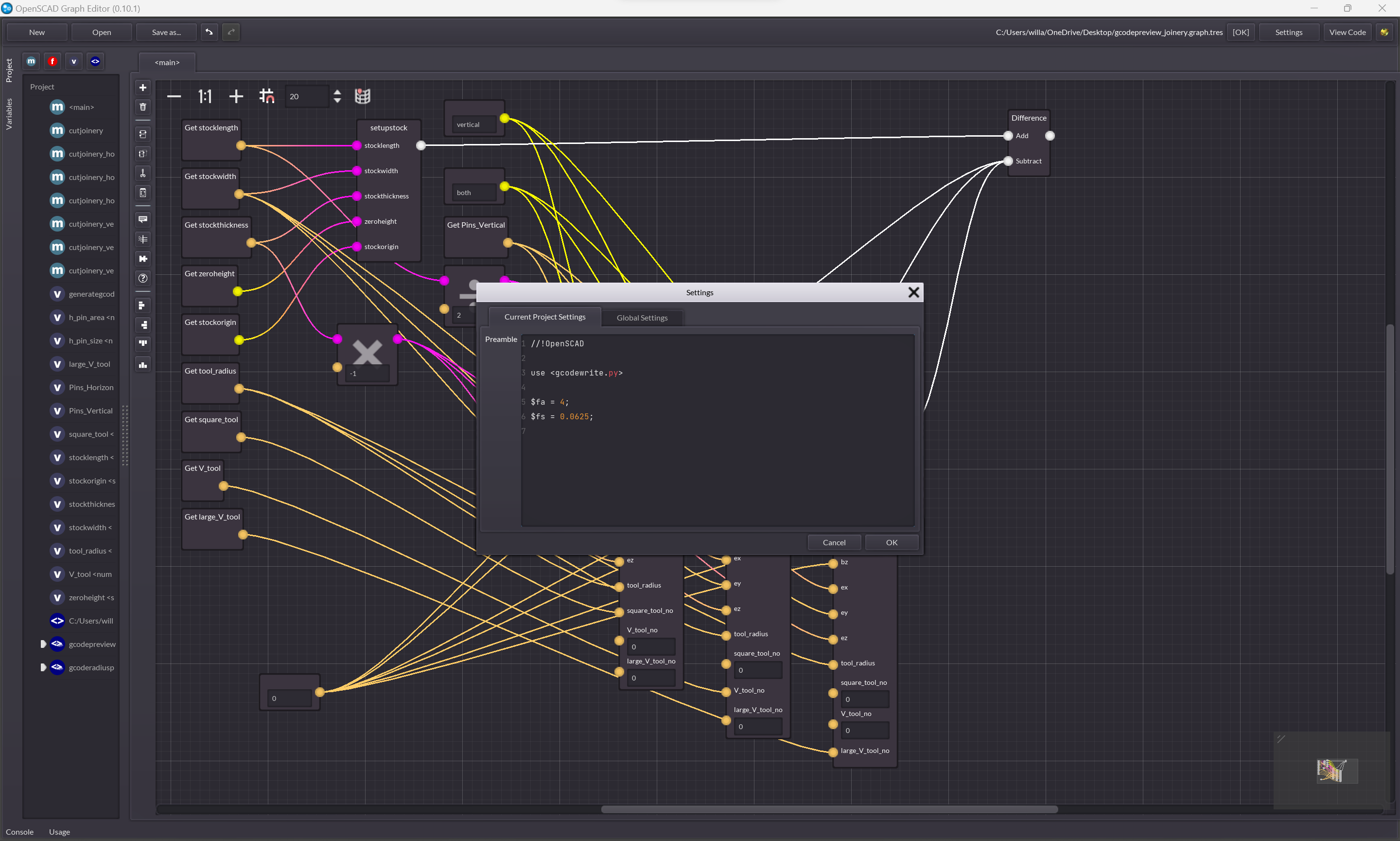

Slight adjustments:
file: "C:\Users\willa\OneDrive\Documents\OpenSCAD\libraries\gcodewrite.py"
Not wild about hard-coding the filename, but it works.
In OpenSCAD Graph Editor under "Current Project Settings we make the preamble to be:
//!OpenSCAD
use <gcodewrite.py>
$fa = 4;$fs = 0.0625;
and we launch the Python-enabled version of OpenSCAD having it set to trust all Python files (yes, I know it'll be my fault if someone takes advantage of that, or if I manage to write a program which trashes my system --- that's what backups are for).
I hope that Python support in OpenSCAD will be adjusted to make all this easier --- in particular, I'd like to be able to check a variable and based on it, use or not use the .py file in an OpenSCAD file.
Anyway, we're off to the races!

Unfortunately, it seems that it isn't possible to call the defined writeln function as written from OpenSCAD, so this will have to wait for either an updating of the Python sub-system in OpenSCAD, or the Python sub-system supporting the Customizer which would then allow me to re-write the entire thing in Python.
Couldn't tell before because I hadn't toggled the "generategcode" Boolean --- when I did, OpenSCAD crashed, I suspect because of an endless report of errors at not being able to call the module.
All I want to do is write out text and variables as numbers from OpenSCAD modules --- why is this so hard?
