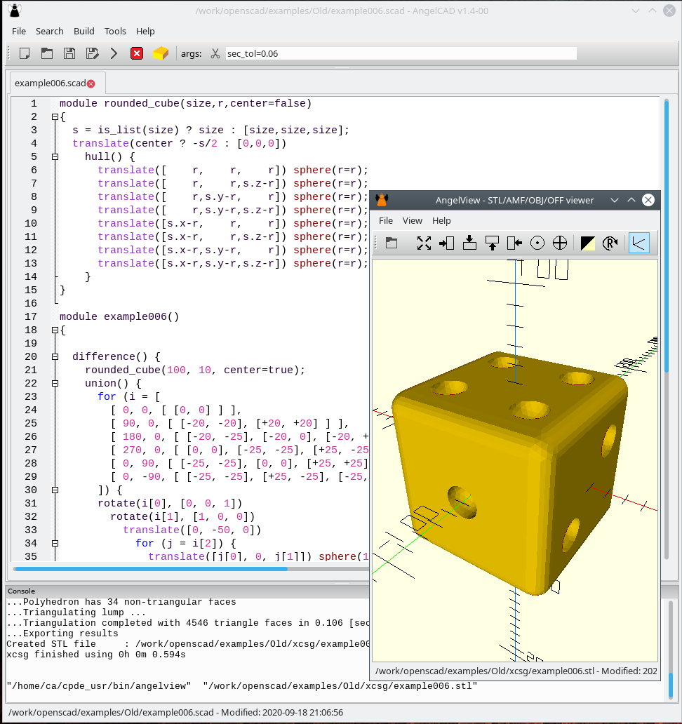

The upcoming version of AngelCAD will be able to run OpenSCAD scripts
(with some limitations) if OpenSCAD is installed on the computer.
OpenSCAD is used for parsing the .scad script (without using the slow
CGAL) to .csg format, and then the booleans will be executed in
AngelCADs xcsg.
Carsten Arholm

Mon, Nov 16, 2020 1:49 PM
This feature is now available, details at
https://forum.abmesh.com/index.php?topic=70.0
