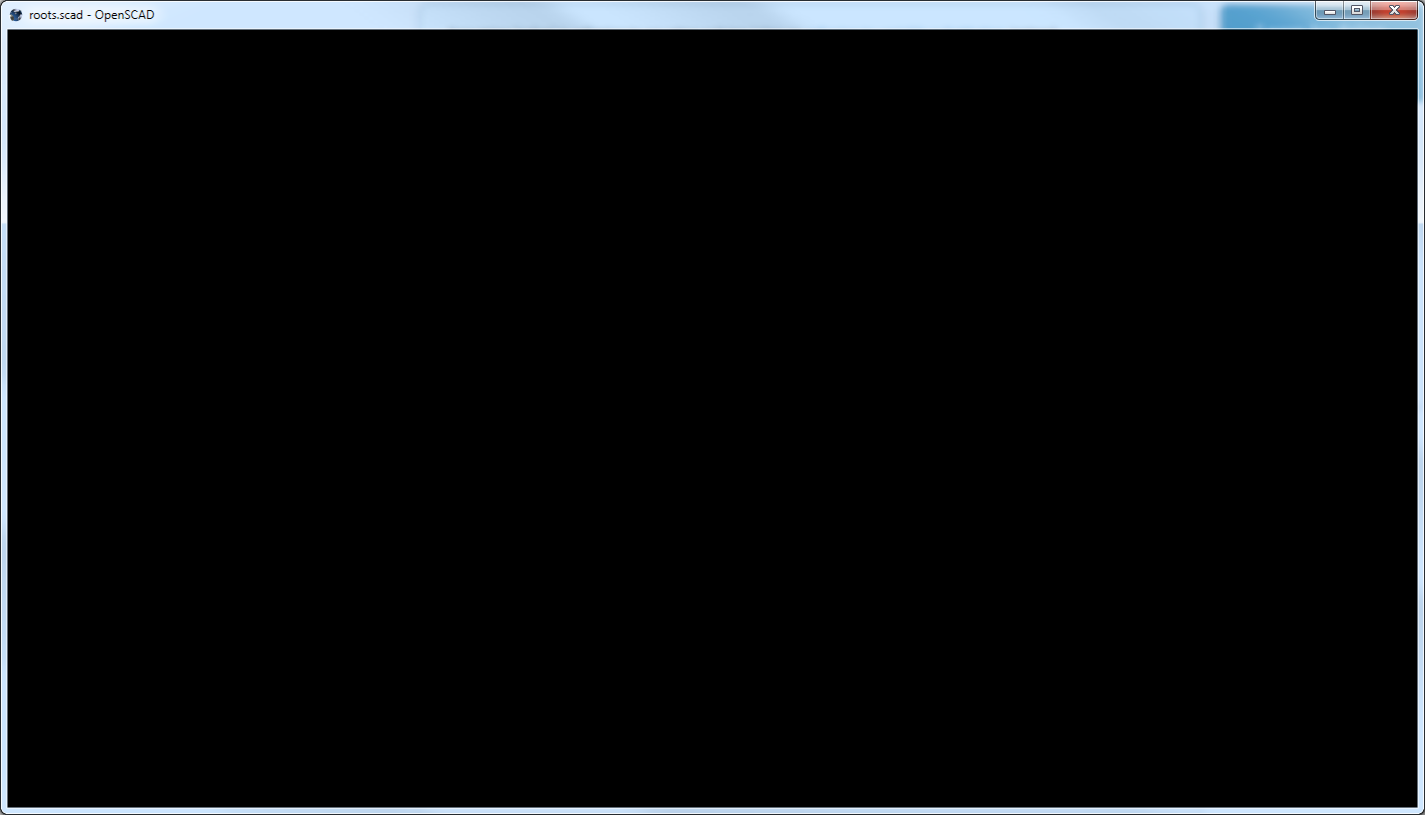

Even stranger for me, I just get a black window. Looks like the right click
to see the code that makes the cube is going wrong.

Even stranger for me, I just get a black window. Looks like the right click to see the code that makes the cube is going wrong. [image: image.png] On Thu, 1 Apr 2021 at 02:30, Ronaldo Persiano <rcmpersiano@gmail.com> wrote: > In the last OpenSCAD release, draw a cube, select View/Thrown together and > click the cube with the right button. Click again. The cube goes red and > the only way I am able to recover is by View/Preview. Also, View/Wireframe > and View/Surfaces don't work. > _______________________________________________ > OpenSCAD mailing list > To unsubscribe send an email to discuss-leave@lists.openscad.org >

I haven't got any menus but I can get the view menu with Alt+V but view all
is then Ctrl+Shift+V and that does not work.  I can arrow down to it and
select it but I still have an all black window.
I think this is a separate bug because I don't need to be in thrown
together mode. Just a right click on the cube with another Microsoft
Mouse that has switch bounce on the right button. It shows the one line
stack trace over an all black window and I haven't found a way to recover.
OpenSCAD 2021.03.24.ci7656 on Win7 / 64.

To be clear, it isn't a black object filling the preview window, it is the
whole main window pane that goes black.

This Black / Red thingi might be a side effect of the mouse selection,
triggered by the right click.
The selector is drawing into a separate background buffer. Unfortunately
I cannot reproduce this behaviour on master on my machine.
The ID of the object is encoded into the color, whereby object 1-255 are
encoded in different shades of red, 0 (black) is the background.
This might be a bug in the combination of thrown-together/selection, it
looks like the framebuffer selection is somehow broken.
I will look into this as soon as I can make room in my schedule!
