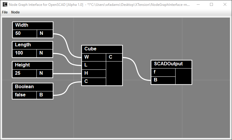

Okay, managed to puzzle things out. Quick start:
  • install Java
  • double-click on the .jar file:
    NodeGraphInterface-master\dist\NodeGraphInterface.jar
  • right-click to create nodes (e.g., Node | Geometry | Cube)
  • output is handled by the object Node | Output | SCADOutput ---
    right-click on the "f" to get a file dialog which will allow you to send
    the output to a .scad file which OpenSCAD will open
One thing which seems a bit odd to me is that everything collapses to the
most concise possible expression, and no structure is preserved, so the
graph:
[image: Capture.PNG]
is presented as:
cube([50, 100, 25], center = false );
It would be much more useful for my purposes if the parameter values and
names were preserved and presented at the top of the file so that they
would work in the Customizer in OpenSCAD. c.f., https://www.blockscad3d.com/
I can definitely see myself using it to work up code to include in modules
in other projects.

Okay, managed to puzzle things out. Quick start: - install Java - double-click on the .jar file: NodeGraphInterface-master\dist\NodeGraphInterface.jar - right-click to create nodes (e.g., Node | Geometry | Cube) - output is handled by the object Node | Output | SCADOutput --- right-click on the "f" to get a file dialog which will allow you to send the output to a .scad file which OpenSCAD will open One thing which seems a bit odd to me is that everything collapses to the most concise possible expression, and no structure is preserved, so the graph: [image: Capture.PNG] is presented as: cube([50, 100, 25], center = false ); It would be much more useful for my purposes if the parameter values and names were preserved and presented at the top of the file so that they would work in the Customizer in OpenSCAD. c.f., https://www.blockscad3d.com/ I can definitely see myself using it to work up code to include in modules in other projects. William On Mon, Apr 22, 2019 at 3:19 PM William Adams <will.adams@frycomm.com> wrote: > My apologies, managed to find: > > NodeGraphInterface-master\dist\NodeGraphInterface.jar > > and > README.TXT > > > > > On Mon, Apr 22, 2019 at 2:43 PM William Adams <will.adams@frycomm.com> > wrote: > >> What I meant by language was taking this software and having it support >> something else in addition to OpenSCAD, say METAPOST. >> >> How would one begin using it? Do you have to download NetBeans? Is there >> some command line command to either compile things or get them started? >> >> William >> >> >> On Mon, Apr 22, 2019 at 2:04 PM Tom Copple <studio.tom.copple@gmail.com> >> wrote: >> >>> No, I wanted a UI project for myself. Half the fun was working that out. >>> >>> On Mon, Apr 22, 2019 at 6:31 AM William Adams <will.adams@frycomm.com> >>> wrote: >>> >>>> Also, did you consider implementing this using an existing tool? >>>> >>>> Blockly seems a likely option, or Drakon? >>>> >>>> William >>>> >>>> https://developers.google.com/blockly/ >>>> http://drakon-editor.sourceforge.net/ >>>> >>>> >>>> On Mon, Apr 22, 2019 at 8:28 AM William Adams <will.adams@frycomm.com> >>>> wrote: >>>> >>>>> How does this compare to: >>>>> >>>>> https://graphscad.blogspot.com/ >>>>> >>>>> If one puts together a file and then opens it in OpenSCAD would the >>>>> Customizer work as expected? (that's the major failing in graphscad for me >>>>> at the moment) >>>>> >>>>> Could this be adopted to other languages? >>>>> >>>>> As a naïve user not accustomed to working with Java source, how would >>>>> one start with this? >>>>> >>>>> I've downloaded it and found \NodeGraphInterface-master\build.xml --- >>>>> a brief search indicates this is usually an ant build script? Is that the >>>>> case here? >>>>> >>>>> >>>>> William >>>>> >>>>> On Sat, Apr 20, 2019 at 7:01 PM Kevin Toppenberg <kdtop3@gmail.com> >>>>> wrote: >>>>> >>>>>> This is very cool Anything that can appeal to more persons is a good >>>>>> thing. >>>>>> >>>>>> But for me, already being comfortable with the typing aspect, the >>>>>> node interface looks intimidating! :-) >>>>>> >>>>>> Thanks >>>>>> Kevin >>>>>> >>>>>> On Sat, Apr 20, 2019 at 1:58 PM Tom Copple < >>>>>> studio.tom.copple@gmail.com> wrote: >>>>>> >>>>>>> Hi, >>>>>>> I made a Node Graph Interface for OpenSCAD as a hobby project >>>>>>> (written in Java). I have it working the way I imagined and thought I'd >>>>>>> throw it out into the wild. The concept was to make Nodes that are >>>>>>> elemental parts of the language. There are Nodes for atomic parts like >>>>>>> numbers and variables and Nodes for typical statements like sphere, >>>>>>> translate, union, etc... It doesn't cover the complete language, but there >>>>>>> is a "hack" for the rest. The README.md at the project page should get you >>>>>>> started. >>>>>>> >>>>>>> Project Source: >>>>>>> https://github.com/studiotc/NodeGraphInterface >>>>>>> >>>>>>> You can pull the jar file from here: >>>>>>> https://github.com/studiotc/NodeGraphInterface/tree/master/dist >>>>>>> >>>>>>> I started this project after reading a Hackaday article about >>>>>>> choosing CAD software. OpenSCAD got mentions in the comments, but I think >>>>>>> people are intimidated by the typing part... Like others, I have always >>>>>>> wanted CAD on Linux and have looked into OpenSCAD (I'm only a windows >>>>>>> person because I'm a Rhino user & ex AutoDesk user). So, the thought >>>>>>> struck me: what would a Node Graph interface like Rhino's Grasshopper or >>>>>>> Maya's Shader Network look like in OpenSCAD? This was my musing on that >>>>>>> thought... >>>>>>> >>>>>>> Cheers, >>>>>>> Tom >>>>>>> _______________________________________________ >>>>>>> OpenSCAD mailing list >>>>>>> Discuss@lists.openscad.org >>>>>>> http://lists.openscad.org/mailman/listinfo/discuss_lists.openscad.org >>>>>>> >>>>>> _______________________________________________ >>>>>> OpenSCAD mailing list >>>>>> Discuss@lists.openscad.org >>>>>> http://lists.openscad.org/mailman/listinfo/discuss_lists.openscad.org >>>>>> >>>>> _______________________________________________ >>>> OpenSCAD mailing list >>>> Discuss@lists.openscad.org >>>> http://lists.openscad.org/mailman/listinfo/discuss_lists.openscad.org >>>> >>> _______________________________________________ >>> OpenSCAD mailing list >>> Discuss@lists.openscad.org >>> http://lists.openscad.org/mailman/listinfo/discuss_lists.openscad.org >>> >>

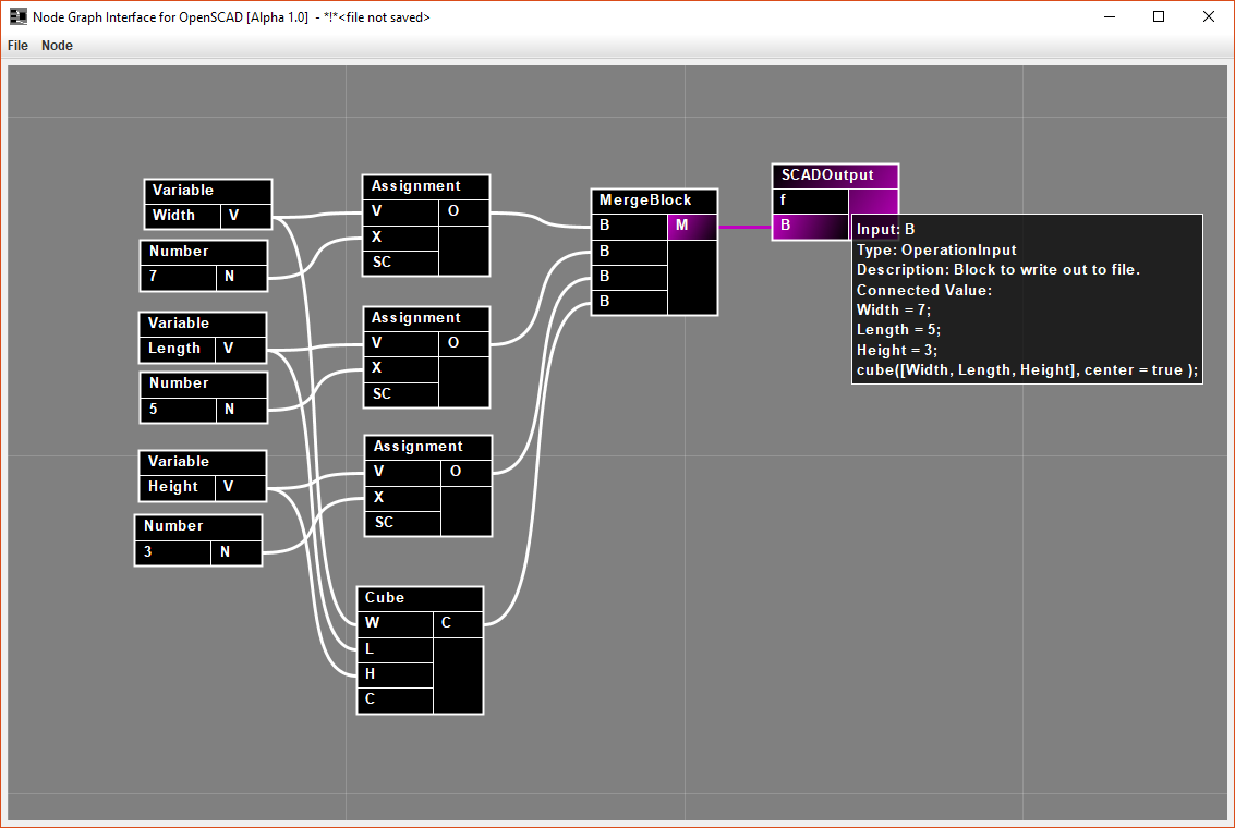

Oh, I think all you want to do is explicitly declare variables - just a few
extra nodes... :)
The attached image produces this:
Width = 7;
Length = 5;
Height = 3;
cube([Width, Length, Height], center = true );
HTH,

Thank you!
I see how that works, and I think I can grasp the logic of it, but it's not
something I ever would've worked up from playing with the interface --- is
there way to combine the Variable/Assignment/MergeBlock into a single node
(which ideally also shows the value as I had in my previous example? I see
that you can add a 4th Node for a Number to expose that value, but that
gets even more spread out.

I think this is as good as it gets for what you are trying to do. I'm not
sure what you are describing when you want to combine  the nodes (you are
still going to need to tie into a MergeBlock if you need generate multiple
lines of code).  They are all separate for a reason and used for different
contexts, i.e.: Assignment node is also used for Function and Module
definitions when you want to specify an input with a default value (hence
the semi-colon toggle). I don't have any immediate plans to address the
displaying of static values in all nodes - it would take some tweaking of
things (I've looked into it before).

Thank you!
not something I ever would've worked up from playing with the interface ---
is there way to combine the Variable/Assignment/MergeBlock into a single
node (which ideally also shows the value as I had in my previous example? I
see that you can add a 4th Node for a Number to expose that value, but that
few extra nodes... :)
Width = 7;
Length = 5;
Height = 3;
HTH,
Tom
  • install Java
graph:
is presented as:
Width = 7;
Length = 5;
Height = 3;
HTH,
Tom
started.
