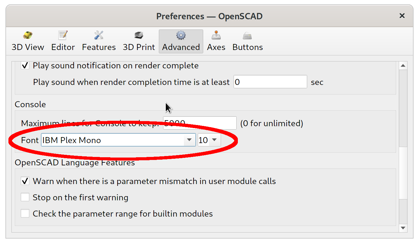

Thanks, I've set the editor to DejaVu Sans Mono and also the windows
command line. How do I set the openscad console font, and it's size?
windows command line. How do I set the openscad console font,
and it's size?
That's available in the Dev-Snapshots only. See screenshot.
