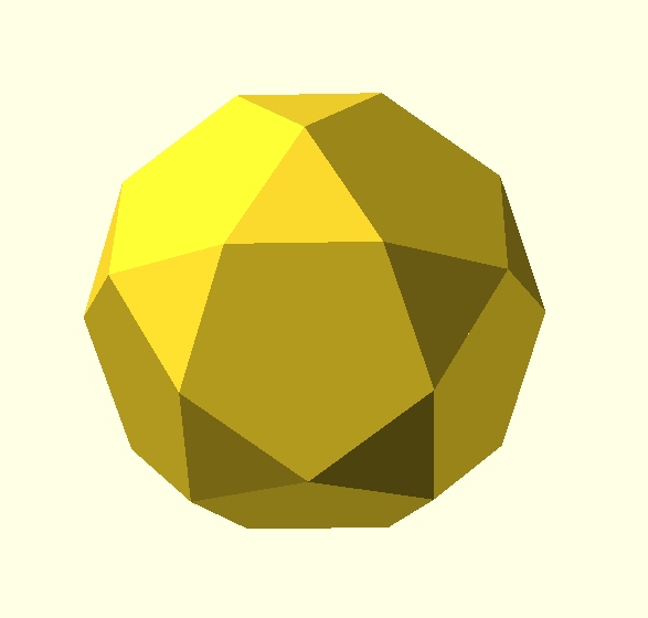

Here's a screen grab of the console errors:-
OK 'til here.
[fast-csg] corefinement mesh union #16: 241376 facets vs. 121076 facets
WARNING: [fast-csg] Corefinement corefinement mesh union #16 failed with
an error: CGAL ERROR: assertion violation!
Expr: nodes.size() == std::set<Point_3>(nodes.begin(), nodes.end()).size()
File:
/mxe/usr/x86_64-w64-mingw32.static.posix/include/CGAL/Polygon_mesh_processing/internal/Corefinement/intersection_nodes.h
Line: 442
WARNING: Dumps of operands were written to corefinement mesh union 16
lhs.off and corefinement mesh union 16 rhs.off
[fast-csg] nef union: 238148 facets vs. 119910 facets
ERROR: CGAL error in CGALUtils::applyUnion3DHybrid: CGAL ERROR:
precondition violation!
Expr: ! _is_valid (_succ2_P) || comp_f (node1_P->object,
_succ2_P->object) != LARGER
File: /mxe/usr/x86_64-w64-mingw32.static.posix/include/CGAL/Multiset.h
Line: 2344
[fast-csg] corefinement mesh union #17: 60924 facets vs. 60924 facets
Geometries in cache: 22
Geometry cache size in bytes: 96506808
CGAL Polyhedrons in cache: 1
CGAL cache size in bytes: 3411816
Total rendering time: 0:01:15.326
Facets: 121848
Bounding box:
Min: -47.42, -48.21, -89.62
Max: 46.38, 48.51, 89.62
Size: 93.80, 96.72, 179.24
Rendering finished.
Basically, its a number of copies of an stl file arranged around a
sphere, with slight overlaps. It fast renders OK. Any ideas?

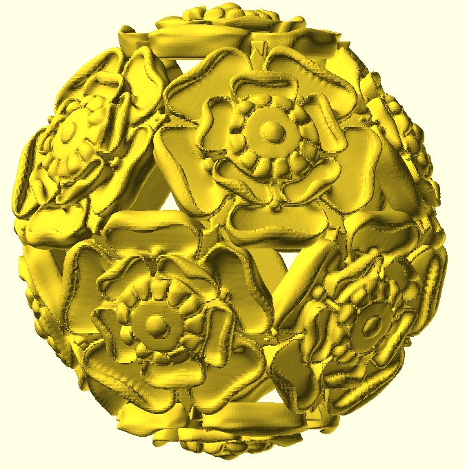

I imported the off files into meshlab, (openai.chat explained how to
merge them), exported as stl, then imported them back into openscad to
join other parts to what I wanted  - with no errors or warnings, - Tudor
roses as the the pentagon faces of an icosidodecahedron.  (stl file,
156,779KB)

Cura got in a tangle with the slicing. I intended printing in vase mode,
but the edges of the petals have to printed before the centres, for the
bottom row, which means that support would be needed. I filled in the 20
triangles, saved as stl, but again problems with Cura. I loaded the stl
into meshmagic, and converted to .obj file. It said the conversion would
take a long time - it was in fact about a whole day, but it converted it
successfully. I'm not sure if I want it to take nine hours printing at
half size, with supports.

Sliced OK in Cura, and printed OK at 40% size (about 70mm od) took
6hours. Tree supports removed fine.
On 17/02/2023 15:12, Raymond West wrote:
On 15/02/2023 15:29, Michael Möller wrote:
... but will it print ?
mode, but the edges of the petals have to printed before the centres,
for the bottom row, which means that support would be needed. I filled
in the 20 triangles, saved as stl, but again problems with Cura. I
loaded the stl into meshmagic, and converted to .obj file. It said the
conversion would take a long time - it was in fact about a whole day,
but it converted it successfully. I'm not sure if I want it to take
nine hours printing at half size, with supports.

Going back to the posts wrt the icosidodecahedron, and my object with
the tudor  roses, (approx. 15th Feb), I generated the object by
positioning the pentagons and triangles and more or less adjusting them
empirically. This gave a good enough result, but a tedious method if
wanting to change the thickness of walls, or sizes, etc.
I found that zooming in on the corners, that they did not necessarily
line up precisely, but good enough for 3d printing.
I've carried out a bit of trig, and attached the file to produce an
icosidodecahedron. You only need change the length of side and wall
thickness. It will print OK in vase mode, or as a thicker walled more
normal print, (difference a cylinder/whatever to put a hole in the top
if you want a container, or otherwise modify the modules) and I've
commented where you can add a pattern to the surfaces. If you make the
wall thickness less than about 0.00001, with a side of 10, then most
likely due to accumulated errors in calculations, it will not f6 render.
Going back to the posts wrt the icosidodecahedron, and my object with the tudor  roses, (approx. 15th Feb), I generated the object by positioning the pentagons and triangles and more or less adjusting them empirically. This gave a good enough result, but a tedious method if wanting to change the thickness of walls, or sizes, etc. I found that zooming in on the corners, that they did not necessarily line up precisely, but good enough for 3d printing. I've carried out a bit of trig, and attached the file to produce an icosidodecahedron. You only need change the length of side and wall thickness. It will print OK in vase mode, or as a thicker walled more normal print, (difference a cylinder/whatever to put a hole in the top if you want a container, or otherwise modify the modules) and I've commented where you can add a pattern to the surfaces. If you make the wall thickness less than about 0.00001, with a side of 10, then most likely due to accumulated errors in calculations, it will not f6 render.
Thu, Mar 2, 2023 9:45 PM
If you're interested in this or more complicated semi-regular solids you
might want to take a look at the polyhedra library in BOSL2,
https://github.com/revarbat/BOSL2/wiki/polyhedra.scad
Example 12 is the icosidodecahedron.  Its vertices are generated using a
one liner that calls some simple functions that apply symmetry operations.
