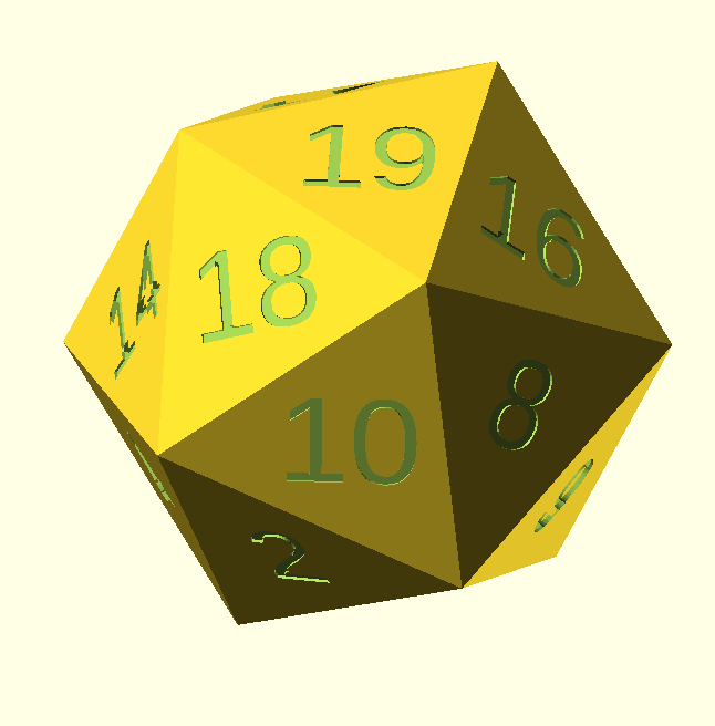

Here is a somewhat easier, albeit slightly less precise, method of creating
your icosahedron. With this, your don't need to worry about faces.
------------------- BEGIN CODE -------------------
module icosahedron ( radius = 1 ) {
foo = atan ( 0.500 ) ;
points = [
sph_to_cart ( sph(  0,  0,      rad = radius ) ) , //  0
sph_to_cart ( sph(  36,  90 - foo, rad = radius ) ) , //  1
sph_to_cart ( sph( 108,  90 - foo, rad = radius ) ) , //  2
sph_to_cart ( sph( 180,  90 - foo, rad = radius ) ) , //  3
sph_to_cart ( sph( 252,  90 - foo, rad = radius ) ) , //  4
sph_to_cart ( sph( 324,  90 - foo, rad = radius ) ) , //  5
sph_to_cart ( sph(  72,  90 + foo, rad = radius ) ) , //  6
sph_to_cart ( sph( 144,  90 + foo, rad = radius ) ) , //  7
sph_to_cart ( sph( 216,  90 + foo, rad = radius ) ) , //  8
sph_to_cart ( sph( 288,  90 + foo, rad = radius ) ) , //  9
sph_to_cart ( sph( 360,  90 + foo, rad = radius ) ) , // 10
sph_to_cart ( sph(  0, 180,      rad = radius ) )  // 11
hull()
for (p=points)
translate(p)
sphere(0.001);
------------------- END CODE -------------------

Here is a somewhat easier, albeit slightly less precise, method of creating your icosahedron. With this, your don't need to worry about faces. # ------------------- BEGIN CODE ------------------- module icosahedron ( radius = 1 ) { foo = atan ( 0.500 ) ; points = [ sph_to_cart ( sph( 0, 0, rad = radius ) ) , // 0 sph_to_cart ( sph( 36, 90 - foo, rad = radius ) ) , // 1 sph_to_cart ( sph( 108, 90 - foo, rad = radius ) ) , // 2 sph_to_cart ( sph( 180, 90 - foo, rad = radius ) ) , // 3 sph_to_cart ( sph( 252, 90 - foo, rad = radius ) ) , // 4 sph_to_cart ( sph( 324, 90 - foo, rad = radius ) ) , // 5 sph_to_cart ( sph( 72, 90 + foo, rad = radius ) ) , // 6 sph_to_cart ( sph( 144, 90 + foo, rad = radius ) ) , // 7 sph_to_cart ( sph( 216, 90 + foo, rad = radius ) ) , // 8 sph_to_cart ( sph( 288, 90 + foo, rad = radius ) ) , // 9 sph_to_cart ( sph( 360, 90 + foo, rad = radius ) ) , // 10 sph_to_cart ( sph( 0, 180, rad = radius ) ) // 11 ]; hull() for (p=points) { translate(p) sphere(0.001); } } # ------------------- END CODE ------------------- On Fri, Sep 24, 2021 at 9:57 PM Dan White via Discuss < discuss@lists.openscad.org> wrote: > > > > ---------- Forwarded message ---------- > From: Dan White <d_e_white@icloud.com> > To: discuss@lists.openscad.org > Cc: > Bcc: > Date: Sat, 25 Sep 2021 00:30:58 -0000 > Subject: [OpenSCAD] WTF ? ERROR: The given mesh is not closed! Unable to > convert to CGAL_Nef_Polyhedron. > Trying something with code from Geodesic Maths for OpenScad - Thingiverse > <https://www.thingiverse.com/thing:10540> > > Preview is fine. > > Trying to render coughs out > > *Rendering Polygon Mesh using CGAL...* > *ERROR: The given mesh is not closed! Unable to convert to > CGAL_Nef_Polyhedron.* > > If I take out the cylinder, no error. > > I even extracted code from maths_geodesic.scad so I might isolate any > problem, but no joy. > OpenSCAD 2021.01 > running on a MacBookPro running Big Sur (macOS 11.6) > # ------------------- BEGIN CODE ------------------- > //include <maths_geodesic.scad> > > //-------------------------------------------- > //WITHOUT <maths_geodesic.scad> > Cepsilon = 0.00000001; > > function sph(long, lat, rad=1) = [long, lat, rad]; > > // Clean: Corrected > function clean(n) = (n < 0) ? ((n < -Cepsilon) ? n : 0) : (n < Cepsilon) ? > 0 : n; > > > // Convert spherical to cartesian > function sph_to_cart(s) = [ > clean(s[2]*sin(s[1])*cos(s[0])), > clean(s[2]*sin(s[1])*sin(s[0])), > clean(s[2]*cos(s[1])) > ]; > //-------------------------------------------- > > > module icosahedron ( radius = 1 ) { > foo = atan ( 0.500 ) ; > > polyhedron( > points = [ > sph_to_cart ( sph( 0, 0, rad = radius ) ) , // 0 > sph_to_cart ( sph( 36, 90 - foo, rad = radius ) ) , // 1 > sph_to_cart ( sph( 108, 90 - foo, rad = radius ) ) , // 2 > sph_to_cart ( sph( 180, 90 - foo, rad = radius ) ) , // 3 > sph_to_cart ( sph( 252, 90 - foo, rad = radius ) ) , // 4 > sph_to_cart ( sph( 324, 90 - foo, rad = radius ) ) , // 5 > sph_to_cart ( sph( 72, 90 + foo, rad = radius ) ) , // 6 > sph_to_cart ( sph( 144, 90 + foo, rad = radius ) ) , // 7 > sph_to_cart ( sph( 216, 90 + foo, rad = radius ) ) , // 8 > sph_to_cart ( sph( 288, 90 + foo, rad = radius ) ) , // 9 > sph_to_cart ( sph( 360, 90 + foo, rad = radius ) ) , // 10 > sph_to_cart ( sph( 0, 180, rad = radius ) ) // 11 > ], > faces = [ > [ 0, 1, 2], > [ 0, 2, 3 ], > [ 0, 3, 4 ], > [ 0, 4, 5 ], > [ 0, 5, 1 ], > [ 1, 6, 10 ], > [ 2, 6, 1 ], > [ 2, 6, 7 ], > [ 2, 3, 7 ], > [ 3, 7, 8 ], > [ 3, 8, 4 ], > [ 4, 8, 9 ], > [ 4, 9, 5 ], > [ 5, 9, 10 ], > [ 5,10, 1 ], > [ 11, 6, 7 ], > [ 11, 7, 8 ], > [ 11, 8, 9 ], > [ 11, 9, 10 ], > [ 11, 10, 6 ] > ], > convexity = 1 > ) ; > } > > icosahedron ( ) ; > cylinder ( h = 0.01, r = 1, $fn = 25 ) ; > # ------------------- END CODE ------------------- > > Dan White | d_e_white@icloud.com > ------------------------------------------------ “Sometimes I think the > surest sign that intelligent life exists elsewhere in the universe is that > none of it has tried to contact us.” (Bill Waterson: Calvin & Hobbes) > > > > > > ---------- Forwarded message ---------- > From: Dan White via Discuss <discuss@lists.openscad.org> > To: discuss@lists.openscad.org > Cc: Dan White <d_e_white@icloud.com> > Bcc: > Date: Sat, 25 Sep 2021 00:30:58 -0000 > Subject: [OpenSCAD] WTF ? ERROR: The given mesh is not closed! Unable to > convert to CGAL_Nef_Polyhedron. > _______________________________________________ > OpenSCAD mailing list > To unsubscribe send an email to discuss-leave@lists.openscad.org >
Sat, Sep 25, 2021 4:31 PM
To hull a set of points, there is a little "trick" that dispenses the small
spheres centred at the points. Just take the hull of a bogus polyhedron
having the points as vertices and an enumeration of the points as the only
face. Surprisingly, this polyhedron is accepted by OpenSCAD.
Here is one minimalist way to define a icosahedron using that trick:
module icosahedron(radius=1) {
// see https://en.wikipedia.org/wiki/Regular_icosahedron
phi  = (1+sqrt(5))/2;
scale = radius/norm([1,phi]);
verts = scale*
[ for(i=[-1,1],j=[-phi,phi]) [0,i,j],
for(i=[-1,1],j=[-phi,phi]) [i,j,0],
for(i=[-1,1],j=[-phi,phi]) [j,0,i]
hull() polyhedron(verts,[[for(i=[0:11]) i]]);
Em sáb., 25 de set. de 2021 às 14:46, Leonard Martin Struttmann <

To hull a set of points, there is a little "trick" that dispenses the small spheres centred at the points. Just take the hull of a bogus polyhedron having the points as vertices and an enumeration of the points as the only face. Surprisingly, this polyhedron is accepted by OpenSCAD. Here is one minimalist way to define a icosahedron using that trick: module icosahedron(radius=1) { // see https://en.wikipedia.org/wiki/Regular_icosahedron phi = (1+sqrt(5))/2; scale = radius/norm([1,phi]); verts = scale* [ for(i=[-1,1],j=[-phi,phi]) [0,i,j], for(i=[-1,1],j=[-phi,phi]) [i,j,0], for(i=[-1,1],j=[-phi,phi]) [j,0,i] ] ; hull() polyhedron(verts,[[for(i=[0:11]) i]]); } Em sáb., 25 de set. de 2021 às 14:46, Leonard Martin Struttmann < lenstruttmann@gmail.com> escreveu: > Here is a somewhat easier, albeit slightly less precise, method of > creating your icosahedron. With this, your don't need to worry about faces. > > # ------------------- BEGIN CODE ------------------- > module icosahedron ( radius = 1 ) { > foo = atan ( 0.500 ) ; > > points = [ > sph_to_cart ( sph( 0, 0, rad = radius ) ) , // 0 > sph_to_cart ( sph( 36, 90 - foo, rad = radius ) ) , // 1 > sph_to_cart ( sph( 108, 90 - foo, rad = radius ) ) , // 2 > sph_to_cart ( sph( 180, 90 - foo, rad = radius ) ) , // 3 > sph_to_cart ( sph( 252, 90 - foo, rad = radius ) ) , // 4 > sph_to_cart ( sph( 324, 90 - foo, rad = radius ) ) , // 5 > sph_to_cart ( sph( 72, 90 + foo, rad = radius ) ) , // 6 > sph_to_cart ( sph( 144, 90 + foo, rad = radius ) ) , // 7 > sph_to_cart ( sph( 216, 90 + foo, rad = radius ) ) , // 8 > sph_to_cart ( sph( 288, 90 + foo, rad = radius ) ) , // 9 > sph_to_cart ( sph( 360, 90 + foo, rad = radius ) ) , // 10 > sph_to_cart ( sph( 0, 180, rad = radius ) ) // 11 > ]; > > hull() > for (p=points) > { > translate(p) > sphere(0.001); > } > } > # ------------------- END CODE ------------------- > > On Fri, Sep 24, 2021 at 9:57 PM Dan White via Discuss < > discuss@lists.openscad.org> wrote: > >> >> >> >> ---------- Forwarded message ---------- >> From: Dan White <d_e_white@icloud.com> >> To: discuss@lists.openscad.org >> Cc: >> Bcc: >> Date: Sat, 25 Sep 2021 00:30:58 -0000 >> Subject: [OpenSCAD] WTF ? ERROR: The given mesh is not closed! Unable to >> convert to CGAL_Nef_Polyhedron. >> Trying something with code from Geodesic Maths for OpenScad - Thingiverse >> <https://www.thingiverse.com/thing:10540> >> >> Preview is fine. >> >> Trying to render coughs out >> >> *Rendering Polygon Mesh using CGAL...* >> *ERROR: The given mesh is not closed! Unable to convert to >> CGAL_Nef_Polyhedron.* >> >> If I take out the cylinder, no error. >> >> I even extracted code from maths_geodesic.scad so I might isolate any >> problem, but no joy. >> OpenSCAD 2021.01 >> running on a MacBookPro running Big Sur (macOS 11.6) >> # ------------------- BEGIN CODE ------------------- >> //include <maths_geodesic.scad> >> >> //-------------------------------------------- >> //WITHOUT <maths_geodesic.scad> >> Cepsilon = 0.00000001; >> >> function sph(long, lat, rad=1) = [long, lat, rad]; >> >> // Clean: Corrected >> function clean(n) = (n < 0) ? ((n < -Cepsilon) ? n : 0) : (n < Cepsilon) >> ? 0 : n; >> >> >> // Convert spherical to cartesian >> function sph_to_cart(s) = [ >> clean(s[2]*sin(s[1])*cos(s[0])), >> clean(s[2]*sin(s[1])*sin(s[0])), >> clean(s[2]*cos(s[1])) >> ]; >> //-------------------------------------------- >> >> >> module icosahedron ( radius = 1 ) { >> foo = atan ( 0.500 ) ; >> >> polyhedron( >> points = [ >> sph_to_cart ( sph( 0, 0, rad = radius ) ) , // 0 >> sph_to_cart ( sph( 36, 90 - foo, rad = radius ) ) , // 1 >> sph_to_cart ( sph( 108, 90 - foo, rad = radius ) ) , // 2 >> sph_to_cart ( sph( 180, 90 - foo, rad = radius ) ) , // 3 >> sph_to_cart ( sph( 252, 90 - foo, rad = radius ) ) , // 4 >> sph_to_cart ( sph( 324, 90 - foo, rad = radius ) ) , // 5 >> sph_to_cart ( sph( 72, 90 + foo, rad = radius ) ) , // 6 >> sph_to_cart ( sph( 144, 90 + foo, rad = radius ) ) , // 7 >> sph_to_cart ( sph( 216, 90 + foo, rad = radius ) ) , // 8 >> sph_to_cart ( sph( 288, 90 + foo, rad = radius ) ) , // 9 >> sph_to_cart ( sph( 360, 90 + foo, rad = radius ) ) , // 10 >> sph_to_cart ( sph( 0, 180, rad = radius ) ) // 11 >> ], >> faces = [ >> [ 0, 1, 2], >> [ 0, 2, 3 ], >> [ 0, 3, 4 ], >> [ 0, 4, 5 ], >> [ 0, 5, 1 ], >> [ 1, 6, 10 ], >> [ 2, 6, 1 ], >> [ 2, 6, 7 ], >> [ 2, 3, 7 ], >> [ 3, 7, 8 ], >> [ 3, 8, 4 ], >> [ 4, 8, 9 ], >> [ 4, 9, 5 ], >> [ 5, 9, 10 ], >> [ 5,10, 1 ], >> [ 11, 6, 7 ], >> [ 11, 7, 8 ], >> [ 11, 8, 9 ], >> [ 11, 9, 10 ], >> [ 11, 10, 6 ] >> ], >> convexity = 1 >> ) ; >> } >> >> icosahedron ( ) ; >> cylinder ( h = 0.01, r = 1, $fn = 25 ) ; >> # ------------------- END CODE ------------------- >> >> Dan White | d_e_white@icloud.com >> ------------------------------------------------ “Sometimes I think the >> surest sign that intelligent life exists elsewhere in the universe is that >> none of it has tried to contact us.” (Bill Waterson: Calvin & Hobbes) >> >> >> >> >> >> ---------- Forwarded message ---------- >> From: Dan White via Discuss <discuss@lists.openscad.org> >> To: discuss@lists.openscad.org >> Cc: Dan White <d_e_white@icloud.com> >> Bcc: >> Date: Sat, 25 Sep 2021 00:30:58 -0000 >> Subject: [OpenSCAD] WTF ? ERROR: The given mesh is not closed! Unable to >> convert to CGAL_Nef_Polyhedron. >> _______________________________________________ >> OpenSCAD mailing list >> To unsubscribe send an email to discuss-leave@lists.openscad.org >> > _______________________________________________ > OpenSCAD mailing list > To unsubscribe send an email to discuss-leave@lists.openscad.org >
Sat, Sep 25, 2021 4:34 PM
Just consider this may change at any time, so use wisely.

A plus to the small spheres is that you can get nice rounded edges if you
make them not quite so small.

As a tangential topic, how would one put numbers on each face, i.e., turn
this into a 20-sided die for Dungeons and Dragons?
It doesn't sound easy.

I would do it like this:
include <BOSL2/polyhedra.scad>
regular_polyhedron("icosahedron", side=35);
regular_polyhedron("icosahedron", side=35,draw=false)
down(.3) linear_extrude(height=1)
text(str($faceindex),halign="center",valign="center");
However, there's a problem that the die won't be evenly weighted, so
it won't be a fair die.
