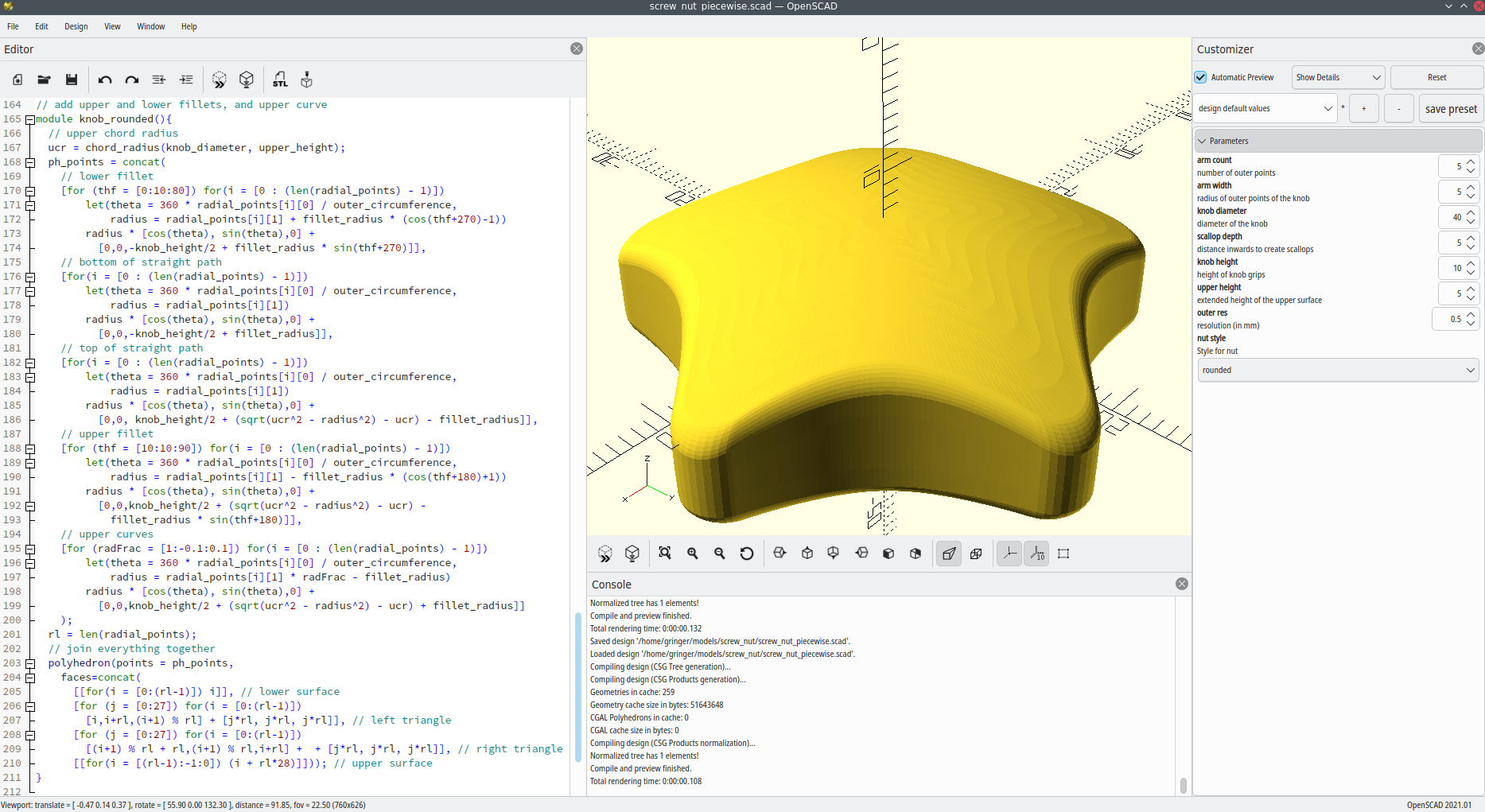

On 6/01/25 10:45, discuss-request@lists.openscad.org wrote:
If anyone has the nerve to look at this, I'd be interested in
suggestions on how the features of OpenSCAD could be better
utilised. I have a very software engineering heavy approach to
tackling these things.
The mathematical challenge of this intrigued me enough that I decided to
have a go at this problem.
I used a chord height calculation to work out the handle and scallop
bits (matching tangents), and also for the upper curve. It's not quite
an exact mesh when combining the upper surface with the fillets, but my
eyeballing of the model suggests that it's not worth it to do the
tangent matching for that as well.
Seems to work with fairly high arm counts, but there's a bit of playing
round needed with the scallop depth and arm width to get it looking right.
See attached. Also uploaded to printables:
https://www.printables.com/model/1136923-rounded-scalloped-handle
Ngā mihi,
David Eccles

Oh, nice. For sure shorter than my approach. Thank you for sharing it.
Maybe on printables you want to link to my model: https://www.printables.com/model/1116311-parametric-knob-for-hex-nuts-and-allen-screws-knau
Is there any idea regarding the manifold problem with the boolean difference?
I uploaded another demo to github: https://github.com/trses/screw-nut-knobs/blob/boolean-glitch/analytical-solution.scad
