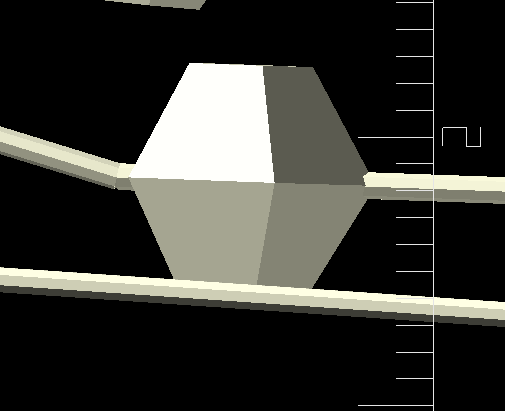

Fri, Mar 3, 2023 9:00 AM
Sphere diameter is 1, so they look like this:
