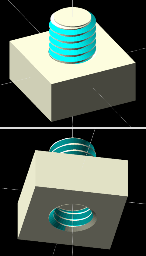

Here is a refined, finalized metric thread library for OpenSCAD. It's minimal/simple, and has no external dependencies e.g. no deps. on BOSL/BOSL2. It's optimized for rendering in F5/preview mode. It consists of approx. 400 lines of code which includes extensive comments (without comments probably 300 lines of code). You would use it like this:
diameter = 3.0;
pitch = 0.5;
fine = 2; // Set to one to use default segment granularity.
segments = metric_thread_segments(diameter) * fine;
length = 4.0;
start = -0.3;
external_metric_thread(diameter, pitch, length, z_start= start,
bottom_lead_in= true, top_lead_in= true,
top_relief= true, fn= segments);
translate([0, 0, start]) {
cylinder(r= metric_thread_minor_radius(diameter, pitch, false),
h= length, center= false, $fn= segments); }
length = 2.8;
start = -1.7;
internal_metric_thread(diameter, pitch, length, z_start= start,
bottom_chamfer= true, top_chamfer= true,
fn= segments);
translate([0, 0, length/2 + start]) {
cube([diameter2, diameter2, length], center= true);
cylinder(r= metric_thread_major_radius(diameter, pitch, true),
h= length * 1.125, center= true, $fn= segments);
The above would produce something that looks like this:
[threads.png]
The thread library resides here, and it consists of a single file: https://sourceforge.net/p/nl10/code/HEAD/tree/scad/common/metric-threads.scad
I have a little Youtube presentation/introduction of this code: https://www.youtube.com/watch?v=3nc-cSm7oQk
The reason why I'm presenting this is because I am gradually migrating over from OpenSCAD to CadQuery and I want to leave behind some of the most useful stuff I wrote. It will be forgotten about unless I introduce it now.
Thanks and good luck. Happy coding.

Nice.  If I already have BOSL2 installed, does your software do
something that BOSL2 does not do?  Or MCAD?  or ThreadLib?

Probably not. I would guess that BOSL can do much more. I offer it here as a very lightweight option, so that lots of dependencies are not needed when wanting to do something simple.

https://www.thingiverse.com/thing:2989174 😉
