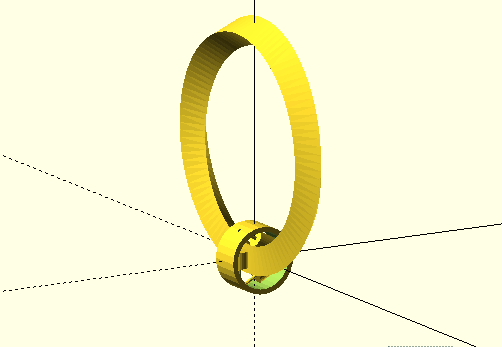

I would prefer to emphasize the unfolding of the Moebius ring.
I would prefer to emphasize the unfolding of the Moebius ring. ​
GF
Greg Frost
Tue, Dec 26, 2017 4:51 AM
I was thinking about that too. Both types of sculpture have merit I think. This should be possible with some sort of planetary gear driving the ring. I also like nophead's idea of a slot in the strip which I am modelling.

Ronaldo's idea would require synchronisation between the drive wheels and the ring holding them. This may require teeth to maintain sync. The benefit of nophead's idea is you could use a friction fit where some slip would not matter.

two drive rings side by side would offer stability and enable friction
drive.

You could put a grove into the sides, than you could get by with only two
rollers.

Nophead's idea of a slot seems to work fine. Now I have to work out how I
want to drive the mechanism.
http://forum.openscad.org/file/t622/Webp.gif

a fine theory (the animation) I'd love to see it working in actuality!

Yes. Getting the alignment right is likely to be non trivial, so although it looks like it might work, there is a big risk that it won't.
So I have started looking at Ronaldo Persiano's idea of rotating the rollers that hold the möbius so that the strip looks like it is unfolding. The rotation will have to precisely relate to the feed rate of the rollers or it won't stay vertical. This is why I thought the möbius will need to have teeth to mesh with the rollers so that things can't get out of sync. Also, it is tricky to mesh the rotation of the rollers with the rotation of the frame that holds them. I have an idea that I think might work, but I'm finding it difficult to model.

Greg,
  • Yes, you are right, proper alignment of a narrow permanent slot is too
    delicate. I'm convinced that it is much easier to include some bending or
    hinge-based mechanics (and electronics) into the moebius that opens the ring
    only during pass-by. It can be triggered e.g. by a hall sensor. Electric
    supply is possible by conductor rails along the mobius faces ().
  • Ronaldos proposal can easily be realized with synchron motors (steppers)
    with geared Moebius faces. The controller and drivers for the inner steppers
    (three at best) will have to travel with the motors. Two conductors allow
    for power supply (also carrying a sync peak).

I'd rather suspect less is more with this sort of implementation
whatever is most simple / elegant is likely to be implementable, as it
is I'm not even sure that nice 3 ring structure would actually work in
reality...
