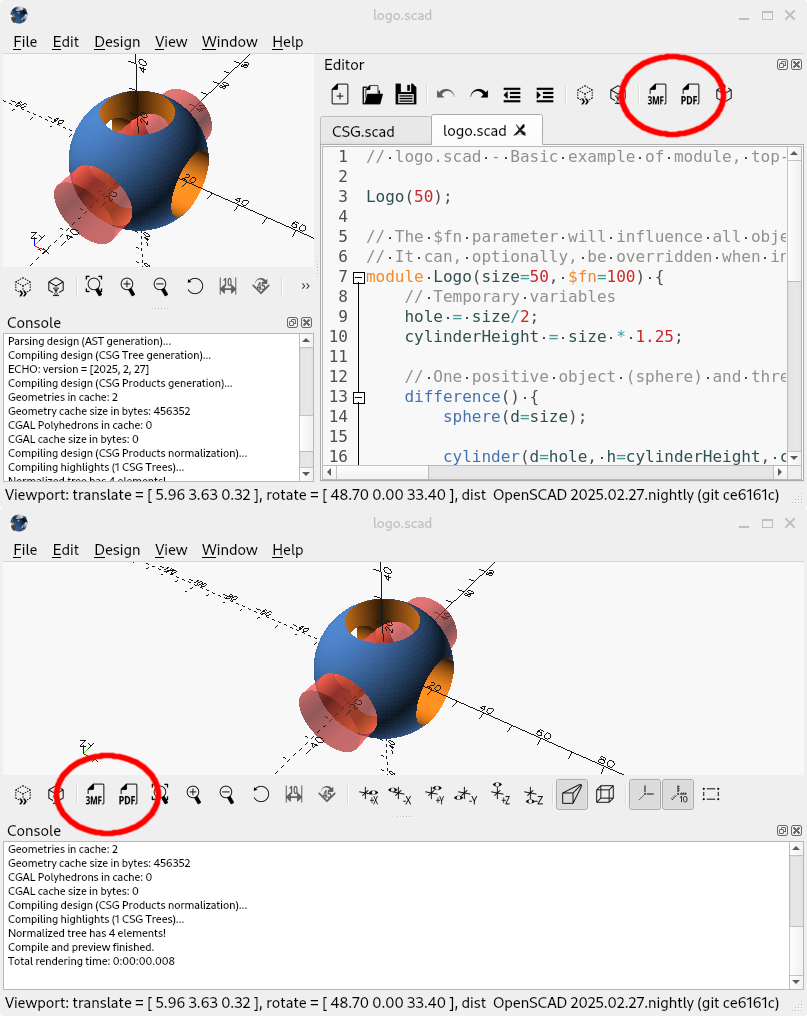

It appears that some time between OpenSCAD-2025.01.16
and OpenSCAD-2025.02.28 the display of the open file tabs moved from under
the menu bar into the Editor pane.
For me, this is an awful, very inconvenient change. I use an external
editor (Visual Code) and keep the OpenSCAD Editor pane reduced to a very
small size. I use it solely to get quick access to the default Export
button.  With this change to the display of the open file tabs, I can only
see maybe two tabs at most.
I understand that this allows more screen space for the display.  However,
for me, this hurts my productivity.
I respectfully request that this change be reverted or, at least, allow it
to be an option.
Should I open a Github issue for this?
Thanks!  Len

On 03.03.25 15:35, Leonard Martin Struttmann via Discuss wrote:
When I close the Editor pane in OpenSCAD-2025.02.28, no tabs are
visible to me.
Yes, https://github.com/openscad/openscad/pull/5609 moved to a
more default standard handling of the tabs.
BUT:
You said it's "to get quick access to the default Export button".
Check the attached screenshot. The export buttons appear in the
other toolbar that is attached to the 3D viewport when the editor
is closed.

Yes, the Export buttons move.
However, with the Editor pane closed, I no longer have access to the open
file tabs. How do you switch to another file without the Editor pane?
Sorry that I am so confused.
Len

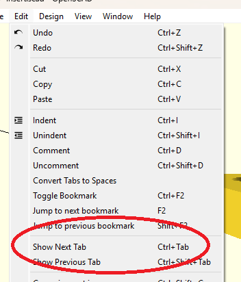

Ctrl-Tab still works.

Oh!  Ok!  I've never used CTRL+Tab before because the tabs were always
there.  :-)
It doesn't seem to be mentioned in the "User Interface" section of the
documentation.
Thanks!  This is good info!
there.  :-)
documentation.
It's shown in the "Edit" menu.  (Though I think the "Window" or "View"
menus might be more appropriate.
