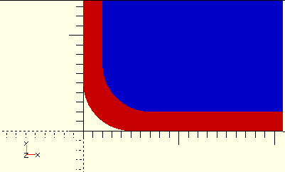

I printed an 'end cover' using offset(). For further (re)learning I've
just coded an alternative using hull(), shown below. Not yet printed but
it looks OK.
CODE
// Designing gutter end cover Mon 28 Oct 2024
$fn=40;
module rounded_cover(x,y,z,r)
hull()
translate([r,r,0])
cylinder(h=z,r=r);
translate([x-r,r,0])
cylinder(h=z,r=r);
translate([x-r,y-r,0])
cylinder(h=z,r=r);
translate([r,y-r,0])
cylinder(h=z,r=r);
// Make two and use Difference
color("red")
rounded_cover(66.5,66.5,15,5);
translate([2,2,2])
color("blue")
rounded_cover(62.5,62.5,20,5);

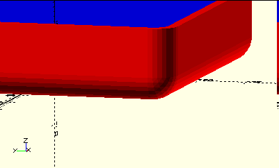

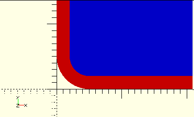

Q1:
Any suggestions for other methods of improvememnts?
Q2:
If I use the disable modifier '%'
%color("red")
I expected to 'see through' the red part, so why do I get this instead?
https://www.dropbox.com/scl/fi/r9g54q9v09t0jthdodfhu/TransparencyQuery.jpg?rlkey=qfi2s8fjiucksa21fou55y5kf&raw=1

It isn't clear whether you didn't indent, or if the indentation was just
lost in e-mail processing.  Always indent; it's critical for readability
in more complex projects.
If you ever start to set $fn globally, stop.  Use $fn only to create
regular polygons.  Instead use $fs and $fa; they will not produce silly
results for small or large circles.  Opinions vary on the exact values
to use, but $fa=3 and $fs=1 is a pretty good starting point.
Parameterizing the values (putting them into variables and calculating
one from another) seems more complex, but can often make things simpler
because you can make the relationships between the numbers more
obvious.  Note that in the example below I specify the outside size and
radius and the desired wall thickness, and calculate the inside
dimensions from that.
Carry around XYZ triples as arrays and refer to their components using
".x" notation; it can be simpler than using separate variables.
Look for commonality that you can wrap "for" loops around.  You're
placing the same cylinder four times, and you're translating x to r and
size-r and similarly y.  That's
for (cylX = [r, x-r], cylY = [r, y-r])
    translate([cylX, cylY,0])
    cylinder(...)
You have the radius on the inside corners the same as the radius on the
outside corners.  The result is that you have the corners a little
thicker than the rest. You want to use a radius that's smaller by the
desired thickness of the wall, changing the "5" in the second call to 3.
Here's my rewrite:
$fa = 3;
$fs = 1;
oSize = [66.5, 66.5, 15];
oRadius = 5;
thickness = 2;
iSize = [ oSize.x - thickness*2, oSize.y - thickness*2, oSize.z ];
iRadius = oRadius - thickness;
module rounded_cover(size,r)
    hull()
        for (x=[r, size.x-r], y=[r, size.y-r])
            translate([x,y,0])
            cylinder(h=size.z,r=r);
    color("red")
        rounded_cover(oSize,oRadius);
    translate([2,2,2])
        color("blue")
        rounded_cover(iSize,iRadius);

On 10/28/2024 10:30 AM, Terry via Discuss wrote: > Q2: > If I use the disable modifier '%' > %color("red") > I expected to 'see through' the red part, so why do I get this instead? > https://www.dropbox.com/scl/fi/r9g54q9v09t0jthdodfhu/TransparencyQuery.jpg?rlkey=qfi2s8fjiucksa21fou55y5kf&raw=1 No idea.  Difference is a bit magic, color is a bit magic, and transparency is very magic, so it's not at all surprising that they interact poorly. > Q3: > Using the mouse wheel to zoom in/out almost never works. Sometimes > nothing, sometimes scrolls the editor, occasionally works if I click > another app and return. But does work consistently if I hide the editor. > Apparently long known bug. Or fixed for some but not me? > https://github.com/openscad/openscad/issues/4361 What platform?  Always works for me on Windows.  Note that the mouse cursor has to be in the correct pane.
Mon, Oct 28, 2024 7:17 PM
color overides the % operator. If you want a transparent colour you need to
pass an alpha parameter to colour.
The % operator also removes the object from the F6 render so you might need
both.

color overides the % operator. If you want a transparent colour you need to pass an alpha parameter to colour. The % operator also removes the object from the F6 render so you might need both. On Mon, 28 Oct 2024 at 19:02, Jordan Brown via Discuss < discuss@lists.openscad.org> wrote: > On 10/28/2024 10:30 AM, Terry via Discuss wrote: > > Q2: > If I use the disable modifier '%' > %color("red") > I expected to 'see through' the red part, so why do I get this instead?https://www.dropbox.com/scl/fi/r9g54q9v09t0jthdodfhu/TransparencyQuery.jpg?rlkey=qfi2s8fjiucksa21fou55y5kf&raw=1 > > > No idea. Difference is a bit magic, color is a bit magic, and > transparency is very magic, so it's not at all surprising that they > interact poorly. > > Q3: > Using the mouse wheel to zoom in/out almost never works. Sometimes > nothing, sometimes scrolls the editor, occasionally works if I click > another app and return. But does work consistently if I hide the editor. > Apparently long known bug. Or fixed for some but not me?https://github.com/openscad/openscad/issues/4361 > > > What platform? Always works for me on Windows. Note that the mouse > cursor has to be in the correct pane. > > _______________________________________________ > OpenSCAD mailing list > To unsubscribe send an email to discuss-leave@lists.openscad.org >
Mon, Oct 28, 2024 7:58 PM

Tue, Oct 29, 2024 3:22 PM
Thanks, that does it.
%color("red", 0.5)
interact poorly.

Thanks, that does it. %color("red", 0.5) ==================== On Mon, 28 Oct 2024 19:17:27 +0000, you wrote: >color overides the % operator. If you want a transparent colour you need to >pass an alpha parameter to colour. > >The % operator also removes the object from the F6 render so you might need >both. > >On Mon, 28 Oct 2024 at 19:02, Jordan Brown via Discuss < >discuss@lists.openscad.org> wrote: > >> On 10/28/2024 10:30 AM, Terry via Discuss wrote: >> >> Q2: >> If I use the disable modifier '%' >> %color("red") >> I expected to 'see through' the red part, so why do I get this instead?https://www.dropbox.com/scl/fi/r9g54q9v09t0jthdodfhu/TransparencyQuery.jpg?rlkey=qfi2s8fjiucksa21fou55y5kf&raw=1 >> >> >> No idea. Difference is a bit magic, color is a bit magic, and >> transparency is very magic, so it's not at all surprising that they >> interact poorly. >> >> Q3: >> Using the mouse wheel to zoom in/out almost never works. Sometimes >> nothing, sometimes scrolls the editor, occasionally works if I click >> another app and return. But does work consistently if I hide the editor. >> Apparently long known bug. Or fixed for some but not me?https://github.com/openscad/openscad/issues/4361 >> >> >> What platform? Always works for me on Windows. Note that the mouse >> cursor has to be in the correct pane. >> >> _______________________________________________ >> OpenSCAD mailing list >> To unsubscribe send an email to discuss-leave@lists.openscad.org >>
