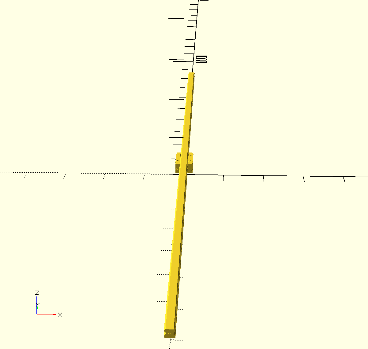

Hey everyone, I am building a model of a plasma table using hiwin linear
rails and bearings.
Hiwin provides CAD files of their stuff, so I grabbed a dxf of the front
profile of the rail I am using and
extruded it in OpenSCAD to my desired length.  This works fine.
I also grabbed an STL of the bearing block (its a more complex shape than
the rail - cant linear extrude), which by itself imports fine.
When I try to render both of these items at the same time, I only see the
rail and get this error in the console:
violation! Expr: pe_prev->is_border() ||
!internal::Plane_constructor::get_plane(pe_prev->facet(),pe_prev->facet()->plane()).is_degenerate()
File:
/opt/mxe/usr/x86_64-w64-mingw32.static/include/CGAL/Nef_3/polyhedron_3_to_nef_3.h
Line: 251
File:
Line: 251
Any suggestions?

Jerry Davis
Sun, Jan 31, 2016 3:06 PM
running osx 2015.12.02 and see more than the rail.
no errors.
is this what I am supposed to see?

lalbers
Sun, Jan 31, 2016 5:10 PM
That is what I expect to see (I hadn't got to the point where I could
position the bearing block on the rail yet but those are the parts)  - When
I get a chance maybe I will try on my girlfriend's mac to see if that makes
a difference.
View this message in context: http://forum.openscad.org/dxf-and-stl-import-rendering-issue-tp15979p15995.html
That is what I expect to see (I hadn't got to the point where I could position the bearing block on the rail yet but those are the parts) - When I get a chance maybe I will try on my girlfriend's mac to see if that makes a difference. -- View this message in context: http://forum.openscad.org/dxf-and-stl-import-rendering-issue-tp15979p15995.html Sent from the OpenSCAD mailing list archive at Nabble.com.
