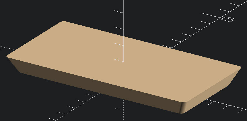

Have this prismoid:
prismoid( size1 = [11,5], size2 = [12,6], h = 1, rounding = .25 );
How do I add a .5 radius rounded bottom?

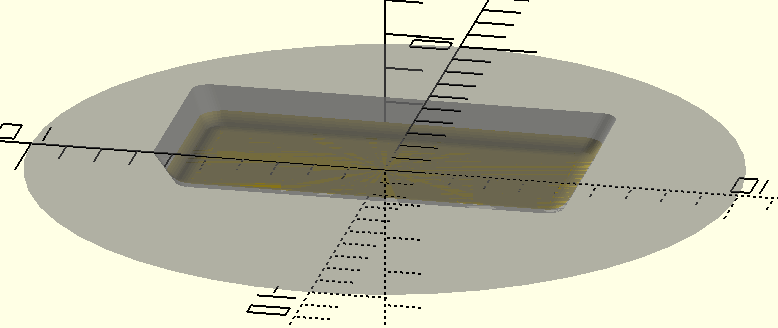

made through python code
made a prism without bottom radius
[image: Screenshot 2023-05-22 at 6.04.45 AM.png]
added plane at the bottom end

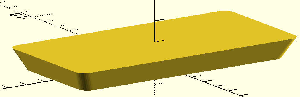

[image: Screenshot 2023-05-22 at 6.06.44 AM.png]
created fillet between the plane and the prism

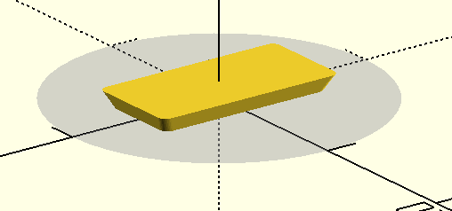

[image: Screenshot 2023-05-22 at 6.09.32 AM.png]
final prismoid by adding fillet with top section
