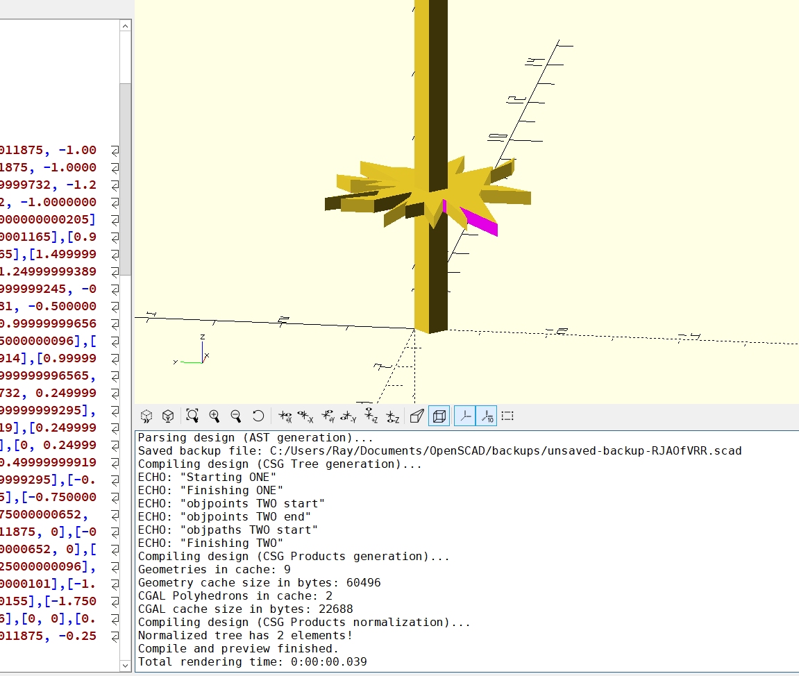

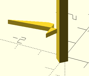

Wed, Nov 10, 2021 1:17 PM
I started commenting out the points in the obj_points1.  It renders ok
until I add the next commented point here:
module two() {
echo("objpoints TWO start");
// small one
obj_points1 =[
[-1.750000003085, -1.500000001215],
[-0.250000011875, -1.000000000205],
[-0.500000009195, -1.250000001165],
[0, -1.000000000205],
[0, -1.750000000355],
[0.24999999732, -1.250000001165]
//  [0.24999999732, -1.750000000355],
Adding the next point makes your polygon path cross itself
Before adding the next point.  This renders:
[image: Screenshot from 2021-11-10 07-15-21.png]
After adding the next point.  This no longer renders:
[image: Screenshot from 2021-11-10 07-09-56.png]
