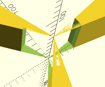

My code snippet
  a = 10;
  for(i=[0,120,240]) linear_extrude(60) rotate(i) polygon(100 * [[0,0],
[cos(a), sin(a)], [cos(a), -sin(a)]]);
  cylinder(r=42, h = 60);
does not do what I want, but adding a union() before the for() command
fixes it:
  a = 10;
  union() for(i=[0,120,240]) linear_extrude(60) rotate(i) polygon(100 *
[[0,0], [cos(a), sin(a)], [cos(a), -sin(a)]]);
As part of the explanation of intersection_for(), the wiki documentation
states "Besides creating separate instances for each pass, the standard
for() also groups all these instances creating an implicit union" but
that clearly isn't so for my example. Is there a way I can predict when
it will happen?
Cheers,
Steve

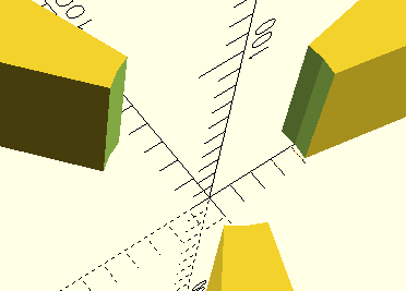

Thu, Mar 6, 2025 5:30 PM
for() normally creates an implicit union.  (As does almost everything.)
Perhaps you have "lazy union" enabled.  Don't do that.  Edit /
Preferences / Features.
  • [[0,0], [cos(a), sin(a)], [cos(a), -sin(a)]]);
Hint:
You might notice preview artifacts at the top and bottom.
These are because the previewer can't decide whether there's anything
left after the difference.  Make the negative object extend at least a
little past the thing you're subtracting it from.  In this case, an easy
scheme is to multiply the height of the negative object by three, and
center it.  That will ensure that it projects on both sides of the
positive object, no matter whether it's aligned with one side, the
other, or the center.
  cylinder(r=42, h = 60*3, center=true);

SL
Steve Lelievre
Thu, Mar 6, 2025 5:33 PM
That fixed it. Thank you.
Steve
On 2025-03-06 9:30 a.m., Jordan Brown wrote: > for() normally creates an implicit union.  (As does almost everything.) > > Perhaps you have "lazy union" enabled.  Don't do that.  Edit / > Preferences / Features. That fixed it. Thank you. Steve
