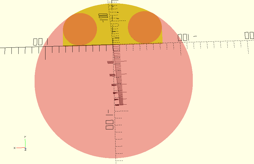

If you can handle it being a bit more regular you could model the inside
with four circle meeting tangentially. It is a bit of maths but I did it
for three to make a replacement glass for an Avo multimeter.
[image: avo_glass.png]
function sqr(x) = x * x;
$fs = 0.25;
$fa = 1;
width = 148;
h1 = 25.4;
h2 = 65;
r1 = 25.4;
h = h2 - h1;
l = width / 2 - r1;
r2 = 0.5 * (sqr(h) - sqr(r1) + sqr(width / 2 - r1)) / (h - r1);
w = l * r2 / (r2 - r1);
echo(r2);
offset = 0 *5.3 / 2;
linear_extrude(height = 3)
offset(-offset)
hull() {
translate([-width / 2, -offset])
square([width, 1]);
for(side = [-1, 1])
    translate([side * l, h1])
        #circle(r1);
    translate([0, h2 - r2, 1])
        #circle(r2);
    translate([-w, 0])
        square([2 * w, h2]);
Then you would use offset to make the outside edge and take the difference.
Then linear extrude it and round with minkowski.
You could also model it with Bezier splines for a more organic shape.

Ken,
Most of my OpenSCAD use is developing equipment for disabilities.
Here is my take on it - if you use the Offset command in OpenSCAD, you can
have rounded shapes with concavity that you can't get with hull(), and the
results are a little more intuitive than spline, without having to draw it
in inkscape first (although I use Inkscape+OpenSCAD often).  Here is a rough
example:
height    = 20; // Height of part
thickness = 5;  // Wall Thickness
rounding  = 2;  // Diameter of rounding Circle
$fn          =20;  // Circle Smoothness
// The three data for each circle - center.x, center.y, diameter
circles = [
[-20, -0, 30],
[-10, 5, 30],
[0, 10, 30],
[15, 5, 25],
[30, 0, 20]
module profile()
x = 15;
offset (r=-x) offset (r=+x)
for (i=circles)
    translate ([i.x, i.y, 0]) circle (d=i.z);
module shape()
minkowski()
// Create the profile + thickness
// Subtract from it the profile
// Extrude shape, then round
    linear_extrude (height)
            offset (r=thickness) profile();
            profile();
    sphere (r=rounding, $fn=15);
// Mounting Bracket Goes Here
translate ([-10, 28, 0]) cube ([20, 10, height]);
// Create 3D Part
shape();
http://forum.openscad.org/file/t486/OpenSCAD_Example_-_Pen_Holder.png
