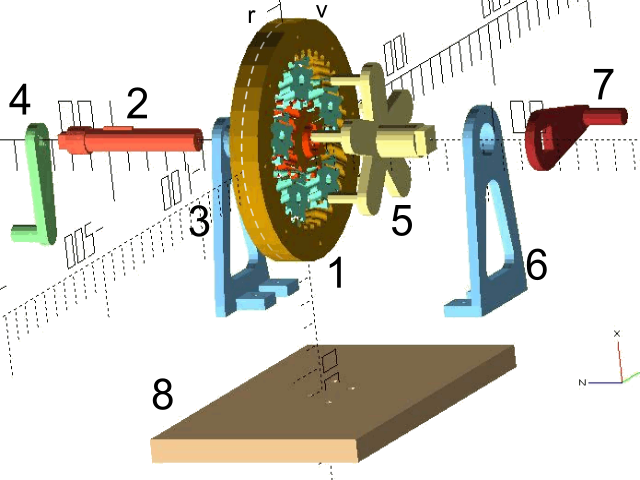

1°) -  the epicyclic train :
After the theorical study under *FreeCAD *with animation, a small crank's
machine was produced in 3D printing. The illustration below details all its
components.
[image: eclate.png]
http://jeanpierre.rousset.free.fr/Automobile/Technique/Train_epicycloidal/Documentation/index.html
This marvelous gear is very old since James Watt used it in the 1780s. For
me it has always been the ideal gear that can replace at good profit
gearboxes and clutches in cars.

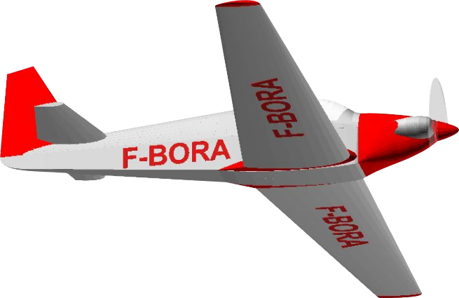

2°) -  the model of the motor-glider Fournier RF4 D
    This single engine, single seat airplane was my favorite aircraft on which
    I flown the grea tmajority of my flying hours in paralel with gliding. So I
    simply tried to make the model in order to 3D print it when the time will
    come.
[image: F-BORA.png]
http://jeanpierre.rousset.free.fr/Informatique/Applications/OpenSCAD_OpenJSCAD/Fournier_RF4/presentation.html
This project interested me because it required the development of profiles
for which I favored the Bézier curves not foreseen by OpenSCAD,
treatment that I had difficulties to find on the forum.
Due to the somewhat limited language of OpenSCAD, I didn't want to process
Bézier surfaces. I made a simplified approach to generating volumes with
the tools of the software.

I have just scratched your airplane code. And I have a few comments about
the evaluation conclusions about OpenSCAD in your referred site. As I
barely read french, I based my comments on a Google translation of them to
english.
First of all, hull() is not a linear interpolation of two shapes. It is the
minimal convex shape that includes all the shapes. The technical name of
that operation is convex hull https://en.wikipedia.org/wiki/Convex_hull.
That means that hull() is unable to produce holed shapes because its result
is always convex. There is no primitive operation in OpenSCAD that provides
Second, functions may be much more complex than a simple algebraic
expression as you suggest. Thanks to list comprehension and conditional
expressions, you can code iterations, recursions, tests and
pre-calculations inside a function. Here is a simple example that uses your
formule_Bezier() function:
// evaluates the points in a Bezier curve for a given list of parameter
values.
// if t is a list of numbers returns a list of points
// if t is a number returns a point
// ctl_pts should be a path, that is a list of pts with the same dimension
function Bezier_curve_sample(ctl_pts, t) =
is_num(t)
? formule_Bezier(t, ctl_pts)
: [for(ti=t)  formule_Bezier (ti, ctl_pts)] ;
To get a display of the curve we may use a module similar to your Bezier()
module:
// draws a polygonal through pts
module line(pts,width) {
for(i=[0:len(pts)-2])
  hull() {
    translate(pts[i])   sphere(width);
    translate(pts[i+1]) sphere(width);
// 2D curve example
pts = [ [0,0], [10,5], [20,-2], 30,20]];
curve = Bezier_curve_sample(pts, [for(i=[0:20]) i/20]);
polygon( curve );
color("red") line( curve, .3);
echo( curve = curve );
Note that above I don't call formule_Bezier() at each individual coordinate
as you do because OpenSCAD is not a typed language and the expression
inside is valid for both numerical control values and vector control
points. It is valid even for matricial control points, that is lists of
vector control points and suitable to sample Bezier Patches!
Finally, you mention the miss of a C-like break in OpenSCAD language. There
are many ways to deal with the need of premature interruptions in a
sequence of computations in OpenSCAD. Breaks are unavoidable in recursion,
an invaluable language tool. Here is an example:
// computes the list of Fibonacci numbers up to a limiting value greater
than 0
function Fibonacci(limit, _result) =
is_undef(_result)
? Fibonacci(limit,[0,1])
: let( n = len(_result) )
_result[n-1]+_result[n-2] > limit
? _result
: Fibonacci(limit, concat(_result, _result[n-1]+_result[n-2] ) );
Besides recursion, you have C-like for as a tool that can interrupt
iterations. A break() clause is not the only way to interrupt iterations.
