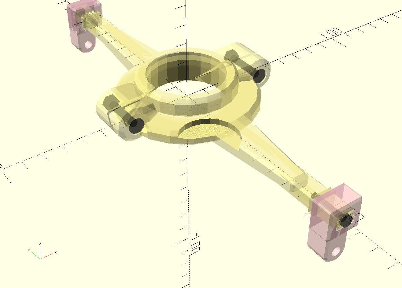

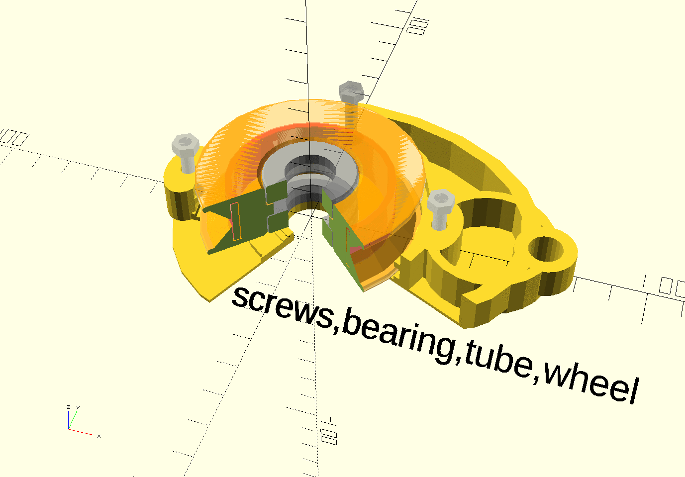

Hello,
the Constructive Library (about 1900 lines of Code) i just have released
https://github.com/solidboredom/constructive,
takes a different approach to OpenScad Syntax: you rarely need
difference(), for(), intersection() or their one-to-one equivalents, a
for() block  In the library's own dialect might look like:
pieces(4)  X(every(35)) turnXY(vals(10,25,-15,40))  cube(10);
It is all valid OpenScad, you do need any additional programs, just the
OpenScad and the constructive-compiled.scad file.
The Constuctive-Syntax tries to align more with mechanical construction
of parts and less with mathematical concepts like arrays, vectors and
functions. (but they are heavily used behind the scenes). So it aims to
be more concise and fluent for mechanical parts than vanilla OpenScad.
It allows you to make holes from Modules and really good deal more.
For about 5 years now i have been working on it and using it a lot. Now
I really hope others will find it just as useful, as i do. I am barely
writing any vanilla OpenScad any more.
If somebody likes the Ideas, you are welcome to join work on it. It is
released under GPL2, and I appreciate
additions/discussions/collaboration. Perhaps, some Ideas can be used by
the OpenScad itself.
There is barely any documentation yet. I will add it topic-wise, when
any questions arise if there will be interest at all.
For a basic introduction to its syntax and some possibilities, look at
the explanations inside the example below, or ask me directly. Here is
an example with approx 100 lines of actual code (see also an animated
.GIF in the Attachment):
https://github.com/solidboredom/constructive/blob/main/examples/mount-demo.scad
there is also another Example at:
https://github.com/solidboredom/constructive/blob/main/examples/pulley-demo.scad
There are many more features useful for complex models, like its own
minimalistic type-subsystem,
basic inheritance of construction parts (still needs improvement), or
inverse transformations like in :
g(X(10),Y(15),turnXY(45),X(30))
    g(backwards([X(10),Y(15),turnXY(45),X(30)])
        box(10);
Try it! i hope you will find it as useful as i do.
Peter

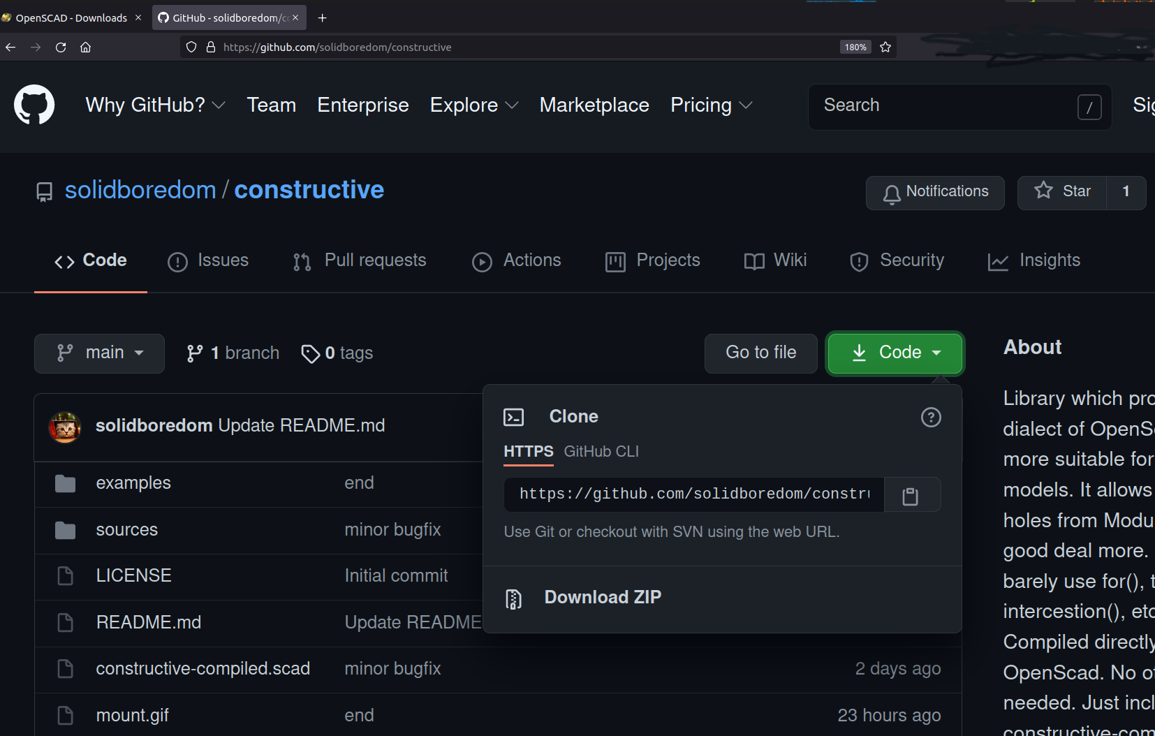

Mon, Jun 7, 2021 10:55 AM
Is it a bug in Openscad?
I have tried it now with 2021.01 (git 41f58fe) (Appimage build) and it
works without any warnings on my UBUNTU 20.04.
what OS are you on?
The only other thing which comes to my mind: could it be a possible
character encoding issue when using Windows vs Linux?
 IMHO this could occur if one downloads library files from Github
individually or by copy pasting, instead of downloading them all at once
as a zip.
I have attached a screenshot of how to do download as zip from Github.
You will probably not need it, but i find Github pages very confusing
personally, so perhaps it will help somebody anyway.
could you send me the errors/warnings output you get?
and if possible try with a different, but recent openscad version from
https://openscad.org/downloads.html
they only have a fairly recent ones on the download page, so i would
expect them all to work
this would help me a lot a lot to locate the cause.
Peter
at the explanations inside the example below, or ask me directly.
Here is an example with approx 100 lines of actual code  (see also an
animated .GIF in the Attachment):
        box(10);

I'm using OpenSCAD version 2021.01 (git 41f58fe) on Ubuntu 20.04.
Here is the complete log from when I attempt pulley-demo.scad:
OpenSCAD 2021.01
https://www.openscad.org/
Copyright (C) 2009-2021 The OpenSCAD Developers
This program is free software; you can redistribute it and/or modify it
under the terms of the GNU General Public License as published by the Free
Software Foundation; either version 2 of the License, or (at your option)
any later version.
Loaded design
'/home/len/Downloads/constructive-main/examples/pulley-demo.scad'.
ECHO: "Assembling: ", ["screws", "bearing", "tube", "wheel"]
WARNING: cylinder(h=0, ...) in file constructive-compiled.scad, line 1915
TRACE: called by 'cylinder' in file constructive-compiled.scad, line 1915
TRACE: called by 'children' in file constructive-compiled.scad, line 690
TRACE: called by 'children' in file constructive-compiled.scad, line 763
TRACE: called by 'multmatrix' in file constructive-compiled.scad, line 760
TRACE: called by 'g' in file constructive-compiled.scad, line 690
TRACE: called by 'up' in file constructive-compiled.scad, line 1913
TRACE: called by 'difference' in file constructive-compiled.scad, line 1863
TRACE: called by 'if' in file constructive-compiled.scad, line 1861
TRACE: called by 'scale' in file constructive-compiled.scad, line 1847
TRACE: called by 'translate' in file constructive-compiled.scad, line 1845
TRACE: called by 'tubeFast' in file constructive-compiled.scad, line 2514
I'm using OpenSCAD version 2021.01 (git 41f58fe) on Ubuntu 20.04. Here is the complete log from when I attempt pulley-demo.scad: OpenSCAD 2021.01 https://www.openscad.org/ Copyright (C) 2009-2021 The OpenSCAD Developers This program is free software; you can redistribute it and/or modify it under the terms of the GNU General Public License as published by the Free Software Foundation; either version 2 of the License, or (at your option) any later version. Loaded design '/home/len/Downloads/constructive-main/examples/pulley-demo.scad'. Compiling design (CSG Tree generation)... ECHO: "Assembling: ", ["screws", "bearing", "tube", "wheel"] WARNING: cylinder(h=0, ...) in file constructive-compiled.scad, line 1915 TRACE: called by 'cylinder' in file constructive-compiled.scad, line 1915 TRACE: called by 'children' in file constructive-compiled.scad, line 690 TRACE: called by 'children' in file constructive-compiled.scad, line 763 TRACE: called by 'multmatrix' in file constructive-compiled.scad, line 760 TRACE: called by 'g' in file constructive-compiled.scad, line 690 TRACE: called by 'up' in file constructive-compiled.scad, line 1913 TRACE: called by 'difference' in file constructive-compiled.scad, line 1863 TRACE: called by 'if' in file constructive-compiled.scad, line 1861 TRACE: called by 'scale' in file constructive-compiled.scad, line 1847 TRACE: called by 'translate' in file constructive-compiled.scad, line 1845 TRACE: called by 'tubeFast' in file constructive-compiled.scad, line 2514 TRACE: called by 'children' in file constructive-compiled.scad, line 763 Compiling design (CSG Products generation)... -- Sent from: http://forum.openscad.org/
LenStruttmann
Mon, Jun 7, 2021 4:12 PM
Found it:
In Preferences -> Advanced -> OpenSCAD Language Features
...I had both of these checked.
http://forum.openscad.org/file/t3150/Screenshot_from_2021-06-07_11-09-55.png
Since you routinely pass h=0 to cylinder(), my OpenSCAD complained loudly.
