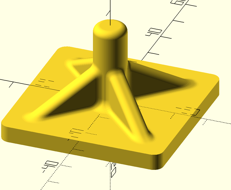

Sat, Aug 24, 2024 6:36 PM
code is below:
first need to import the library openscad1.py to create objects
https://github.com/sprabhakar2006/openSCAD/blob/main/openscad1.py
also need to download library dependencies2.scad
https://github.com/sprabhakar2006/openSCAD/blob/main/dependencies2.scad

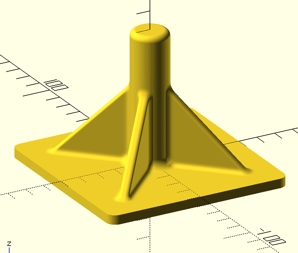

[image: Screenshot 2024-08-25 at 12.05.55 AM.png]
On Sat, 24 Aug 2024 at 21:08, Roel Vanhout roel.vanhout@gmail.com wrote:
This is amazing, would you mind sharing the code that created this? I
write Python every day and I'm much more comfortable with it than with
straight OpenSCAD, but I always thought that using Python to generate
OpenSCAD code was mostly syntactic sugar like having 'real' for loops with
updating variables and such, I didn't know (and still don't quite see how
tbh) that it also allowed for such complex shapes.

On Sat, Aug 24, 2024 at 5:49 AM Sanjeev Prabhakar <
I gave it a try
[image: Screenshot 2024-08-24 at 9.16.07 AM.png]

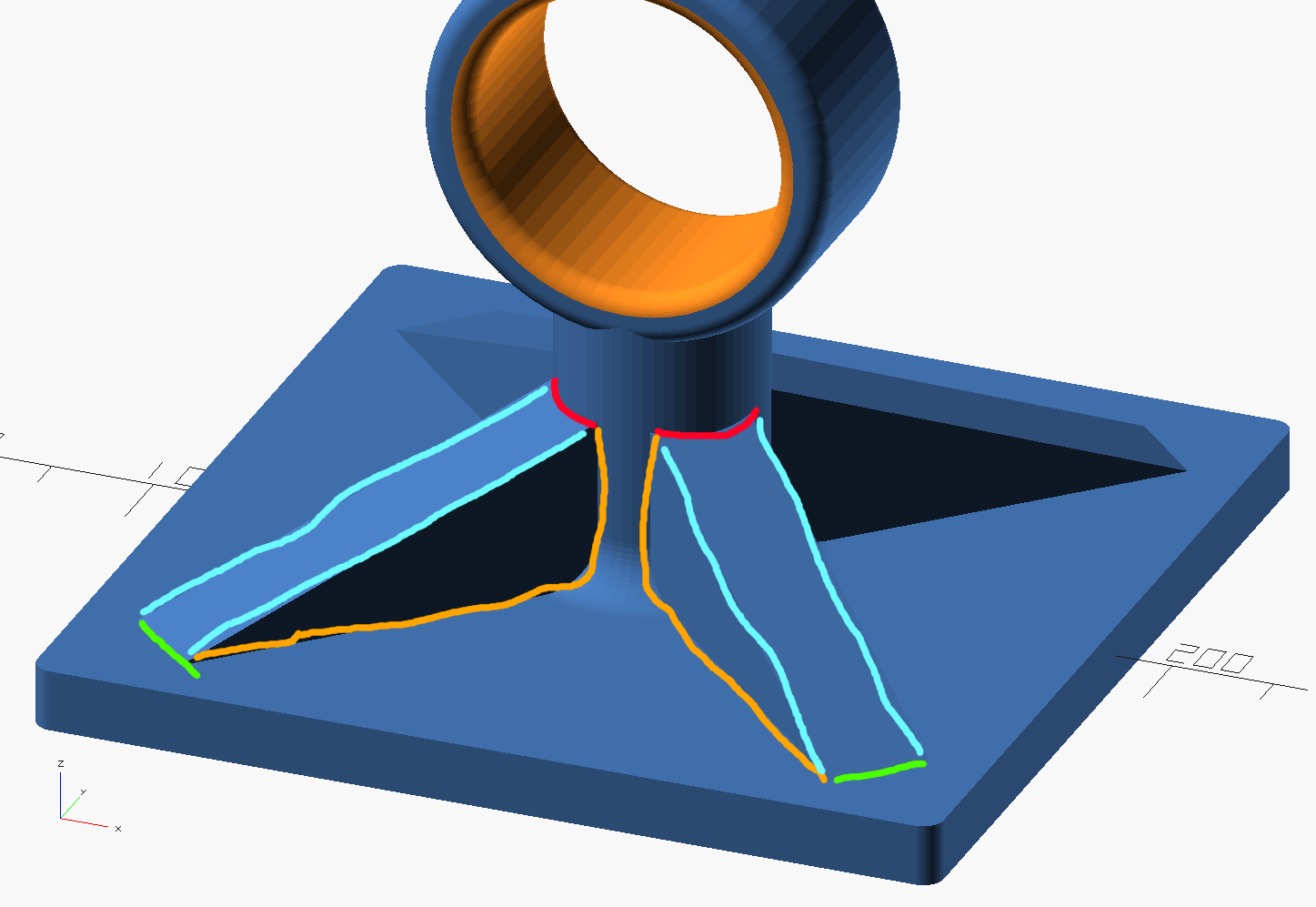

Hello all,
I have a complex shape to round for which I'd like to ask if anyone has
suggestions on how to approach this. I've always found rounding and
chamfering to be very tedious using plain OpenSCAD until I found how to do
it with BOSL2, which has been a godsend for the cases I've encountered so
far. But today I have the shape in the picture below, for which the code is
at the bottom. I'm looking to round out all surfaces of the 'fins' that
radiate out from the center 'stem' come in contact with other surfaces.
(this is a presser tool for stuffing food into a mold, the 'fins' are to
distribute the pressure that is manually exerted on the ring to the bottom
platelet).
I've marked the various lines that need to be rounded out in different
colors. Out of these, the turquoise one I could do with a BOSL2
rounding_edge_mask(), and the green one too if I use an appropriate 'ang'
parameter (which I can calculate fairly easily). However I have no idea how
to do the red one or the orange one, nor how to let e.g. the orange one
blend smoothly into the green one for example; and the same for all the
other places where roundovers meet.
Any ideas on how I can do this? Thank you.
regards
Roel
[image: presser_foot_rounding.png]

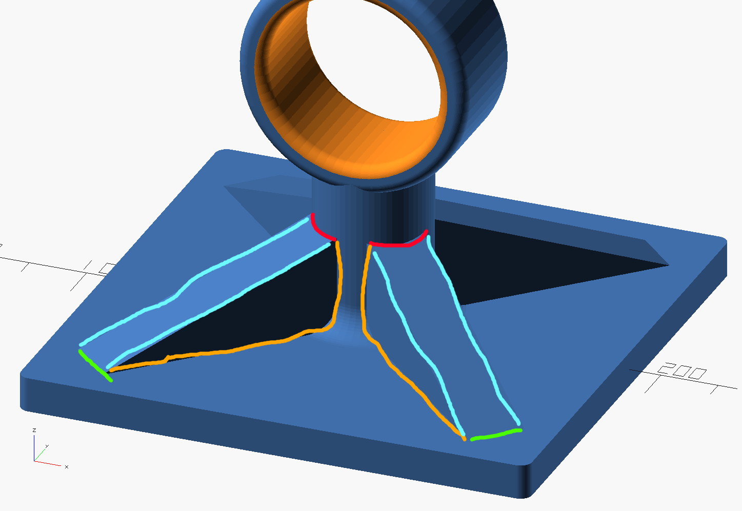

Hello all,
platelet).
regards
Roel
